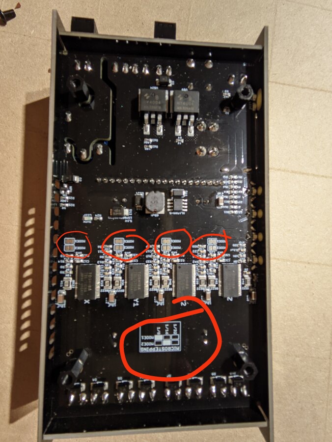

    It does not sit well on me that you dismissed the microstepping jumper question, just because you assumed something. I do not intend to change the microstepping config, nor I think my current issue is related to it. But as an owner of your product I want to understand, and or, be capable of configuring it as I see fit, within the capabilities/specifications of the product of course.
    I have attached a pic of my unit where, as per the images in the documentation, the jumpers should be. Is it that they are on the opposite side of the board? If it's so, why the diagram of the jumpers' position is there, where there are no jumpers?

    The solder jumpers are visible in your photo
    Learn more here How to Work with Jumper Pads and PCB Traces - learn.sparkfun.com
    Note we still don't recommend you change it. Increased microstepping lowers torque.
    That's why is was curious
    Do try acceleration / max rate and also fresh (use new wire) - direct (bypass the GX16s) wiring

    No intention to change it, even less now that I learned that the board has that kind of jumpers. I expected typical jumpers, those that can be changed by hand.
