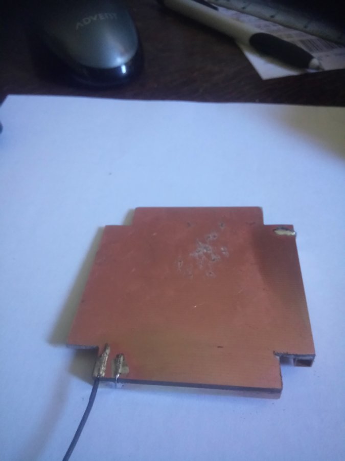

Project Quick and Easy XYZ Probe 2019-05-12
XYZ probe from PCB material

    Alex Chambers submitted a new resource:
    Quick and Easy XYZ Probe - XYZ probe from PCB material

    After several hours playing with this it occurred to me that there was an even quicker and easier way - instead of soldering brass tube UNDER the pcb solder brass ANGLE to the top surface - will post a pic when I find some angle and make a new one.

    Pictures of the new probe now uploaded.
