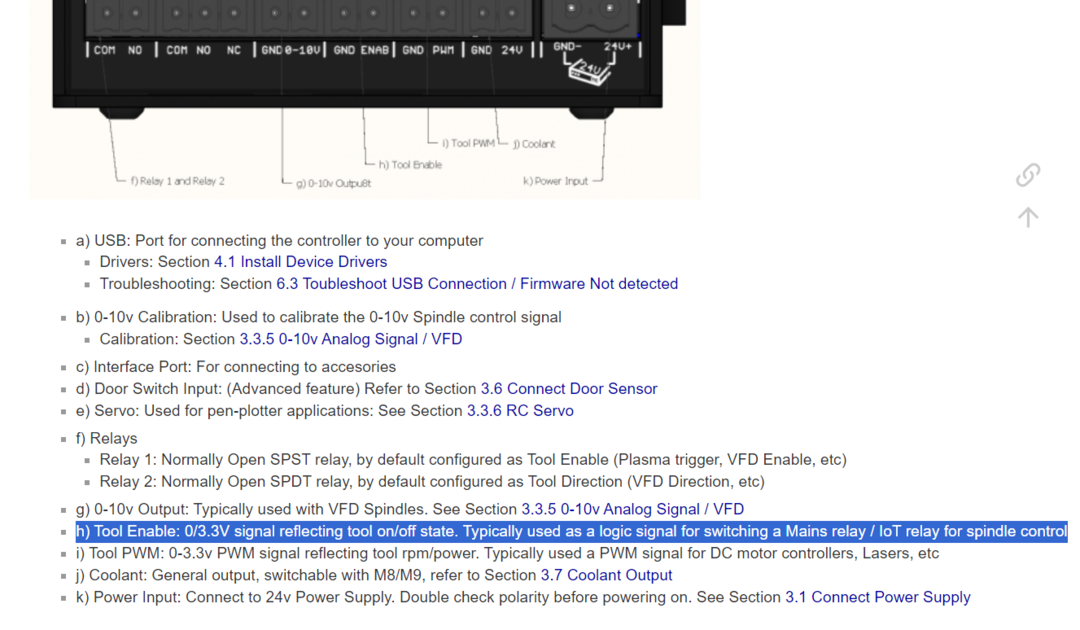

    Hi
    Bought new relay (foxalien smart relay 110/240v)
    relay is rated DC5-80v
    connect it to [tool] but router doesn’t work
    Checked volt when tool on 3.145 on tool
    outlet
    The router working if i use coolant outlet no problem
    I see another outlet (0-10v)
    Can i use it for the router by turn on/of tool command?

    From the X32 documents, Tool is 3.3V. So a 3V relay may be needed.

    Line G : 0-10v output for vfd
    Want to know if i can use it or just keep router on coolant output
    Builder Resident Builder
    15,699
    4,510
    Thats an analog signal for VFDs. It won't play nicely with a relay no.

    Thank you , just use coolant output no problem
