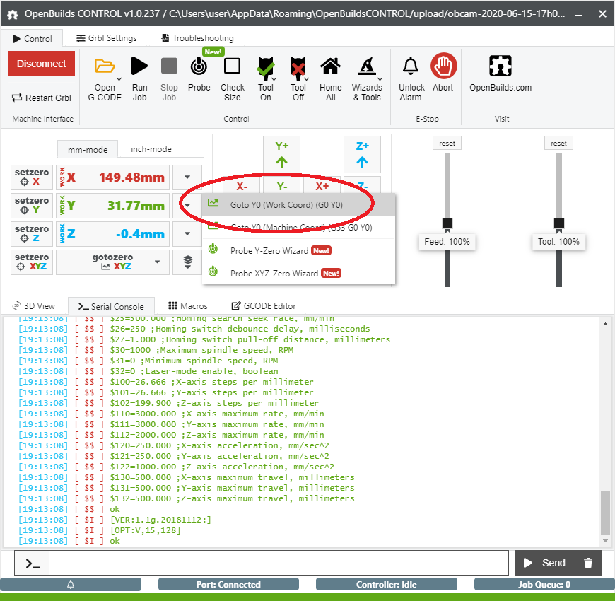

    You can selectively go to zero from the arrow dropdowns next to each DRO: (do whcihever axis you want first..., then the second, then the last)
    If you want an even more different behaviour, the Macro buttons is yours to customize to your hearts content.
