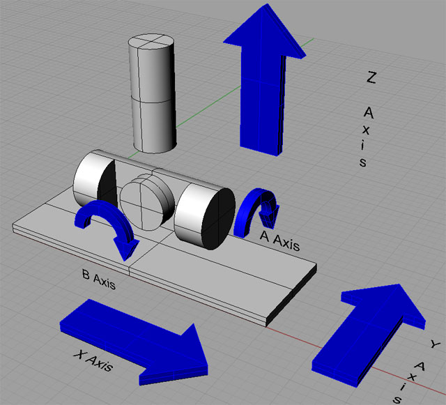

    Facing the machine from the front (you will be looking at the PULLY side of the lathe)...
    In the CONTROL software, clicking on the A+ button, the PULLY rotates counter clockwise. Is this the correct direction? It seems like the lathe is moving in a negative (counter clockwise) direction. Although, facing the lathe from the CHUCK side, it is moving positively.

    Thanks Peter for your reply.... But, as most of the references, discussions and builds that I have found and read, they most often fall in the category of "replacing/swapping an axis (X or Y) for the rotary and essentially still treating it as a 3 axis machine" or "the rotary axis is aligned parrallel to the X axis". I chose to align my rotary axis parrallel to the Y axis to gain alot more room. Both in the circumfrence and length of the wood stock.
    With that said, if the center section of the picture (the one you sent above) depicting the lathe was rotated 90 degrees counter clockwise (parrallel with the Y axis), it appears that the A axis is turning the correct way (positive) counter clockwise. Would you agree?

    I was just reading the cookbook you sent and it says:
    The first 3 Axes are the familiar X axis, Y axis, and Z axis. The A axis and B axis are potential 4th Axes. We refer to the A axis and B axis as "rotary axis". If the machine has both A axis and B axis and they are independent, it is a 5 Axis CNC Machine.
    In other words, you can choose to install your 4th Axis as either Axis A or Axis B. The convention is that A has a rotary axis that spins about the machine's X axis and B spins about the machine's Y axis. In practice, since the 4th Axis is usually removable, most of the time you'll refer to it as the A-Axis whether it is aligned with respect to X or Y. Aligning to X or Y is just a decision you'll make based on the job you're doing.
    Let's assume you choose to set your 4th Axis up as "A". Then you can simply refer to it as such in G-Code. So, for example, you can rotate to the 0 position via "A0".
    I did get the DeskProto CAM software and when setting up the preferences, I did have to select an additional setting to make the rotational axis parrallel with Y. So looking at the movement picture you sent again, B rotation would be parrallel to Y. But even so, the rotation of the PULLY is the same as A, which is still rotating counter clockwise.

    Along X is the more standard (most CAMs will output X+A (and Z) moves for lathe type toolpaths). Our fusion Post is proper 4-axes (XYZA), David will know if that can be used turned to be parallel to Y? @David the swarfer
    Deskproto allowing A to be along Y is nice yes, we like Deskproto too.
    As for which spin direction is correct - if in doubt cut a job: if it looks mirrored, reverse the A axis motor direction and try again

    Nope, A parallel to X only at this time.
    One issue we have is 'how to configure the Blackbox for a B axis'. once we can do that we can extend the post to use B instead of A, since Fusion360 will not fake it in any way I can see. it wants real geometry configurations, so A must be paralle to X and B must be parallel to Y other wise the internal geometry will not drive the post correctly.
