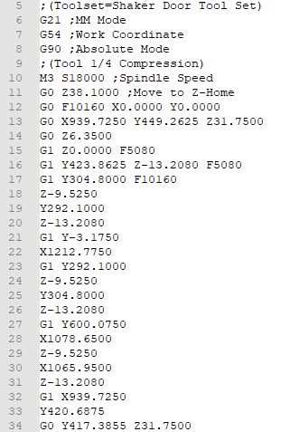

  15. Arthur pells
    Mar 24, 2022
    64
  16. Arthur pells
    Mar 24, 2022
    64
  17. Arthur pells
    Mar 24, 2022
    64
    I think the problem must be with Mosaik because I have been able to control the speed in the feed with the provided software Mosaik has a ticket open and is looking at the issue as well
  18. Arthur pells
    Mar 24, 2022
    64
    I think the problem, maybe with Mosaic because I can control the speed with the provided software that came with the machine. Mosaic has a ticket open and is looking into the problem.
  19. David the swarfer
    3,604
    1,978
    I see and 'M3 S18000' line which is commanding 18000rpm
    however, this won't work unless your GRBL settings are correct for your spindle.
    look at $31 and $30 in the GRBL setttings, the defaults are 0 and 1000 but for your code to work the max setting must be the max for your spindle.
  20. Rob Taylor
    Rob Taylor Master
    Dec 15, 2013
    1,470
    755
    Yeah this trips a lot of people up.
    I don't really understand why it's trying to set a feed rate for a G0 in line 12 since G0 rapids are set to the maximum acceleration/speed of the machine hardware (controllable in grbl's parameters), but it does set a 5080mm/min feed rate under the first G1 feed block on line 15.
    Then it ramps down in Y, then comes back the way it came really fast, plunges down 3/8", comes back the way it came in Y some more, etc... Then cuts full depth around two more sides of the rectangle. This is a very odd, inefficient strategy to me, maybe someone who deals more in wood panel cutouts will understand it better. Personally I'd set it to ramp down 2mm around each full cutout (so 0.5mm per side) and keep the feedrate up there around 5000mm/min or as high as the machine can go (I'm not convinced that's 10160mm/min though...?). You could actually hand-write that code once you know the outside corners where the tool head needs to be in order to get the correct internal workpiece size.

  24. Arthur pells
    Mar 24, 2022
    64
    Oh my that is way above my skill set. I am very new and do not understand much of anything right now I’m waiting on the Mosaic support team to see if the problem is on their end because I did program the feed rate at 100 in./min. and a cut depth of 1/8 And when I place the work piece on the table with out a bit installed it cuts half inch deep and it runs at 130 in./min.
  25. Rob Taylor
    Rob Taylor Master
    Dec 15, 2013
    1,470
    755
    Seems like it because 5080/25.4 = 200IPM (maybe grbl's settings are maxing out at 130IPM/3300mm/min there, which is good to protect the machine) and those Z-13mm blocks that you see are the half-inch DoC.
    One of the most important things you can do when getting into CNC is learn G-code- how to read it, how to write it (for very basic things). For example, in your case the outside dimensions of the actual cutter path appear to be X1212.775mm, which is 47-3/4" *including* the cutter diameter, and Y1166.775mm, which is 45-15/16" including the cutter diameter. So we could write that as a square ramp-down starting at the G54 origin like this:
    G21 G54 G90
    G0 Z38.1 (Safe Z-height)
    G0 X0Y0 (Go to G54 origin)
    M3 S1000 (Max spindle speed at grbl default, doesn't matter for your manual router)
    G0 Z1 (Drop to just above the workpiece)
    G1 Z0 F1000 (Touch workpiece gently)
    G1 Y1166.775 Z-0.5 F5000 (Go to top left corner)
    G1 X1212.775 Z-1 (Go to top right corner)
    G1 Y0 Z-1.5 (Go to bottom right corner)
    G1 X0 Z-2 (Go back to starting position at bottom left)
    And then you'd just continue copying and pasting this section, dropping in Z each time:
    G1 Y1166.775 Z-2.5 (Go to top left corner)
    G1 X1212.775 Z-3 (Go to top right corner)
    G1 Y0 Z-3.5 (Go to bottom right corner)
    G1 X0 Z-4 (Go back to starting position at bottom left)
    Etc, until you hit the bottom of your workpiece or, if you want to keep it attached, maybe skip the very last line and trim off the last 0.5mm along the bottom edge by hand.
    Hopefully this was clear and helpful, but until Mozaik figure out what's going on, knowing the basics is what keeps the work flowing.
    Now, to be clear, this is just to cut out a rectangle. If you have hinge pockets to add or inlaid handles or anything like that, that gets slightly more complex with arcs.

  27. David the swarfer
    3,604
    1,978
    some posts do that because GRBL insists that a feeedrate be set before the first g1 move, and since they coudl not figure out how to ensure an F word on the G1 line, they set it early as a default.
    most controllers don't care that F is on a G0 line, it just has to be set before the first G1/2/3 move.
