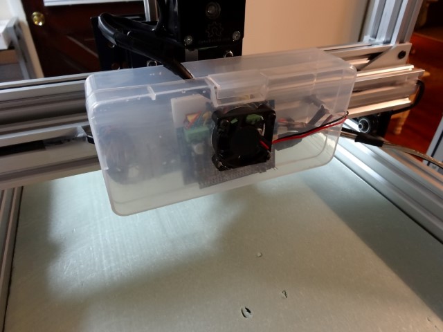

    Here are some photos of the results with the bit in case any want to see. The circle didn't come out too well because I was having troubles with the Y axis again. Should be good again now though, I kept having strange issues with one of the motors on the Y not wanting to work while moving -Y but was ok moving +Y.
    Going to try and recut the circle in hopes I can salvage the part. I will use one of the plunges I drilled earlier to line this up again for another attempt. Just curious but does anyone else drill a hole in their material right from the start to use that for alignment if they have to stop a cut? Or is it just me? I find it useful to do that so I can line everything back up again in case something goes wrong. Is there a better way to do this sort of thing? I saw http://openbuilds.com/builds/tool-position-setting-part-iii.490/ and would like to do that but I'm afraid I'm using GrblController so unless I add the code myself it may be hard to do. Would anyone out there like to have this capability added to GrblController?

    I tried to re-cut tonight I aligned the part spot on and it worked great for a while but when it got close to the end after the 30th pass or so things started going south west. Literally started going that direction, then it cut a large chunk into the side on the very last cut. Maybe the motor's are overheating? If it were a timing issue I would expect it to be consistent. I'm wondering if I will have the same troubles with something a little more tried and true like Mach3. Can I use Mach3 with a grbl shield? Will it still work?

    Do you have a fan blowing on the board? You may want to turn the current levels down just a little for the Y. Double check your wiring is not loose in the connectors. I cut for long periods using GRBL shield with no issues, so there is hope. :)
  16. Ceiling Cat
    Feb 8, 2014
    48
    Below I will give some percentages. For reference 0% is no current, resistor turned all the way counter clockwise (full resistance). 100% is full on (no resistance) all the way clockwise.
    I have noticed that my Z motor gets really hot on the back side. So much so that I don't want to touch it. I have the current limited to a little under half on the Z about 45%. The Y axis motors are both cool to the touch even after cutting for a while. There is not near as much current running through them since the current gets split at the driver for the Y anyway they want double the amount of power. The Y I can almost drive wide open with the grbl shield but I have it limited to about 60% currently. On the X axis current limited to about 50%.
    I will try knocking down the current limits on the X Y and Z to about 30% and slowing down the machine as a starting point for tuning/troubleshooting. How long would you guys recommend running the machine testing before you are confident that your motors are not over-heating.
    Currently I do not have a fan blowing on the board but I will see about getting some heat sinks and a fan. We may have some where I work that I can beg or buy. @kram242 does your routy build use heat sinks on the driver chips or just a fan? Or both? My electronics are not mounted onto the back of the machine as suggested but rather in the front of the machine. Cable drag chains carry the wires to their respective destinations.

    @Ceiling Cat - from my experience I would suggest that the stepper motors current should be adjusted so that they run hot to the touch but not so hot that you cannot hold your hand on them (even after hour of use). Now not everybody will agree with me on this but as a principle it has served me well for many years now.

    I use the fan on the board for sure without it the chips would overheat and I would lose steps. I think this may be the issue you are having.

    Thank you guys, I will try again tonight sometime. I have a little fan here and I will run it directly over the boards to push the heat away. Hopefully that will take care of it and it starts cutting true again for long periods of time. I'll also tune the current and let ya know. I'll shoot for warm to the touch but nothing you can fry and egg on. Thanks again for the suggestions and help.

    BTW I forgot to answer above about the heat sinks. No heat sinks just the 12v fan 40mm blowing on the board

    Thanks for all the help guys, I think I found the problem last night when I was going over the machine. I put a 12V fan on my 24V supply. You can run it at that voltage by the way... granted I don't know for how long but it will put out a lot of air, more than enough to keep the board cool. I actually don't think over heating was the problem anymore. Last night I found that one of the set screws on my Y axis motors was completely gone. After closer inspection I found that the last set screw had almost worked its way completely out and was off the flat part of the motor shaft. Once corrected the machine is a lot more stable.
