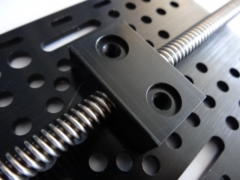

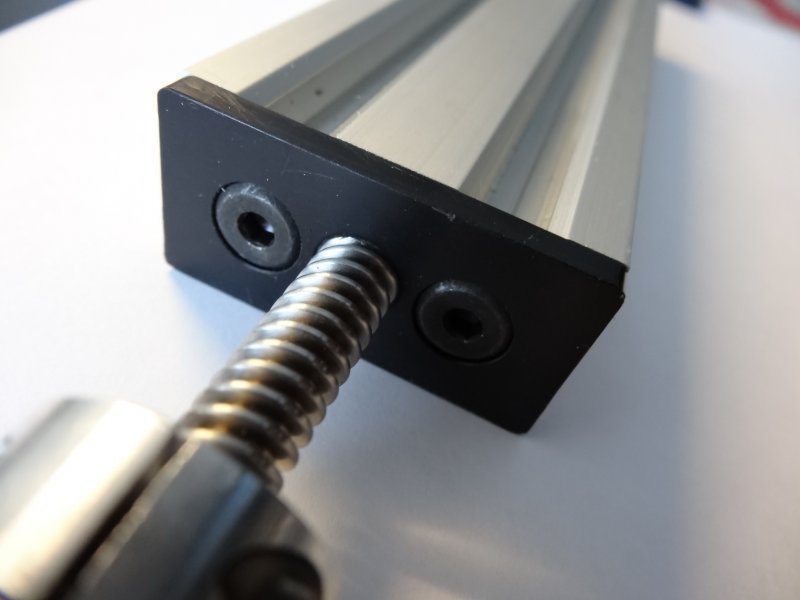

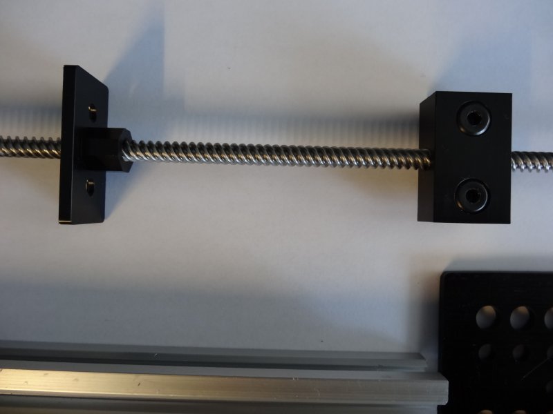

    As for the lead screws and nuts we have been working up prototypes here and experimenting with different sizes. We are most happy so far with Tr6*9 and 8*4
    We figure the 6mm can be used on light duty applications where speed is wanted and the 8 can be used on larger load projects where speed is not a factor. I used a 1/4 20 on the Routy because that is what I had at the time.
    Here are a couple teaser pics as we dial these in in the pic are the 6 and 8 metric acme and the acme nut blocks as well as the acme nut plates, not ETA yet as we want to try a few more things but they will be coming to the OpenBuilds Part Store soon! :)
