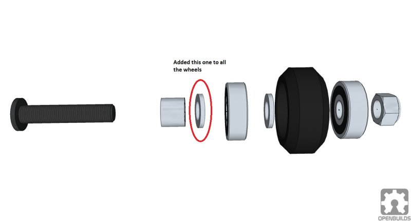

    My mods are highlighted in red. Your m5x10mm screws are too long and the 20x80 should be 20x40 for one of them. I'm still waiting for my gantry plates to finish the build so this is all I know so far until openbuilds ships those to me.

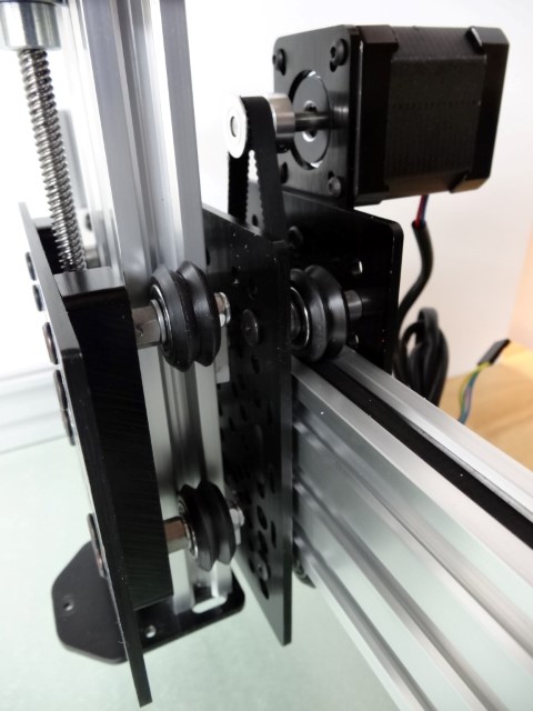

  24. Mark Carew
    2,785
    2,504
    I still have to go though it for the parts list but I did put shims between the spacers (including the eccentrics) and all the wheels.
    These extra shims do not come in the wheel kit. I added them to space the plates just a little bit more to insure that and screw heads on the back side of the plate would clear the rail. They may not be needed but it will be very close if not used.
    You can see some of them them here on this pic
  25. Chris Allen
    Dec 2, 2013
    50
    If you use the low profile screws then you don't need to extra spacers on the two y gantries. I also think the x is fine. (but I haven't attached my x to z) The bottom screw attaching the motor plate is the one which is close.

    My understanding is the precision shims are normally used between the bearings, inside the wheel. The shims on the parts list are the same as the ones included in the wheel kit. The reason for shims instead of washers is because washers are too thick and make the bearings stick out and not contact the delrin on the inner part of the wheel. If Mark added a spacer to every wheel then you would need 16 extra washers or precision shims. Or maybe just 4 because it looks like only the z axis has screws sticking back. Or maybe none if you get the right length screws or put them through the other way, I dunno.
    #146 The Dude, Jan 23, 2014

    Is the point of the shims inside the wheels for friction reasons or simply for spacing. I haven't used any inside the wheels because they didn't seem to make any difference.
    EDIT: Just been playing with a wheel and if you put a shim inside between the bearings you can't tell any difference at all. The delrin has a lip that acts as spacing and the turning friction is the same with or without.

    If you don't use a shim your bearings will wear faster. You have a bolt pressing the inner races towards each other and with no spacer/shim they wear the bearings out. Worn bearings wobble which makes your machine less accurate.
  29. Chris Allen
    Dec 2, 2013
    50
    The washer is literally sliding around inside the bearings because the delrin lip is bigger than the shim. It might have limited use, but only once the delrin has worn away.
  30. The Dude
    The Dude Well-Known
    Jan 2, 2014
    243
    103
    sand some of the delrin off or use a vice to compress the delrin contacting the outer races until the inner races contact the spacer. You may be able to just do it by hand or lightly tap a piece of wood on a socket on the bearings.
