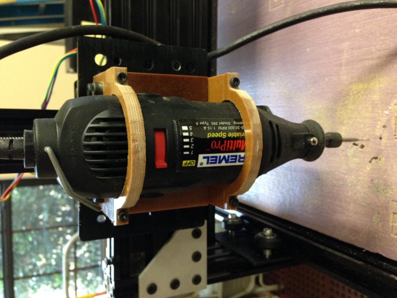

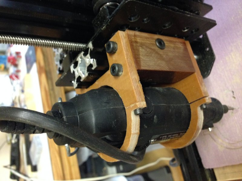

    See attached files for my first Routy cutting of garlite for holder for my Dremel tool. Much better than the temporary way I initially used ... now to experiment with bits, speeds and different materials.

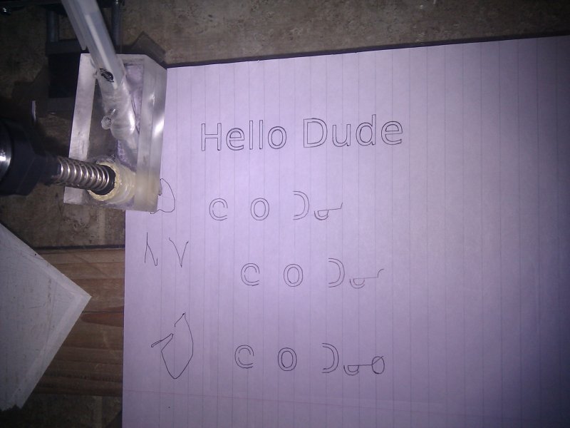

    Thanks. This is my next hurdle... after truing all the axes. I was thinking of using aluminium similar to a scope mount
  9. Forrest DIetrich
    Jan 11, 2014
    39
    I felt I need to get a more solid mount before I could do much at all, tool was getting pushed around some ... not too worried about truing Z-axis as will be mostly cutting thin stuff, and for X and Y, I will check it by cutting some test patterns now that mount is more secure.
    Yes, I did use Sketchup/SketchUcam ... as per the attachments. The segmenting is in the Sketchup files also, it is minor and could be easily sanded out. I did not choose to try to find where to do this for this project :) As I recall there is a setting somewhere.
    I have ordered some mills for aluminum which should also work great for plastic/garlite ... based on web search ... I also already have some 1" blocks and a 1/8" sheet of aluminum I got from McMaster Carr ...

  10. The Dude
    The Dude Well-Known
    Jan 2, 2014
    243
    103
    Looks like I got the axes all trued, haha.

    Thanks for the instructions ... strange an arc is and arc, but a circle is segmented, I did not realize this and your help here is appreciated!
  12. Forrest DIetrich
    Jan 11, 2014
    39
    So after I make a circle in Sketchup, when does it get made into segments? And will it get made back into segments even if I convert it to an 360 degree arc?

    Thanks ... sounds like it is not a good idea to explode components when using SketchUcam ...
    Seems if it is a circle or arc in memory, when I select it, it will all be selected, but if it is "exploded" then individual segments are selected for editing, etc. So I guess this is pretty clear to me know, thanks for the lesson.
