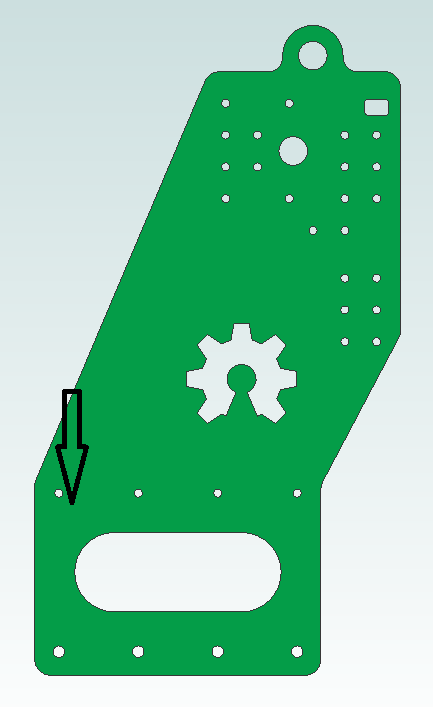

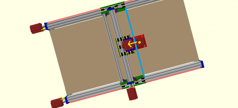

  26. Mark Roberts
    Sep 19, 2014
    Love your build. Think I'm going to copy it as I too want to do both plasma and routing on the same table.
    Just a thought on space efficiency. If you keep the center of your router spindle inside the footprint of your Y plates you maximize use of your table in the X-direction. I'm guessing that your center is about 30mm forward of the Y-plate wheels. If you move your Y C-Beam back about 50mm you will be inside that maxed out zone with plenty of room for a fat cutter in the spindle. Could be done by a slight redesign of your Inside Y-Plate. See pics below.
    The light blue line is the front of your Y Plate. The yellow circle is the center of your router spindle. Yellow arrow moves it back inside the footprint.
    It's now mid-October. I'll bet you have made a lot of progress. Could we see some of it? Keep up the good work. I'm inspired. Sea-ox4 fr Overhead Projection.png Orig Inside Y Plate.PNG Modified Inside Y Plate.PNG
    Mark

  27. Steven Bloom
    Steven Bloom Journeyman
    Dec 18, 2014
    194
    105
    I like your idea. I am not sure though if it would give you any more room on X or Y. But since all my plates have been cut out of stainless steel and the cost of the stainless was 130 and the cutting was like 300, I really don't have anymore money right now for the experimentation. This week I need to clean up the pieces a little and work on my workbench. Right now the CNC is on a plastic table and I am afraid that if I introduce 40 lbs more weight to the table from the new plates, the table might break. But within two or three weeks everything may be built (I hope). I send out some more pictures by the end of this week.
    Thanks Steven
  28. Ronald van Arkel
    May 7, 2014
    472
    245
    Mark and Steve,
    It will give more working area on the Y-axis with the same length of V-Slot/C-Beam. You can even let it stick out further back so it's easier to change tools. The negative side is that the front-wheels, the ones on the left of your drawing, will have a higher load on them because of the weight of the X and Z axis. Reducing the height of the Z-axis/gantry will help a lot there. If the space is needed I would do it else I would keep the plates as they are now.
    -Ronald

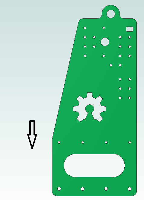

  29. Mark Roberts
    Sep 19, 2014
    Steven,
    First, I am defining forward as the side of the gantry that the router is affixed to. I was assuming your X-forward and X-rearward wheels align with the forward and rearward ends of the spoil board when they reach their respective stops in X. When the current design is at the forward stop your spindle center is dangling off the end of the build. Conversely, at the rearward stops your spindle center is left with extra spoilboard to the rear that it can never reach. One could design the build so the spoilboard sticks out slightly beyond the forward X-end of the build. Then one wouldn't have any concern about this "within the footprint" stuff.
    The Y-axis won't be affected. It still has the same working range. The length of the gantry C-Beam would be the same. As to weight you shouldn't see any more than a few ounces increase in the weight of the gantry since the mod replaces the original inside Y-plates. That's what I meant to say.
    I understand the expense of changing mods. Perhaps the "within the footprint" concept will help in a future build.
    Ronald's reply stimulated another thought regarding Y-axis travel. If you move the taller inside Y-plates to the outside and the smaller outside plates to the inside you may be able to see some increased Y-travel. It would mean cutting a new longer C-Beam, lead screw, and horizontal stabilizing brace. That sounds like too much work and expense to tackle now that you are at the stage of the build with all those things finished. It all depends on what pieces of hardware collide at the ends of the Y-axis first, for example the Z slide against an inside plate, Z wheels against either plate hardware, etc. You'd have to look at your setup to see what would happen first. Really this is just another thought for future builds.
    Best wishes and I am looking forward to seeing your build in action. I love that your C-beams are facing out and giving some debris protection to the X lead screws.
    Mark
  30. Ronald van Arkel
    May 7, 2014
    472
    245
    I also would keep the build as it is, those few inches/cm will not give this build more value. It's already nice as it is! :d It was just a comment on the drawings you posted Mark.
