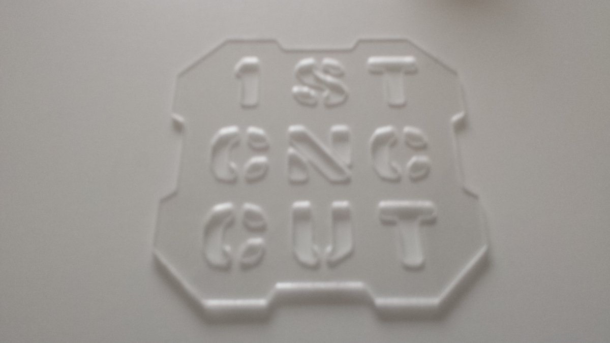

  9. GrayUK
    Well Done!! :thumbsup:
    Keep the pictures coming. :D
    Gray
