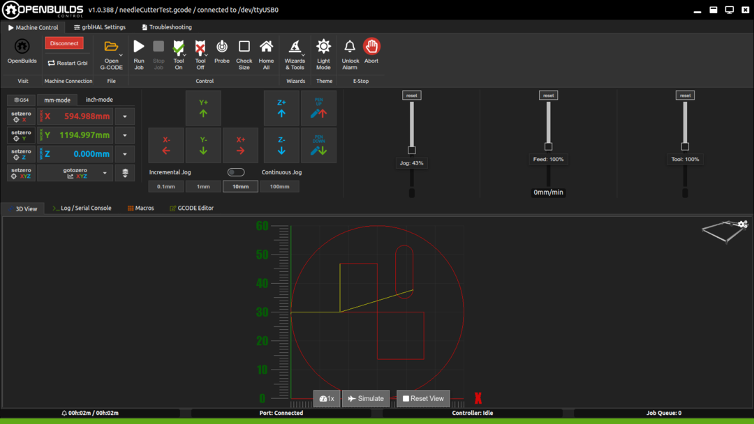

    I created a simple test drawing and converted it to a GCODE file in the OpenBuilds CAM, loaded the file in OpenBuilds Control and ran the program.
    The X/Y axis make the proper moves but the servo is never actuated to raise and lower the pen carriage. I have never used the CAM program before but I
    am guessing the yellow lines are supposed to indicate the tool lifting to make non drawing moves, I see no commands issued in the log to generate tool movement.
    What am I missing here?

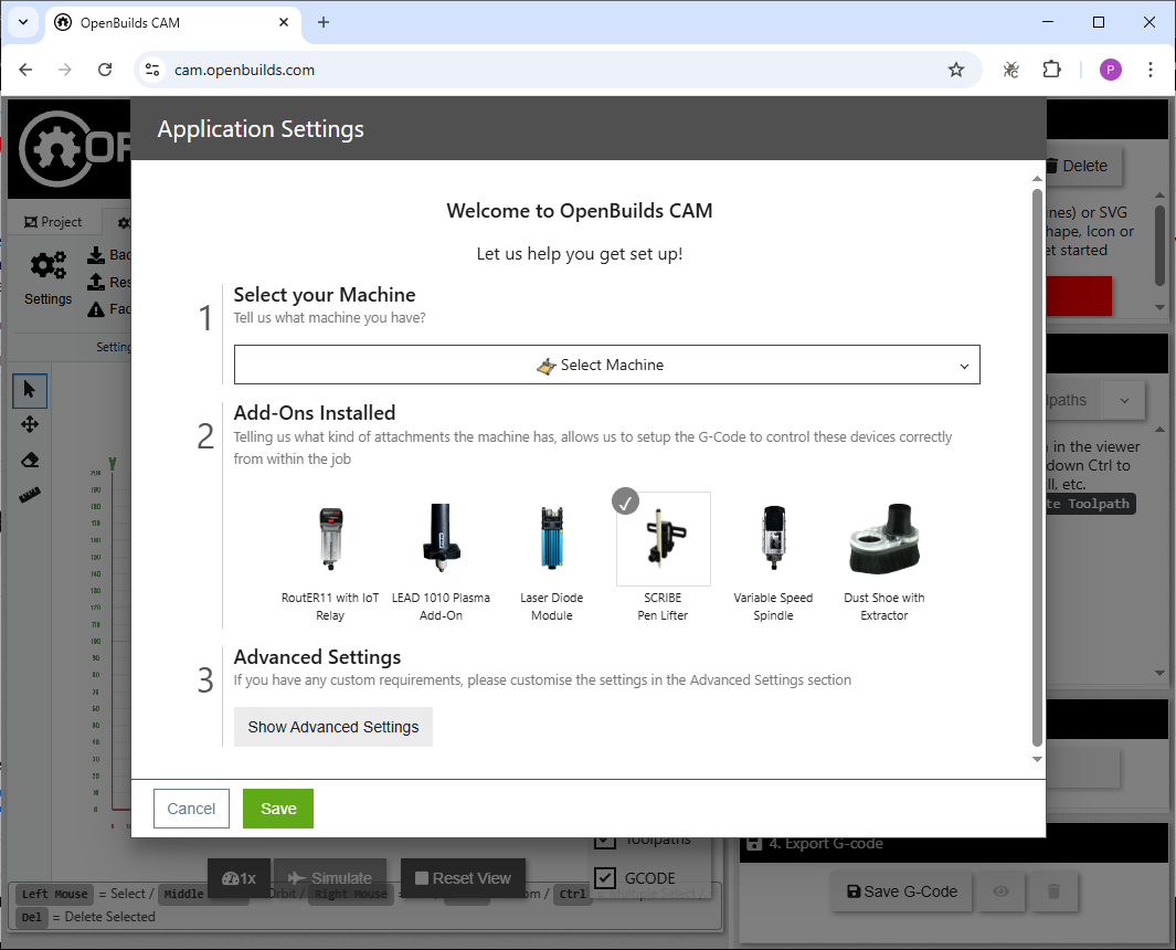

    I have followed the blackbox-32: connect-rc-servo and the servo responds to pen up/down buttons as well as tool on/off buttons, I can also use command line to send move commands to reposition the servo.
    Can the OpenBuilds CAM be used to generate the tool on/off commands required to operate the servo or am I better off just installing a Z axis on my gantry?
    I am not actually trying to draw but run a needle cutter along a tool path to cut EPS foam shapes from 6mm sheets of foam. Basically the same as using a router but using a .015 reciprocating cutter vice a rotating bit.
  5. Peter Van Der Walt
    15,698
    4,499
    Yes, set up add-on in settings:

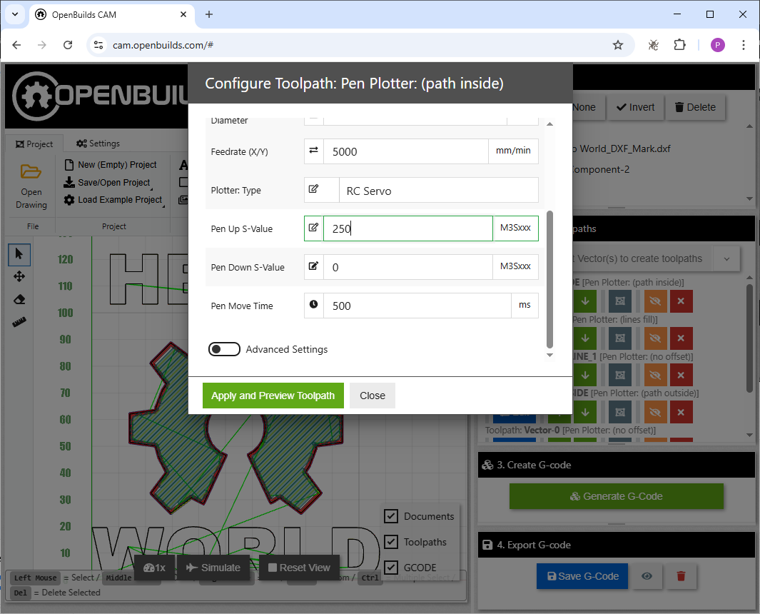

    And you can tune Pen Up/Down S-Values when creating toolpaths
