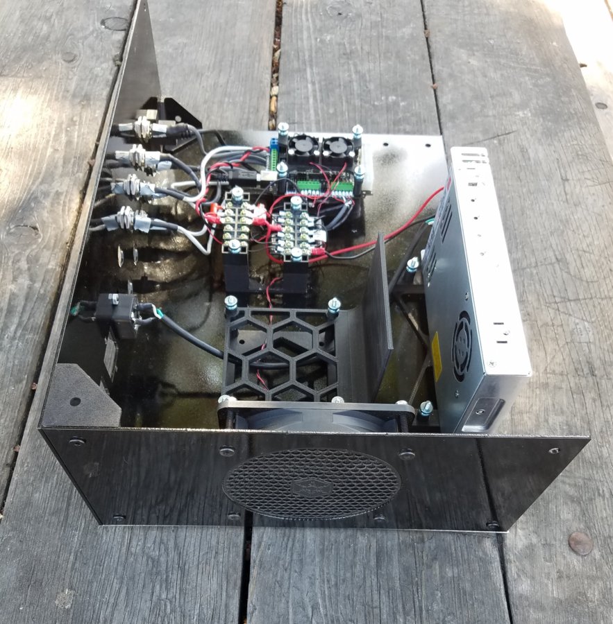

  3. OpenPasta
    OpenPasta New
    Aug 17, 2016
    Nice enclosure design. Did you design this yourself or is this a standard solution?
  4. sharmstr
    2,059
    1,449
    Thank you. I designed it.
  5. sharmstr
    2,059
    1,449

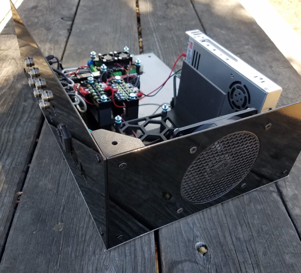

    I decided to go with the DQ542MA drivers from OB and 269oz (2.8a) motors from steppers online (couldnt wait any longer for OB to get the high torque motors back into stock). I'm powering everything off a Mean Well SE-600-48 power supply. The machine has no issue running rapids at 10,000mm/min with the 1/2" lead screw now. Whoop!
  6. sharmstr
    2,059
    1,449
    I worked on my revised control panel this weekend. I was able to get it to the point of working, but I need some assistance on finalizing the wiring.
    I've been reading a lot about wiring on these forums and I believe I have a decent understanding of what's left to do. It seems that most of the information I've read has come from @Metalguru so perhaps he can lay eyes on this and tell me if I'm headed in the right direction.
    1 - I need to add 5amp fuses to the + driver wires.
    2 - I need to add a ground connection on the ac side to the control panel. Then run ground wires from the control panel to all moving axis of the machine chassis. I'm planning on using ring terminals connected to the vslots via a drop in nut.
    3 - All of my motor and limit switch cables use shielded wire. The drain wires are not connected on the motor/switch side. On my xpro version of the control cabinet, I attached the drain wires to DC ground, but now I'm thinking I should attach to the AC ground instead. Not sure.
    4 - I have a opto isolator board for the limit switches arriving soon.
    5 - I have to wire up the SuperPID. The SuperPID and my vac are on a separate 20amp circuit (motors are on a 15amp circuit). I havent figured out where I'm going to ground the vac hose yet.
    If anyone sees any issues with this, or something I missed, I'd appreciate the input.

    It's fine to ground all of these (AC/DC) at the same ground block. Sometimes you will see a DC "floating" ground but most of the time this is even grounded to the chassis defeating its purpose As I've seen on industrial machinery. Just be sure that all your plugs/cables are grounded on the chassis side!! Just be sure that AC and DC wires to not run parallel to each other as it will cause interference.
  8. Metalguru
    Metalguru Veteran
    Dec 29, 2015
    751
    549
    I would say a resounding NO to this. Never connect AC and DC ground together! This will just couple all the noise in your AC circuit into the Arduino and stepper drivers, as well as the other way around.
    I was an Instrumentation designer for 30+ years and I always strived to keep DC circuitry grounds separate from AC. In some cases it works better, but in the vast majority they should be kept separate. Modern computers connect digital ground to chassis, but only at one point and only for EMI compliance. If you really must connect them, run a .1-1uF cap between DC and AC ground, so you have an AC path for noise but not DC.
    https://openbuilds.com/members/sharmstr.107720/, your list looks good, but all shields should be connected to AC ground, and wires must have a shield connection on only one end, never connect a shield wire at both ends. Current must not be allowed to flow through the shield.
    MG
  9. sharmstr
    2,059
    1,449
    Got it. Thank you for verifying. I really appreciate it.

    Never had a single issue with AC/DC common noise in 680/24VDC grounds or 480/220/120VAC being grounded to the same chassis. Environments with dozens of 75+HP drives, encoders, devicenet, Datahighway, ethernet, and none have noise issues with proper shielding and cable routes. I then connected the enclosure to Earth ground for safety purposes. Coming from an industrial setting as a Installations Engineer with a corrugator manufacturer. Just my 2 cents, This topic has always been controversial with many perspectives and my CNC has 0 issues with nuisance trips. :)
  11. Metalguru
    Metalguru Veteran
    Dec 29, 2015
    751
    549
    Too easy to get ground loops by connecting DC ground and chassis ground. Chassis ground is, as you mentioned, only for safety and should never have any current flowing through it unless there is a fault.
    Most stepper drivers are optically isolated from the power supply, and keep the motion controller and USB isolated from the noisy steppers and protective earth. Connecting the power supply - terminal to chassis ground can bypass this optical isolation and can destroy equipment, cause noise problems, and unexplained faults. In addition, in the unlikely event of an AC power fault or short to ground, you can have full AC line voltage present on the protective ground, which, as you can imagine, would not be good for your stepper system, computer, etc. Notice how your Laptop has no protective ground lead?
    Just because it hasn't happened yet does not mean it won't. Better to just not do it.
    MG
