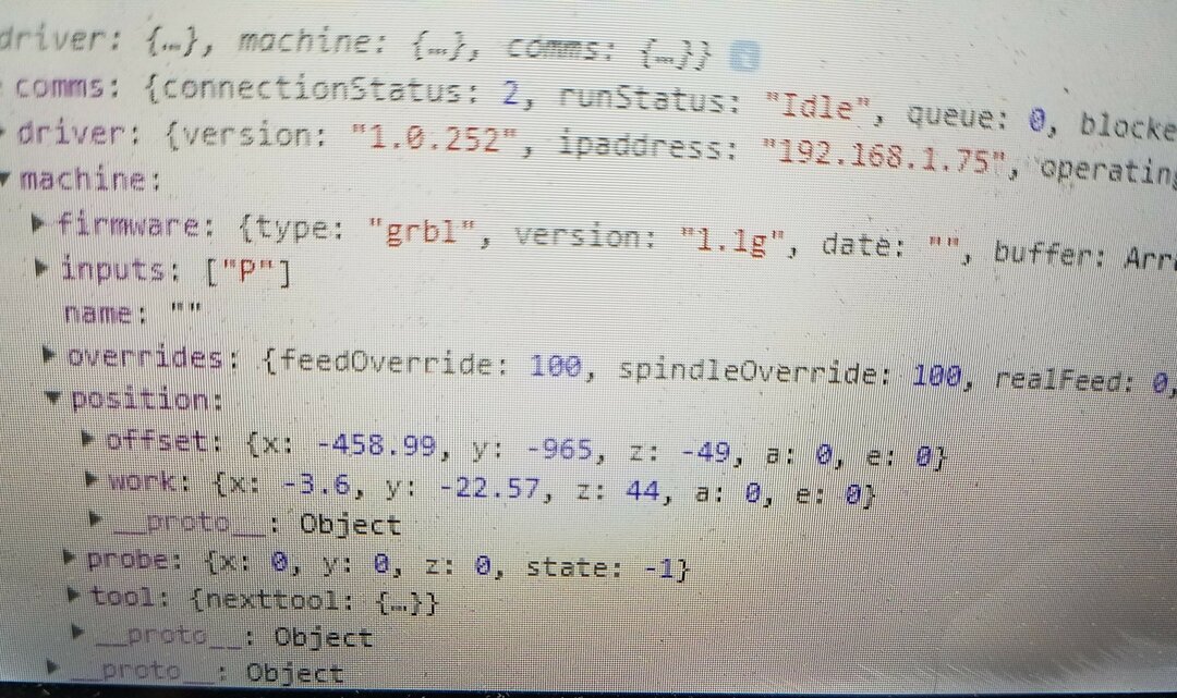

    Comparing current machine position (ctrl+shift+i > Console > 'laststatus' > Enter, expand machine, position. wPos - Offset = mPos) against the command sent (serial log) and the Grbl settings for Max Travel would be good to see why we are sending a longer command then.
    Here's the maths (still works on my benchtop MiniMill here, just tested)

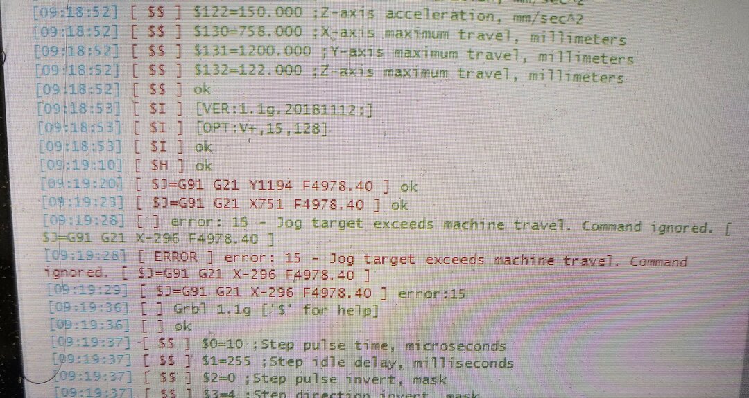

  16. sharmstr
    2,059
    1,449
    Okay.
    "and then the Jog Cancel on keyup". Does holding the modifier keys break this? In other words, do I need to also let go of the shift or control keys in order for the jog cancel to be sent?
  17. Peter Van Der Walt
    Builder Resident Builder
    15,699
    4,511
    We'll have to test that :)
  18. sharmstr
    2,059
    1,449

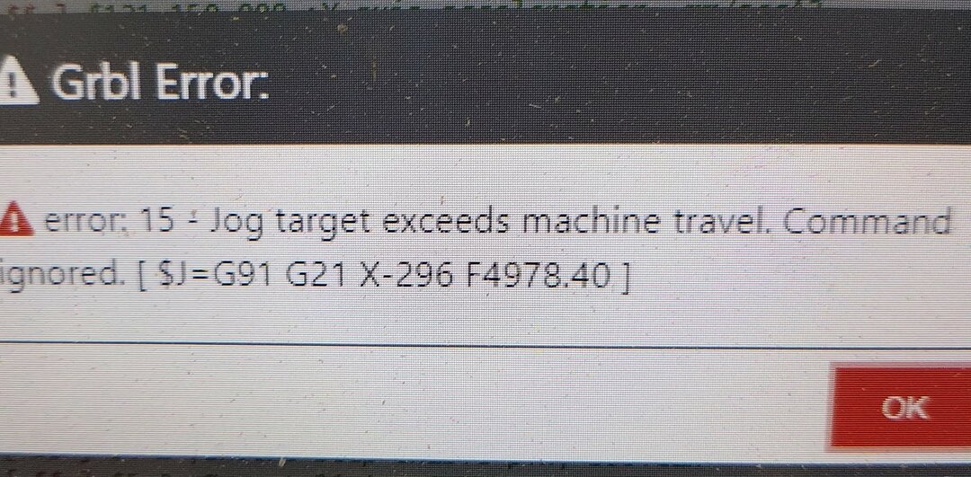

  19. sharmstr
    2,059
    1,449
    So, I think we can safely ignore the correlation with soft limits; it happens regardless. AND it has nothing to do with modifier keys. In both tests below, I used the Y+ button in the UI. I homed the machine before each test so the machine was at Y-.
    This first test shows that the command was undefined, so I ran it again which gave me some actual numbers.
    First test:
    Second test:
  20. sharmstr
    2,059
    1,449
  21. Peter Van Der Walt
    15,699
    4,511
    Ahh i think I know what it is (though may not be an easy fix) - since Grbl status reports rely on Polling, we poll something like once every 200ms. A move before an updated position feedback message, may suffer an incorrect calculation as its working off slightly older feedback data. Will see what we can do :)
