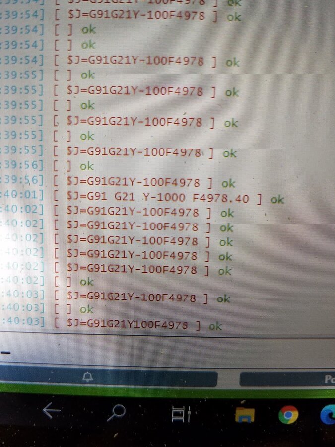

    Never mind. I just tested it. Still getting soft limits error.
    As far as the runaway condition, that's not happening anymore. However, the machine will stop even though I'm still holding the button. Only seems to happen after a change of direction. I can also get it to go the wrong way. Details in video + screen shot of the command that was sent when it went the wrong way.

    Was supposed to fix the soft limits error yes. The cause of the jog Cancel is still unknown (though something else we are working on does cancel every time, so it is a CONTROL bug, just still not sure if its a race condition in Chromium (not generating the keyup/touchend/mouseup event) or something in our logic. Will look at it deeper when I get a chance)
    Will look at the soft limits fix again later today :) see why I don't give the installers before
    Hehe :)
    The all 100s in the log looks like incremental, was the switch in the right spot? We only calculate distance for maximum continuous move to send (send it to the limit, cancel if you lift off button before)
    We dont bother checking Incremental (can if we have to)

    No, it was in continuous. The screenshot was really to show you that it moved the wrong way.

    This is what caught me offguard (first thing to check on why then) - as continuous shouldn't be doing round numbers, should be floating point numbers of "distance to go before we hit the end of travel, calculated from max-travel and current mPos)

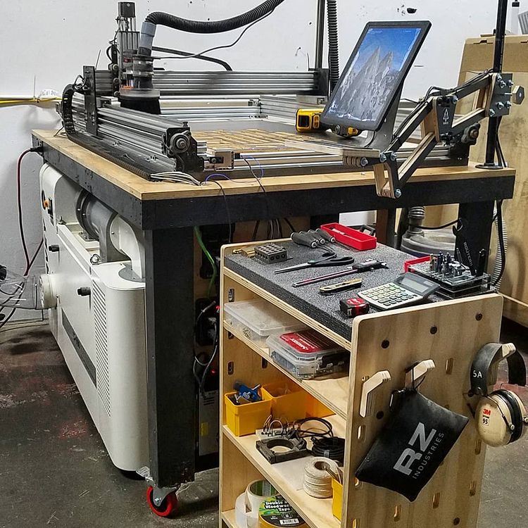

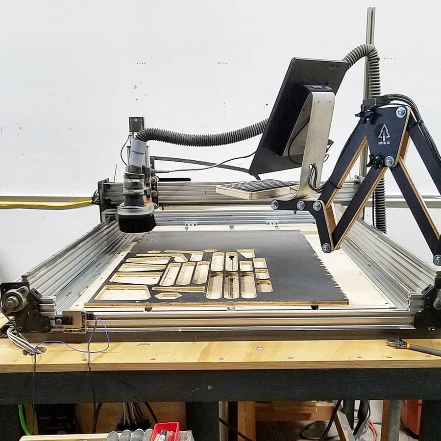

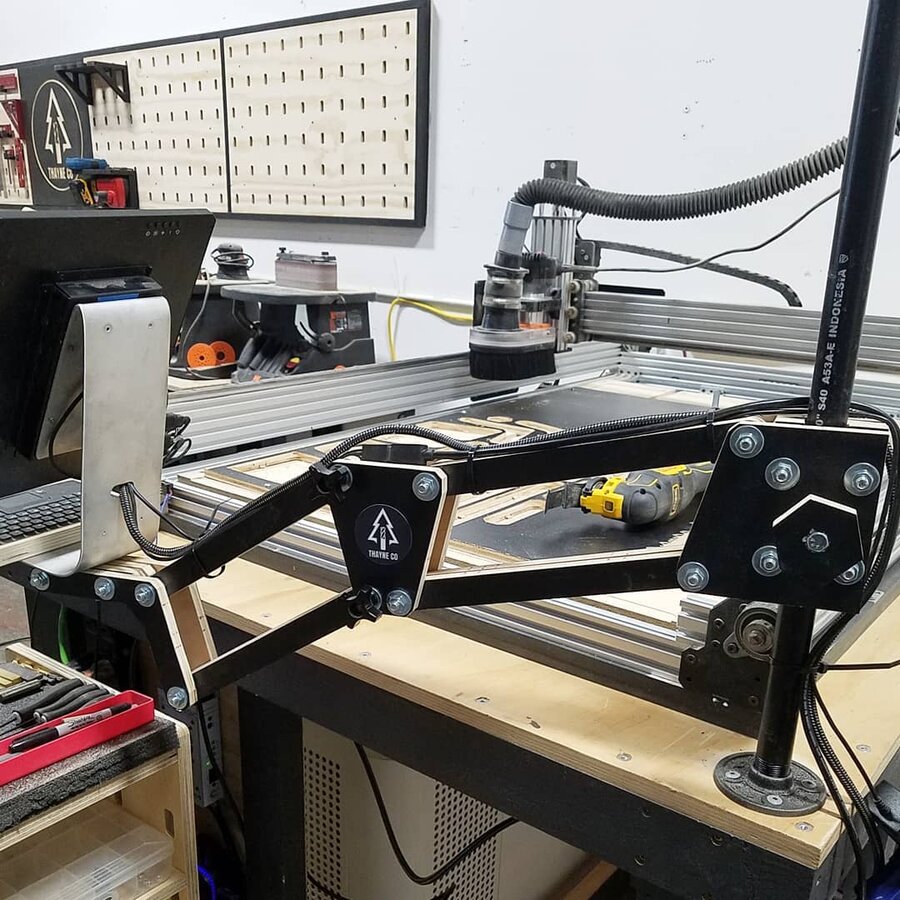

    Spent a few days reworking my table to accommodate the new G700 dust processor. Fingers crossed that I dont have EMI issues. (the big white thing under the table)
    It was also time to replace my waste board. For the last few years I've had the 3 20x80s that support the spoil board laying on the 80 side, with 1/2" mdf on top that held my t-track, then 3/4" mdf removable sections that could be replaced when needed. Decided to move the 2 outer 20x80s under the Ys and completely remove the center one. Now the 1/2" t-track board is mounted directly to the table, which is 2 pieces of 1/2 mdf on top of 3/4 ply. Bottom line is I picked up another 20mm of Z clearance. Because of this, I had to remove the top/front 20x20 so my dust shoe doesnt slam into it.
    The monitor and keyboard now live on the Woby Camera jig. I modified it a bit by adding some black formica to the ply before cutting it out. Its nice to be able to use the monitor/keyboard from both sides of the machine now instead of just the front.
    Oh and those of you who use Fusion, check out the new arrange feature. I've been using it a lot lately.

    I like your computer stand, do you have DXF files of those parts and can ( want) you share.
    Bert Klappe
  23. sharmstr
    2,059
    1,449
    If you are talking about my rolling setup cart (has nothing computer related on it), you can get those files from PDX CNC. I've modified it to use my tool wall holders.
    If you are talking about the articulating arm that my monitor is attached to, you can get those files from Woby Design.
    If you are talking about the monitor and keyboard mount, I hand bent some aluminum. No files except for the keyboard tray which is very specific to that keyboard.
