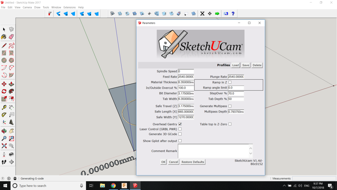

  21. Cee_Tee
    Cee_Tee New
    Oct 7, 2018
    Hello to all.
    New to this forum, just joined, first post/question here.
    Built my own cnc in 2016, 2'x4' cutting size. 4" cutting height. Mainly made of wood, designed to cut wood.
    My toolchain.
    SketchUp, sketchucam, USG, arduino grbl. Not sure of the version.
    Everything works, cutting 2.5d. no complaints. Done many projects with it.
    Except for one annoying part that maybe experts here can help me.
    The gcode that sketchucam make, has these lines. M3 S0 in it. If I don't remove this line at the beginning of the code, the cnc will only function with x and y movement. The z does not work.
    So I always remove this line, and everything will work.
    Question.
    Is there a way to remove this without me editing the gcode file?
    Thanks.

    You must have set your spindle speed to zero in your Parameters.
    I do mine manually, but in the Parameters I left it at the default of 15000 rpm. I changed mine to zero and made a quick drawin in Sketchucam. When I generated the Gcode I got the M3 S0 like you mention.

    My guess is that UGS will not lower a spindle into the work area if it thinks it is not turning. That is only my guess since I do not use UGS, but it would make sense. Give it a try and see if it works..

    1,977
    You need to set a spindle speed > 0 in the SketchUcam settings.
    The M3 Gcode tells GRBL to turn the spindle on
    The Sxxx tells it how fast to run it (but you don't have a speed control connected).
    But S0 means 'set speed to 0' which is the same as 'spindle off' so it ignores or undoes the M3 command.
    Now, I have run plenty of gcode with the spindle off (through bCNC to GRBL) and GRBL obeys all Z commands so that leaves UGS being 'clever' and preventing Z move when spindle speed is 0.

  26. Cee_Tee
    Cee_Tee New
    Oct 7, 2018
    Tried changing it. Same. It only moves x and y. Z is ignored.
  27. Cee_Tee
    Cee_Tee New
    Oct 7, 2018
    I guess I need to dig more to UGS. Thanks.
