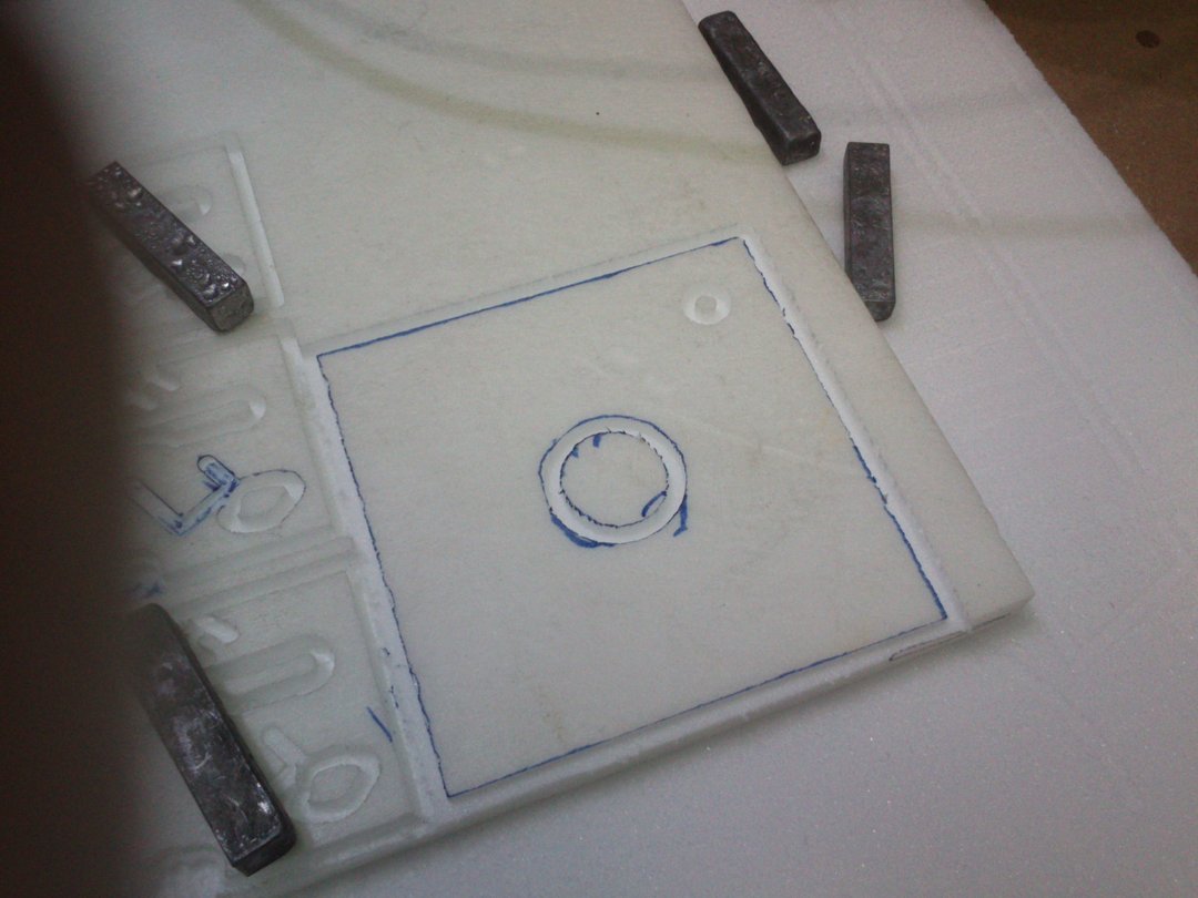

    I thought 'oh, cutter compensation is on' but then realized that would affect the size rather than just an X offset.
    I read you gcode into g-code-ripper and converted it to dxf, and the dxf comes out correct.
    I red your original dxf into Sketchup and it is correct.
    So now I want your Sketchup file so I can generate and run gcode directly from it on my machine.
  2. David the swarfer
    3,604
    1,978

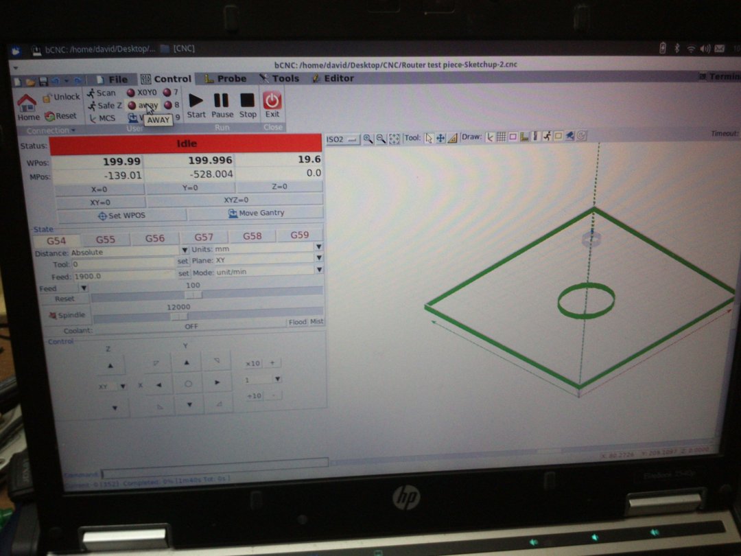

    I just ran both files of code through my machine and it cuts perfectly with everything centered as expected.
    I cut both files with the same 0 settings and they cut exactly on top of one another. (I did change the feed rates though, from F200 to F1900 so it would finish today :)
    I highlighted the edges of the foam with Sharpy so they can easily be seen...
    DSC_0023.jpg displayed in bCNC
    so now I think you have a Mach3 problem (assuming it is not hardware).

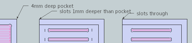

  19. David the swarfer
    3,604
    1,978
    I use the label tool pointing at the origin for this drawing and put the reminder I need in the text portion.
    In this drawing I just labelled the top corners but you get the idea.
    I am using a new method for multipart drawings so the labelling of the origin point is not needed in this
    drawing.

  21. David the swarfer
    3,604
    1,978
    labelled tags like that are exactly what I am talking about.
    my old method involved making multiple copies of the drawing at regular offsets and using a construction line to define the 0,0 point, then moving a suitably sized 'safe area' box from point to point to select what gets generated.
    recently I have been doing it differently. I still make copies of the master drawing but they can be at any spacing and do not need a constant offset.
    The safe area is left as the same size as my machine and encompasses all the drawings.
    I then pick a constant feature within the drawing as the 0,0 point and use the zero point tool to set that as the origin for each drawing in turn. I then select the stuff to be cut with the selected origin and generate Gcode.
    In this way one origin can be used for more than one set of cuts, for example one of the drawing copies may have holes AND pockets on it but by selecting just the holes and a generating and then just the pockets and generating that one drawing can serve 2 purposes. This is handy for very precise depth pockets. Set the pocket to 100% deep and then set the material thickness to the exact depth you need. Yeah, I need notes to keep track of what goes with what but that is normal.
    I also sometimes generate a hole drilling file with just 0.5mm material depth which really just marks the surface. I run this (with a real drill bit) and then use my electric screwdriver to drill the holes through before running other code. I do this mostly on polycarbonate plastic which gets hot and melts very easily when drilling so a pilot hole is very helpful.
