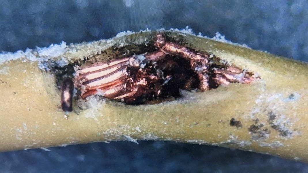

  4. BKramer
    BKramer New
    Nov 16, 2020
    Just had this problem, stuttering on Z. Tried all the software solutions and no change. Finally figured out it was positional (it worked on one side of the x travel but not the other) and found a short inside the z stepper cable (from openbuilds). Spliced it out and ordered a new one from Amazon.
