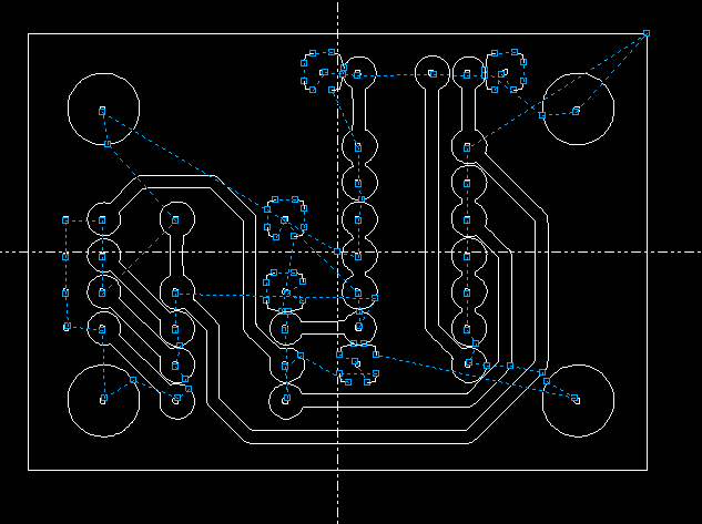

  5. bogaskilop
    Apr 8, 2017
    Hello all
    I recently made this controller and I'm having difficulties with mach3 configuration as manual speed control is working fine with the potentiometer but for some reason I can not get it working with mach3 and my test RnR motion controller [​IMG]
    I connected one wire to GND on this board and second to output 4 I deselected output 4 in output signals in mach and in motor output / spindle use :
    Step pin #4 Dir Pin#0 Dir LowActive # X (red X) Step Low Active # X Step low Step Port # 3 Dir Port # 0
    Kernel is set to 25000 Hz
    Spindle setup / selected: use spindle motor output and PWM Control selected , PWM base Freq # 500
    Relays controls and flood mist control are disabled
    because I measured motor speed I put in pulley max RPM of that motor witch is 10970
    but when I execute S10000 and M3 motor is not running unfortunately
    Any ideas where I made some error ?
