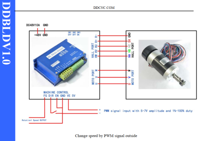

    I noticed there is a spindle control area there. My spindle has a pwm and ground. Do I just slap that on arduino pin 11 and ground? Is there anything else I'd have to do?
    Thanks in advance!

    Mine is just an arduino with a breakout running to my stepper controllers...
    So um, I don't have that jumper, it's just an arduino...
