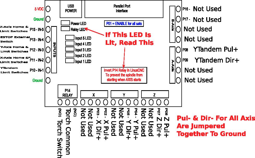

    :) LOL! It's one word -- sort of -- and it's a switched ground on the Arduino boards. Ground to one pin on your CNC connector, the other CNC connector pin goes to the Arduino pin.
    Honestly, Richard -- I have given up on this THC; it was too flawed and the Arduino boards are just too lacking in capability.
    I have just finished re-building my table for LinuxCNC with the old Arduino Mega 2560 now running a "brain dead" THC through QtPlasmaC in Mode 2 (up & down inputs right into LinuxCNC, which handles all of the Z axis adjustments natively).
    LinuxCNC was much easier to build, and offers G-codes/ M-codes that GRBL cannot offer due to the limitations of the boards. And, to be completely objective about it, I think that LinuxCNC does a better job all-around -- it easily interfaces with a THC, and offers things like ClassicLadder which allows you to run a "status light mast" and other nice additions to a table/ mill/ lathe/ etc. And it doesn't cost an arm & a leg (unless you go with the Mesa boards & Mach3/4) -- my table uses 2 parallel ports connected to 2 SainSmart ST-v3 breakout boards. It runs on an old Dell Optiplex 755 that I salvaged from my "better keep it for future use" pile. The whole conversion cost me a total of $60

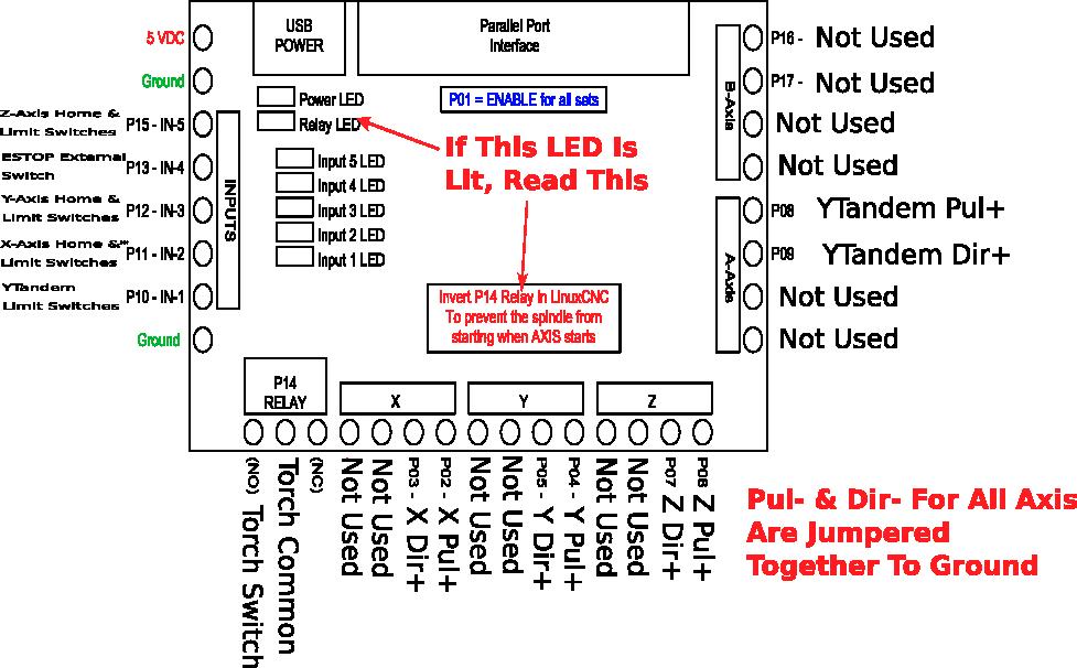

    I am very familiar with Linux, actually prefer it over windows. Could you post a simple wiring diagram on how you set it up with Arduino mega and the BOB.
  21. cnc-trucker
    Mar 20, 2024
    14
    16
    I'll do you one better than that -- check out my Git repository at GitHub - ccwtruck/LinuxCNC-4x4-PlasmaTable: Complete working LinuxCNC 54" x 60" Plasma Table Control Software With Arduino Mega 2560 THC for a complete diagram, config files and system description. That should give you everything you need to duplicate my table if you want.
