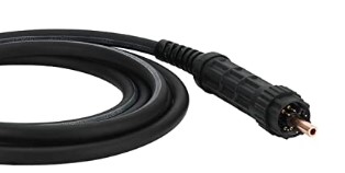

    What you suggest creates another problem. My plasma cutter uses a different connection for the torch. The first photo is the connection that my plasma cutter has and the second photo is the torch you suggested.
  8. Peter Van Der Walt
    15,246
    4,350
    Talk to the vendor.... They can put any plug on any torch.
