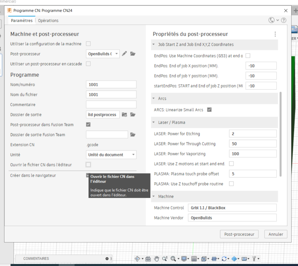

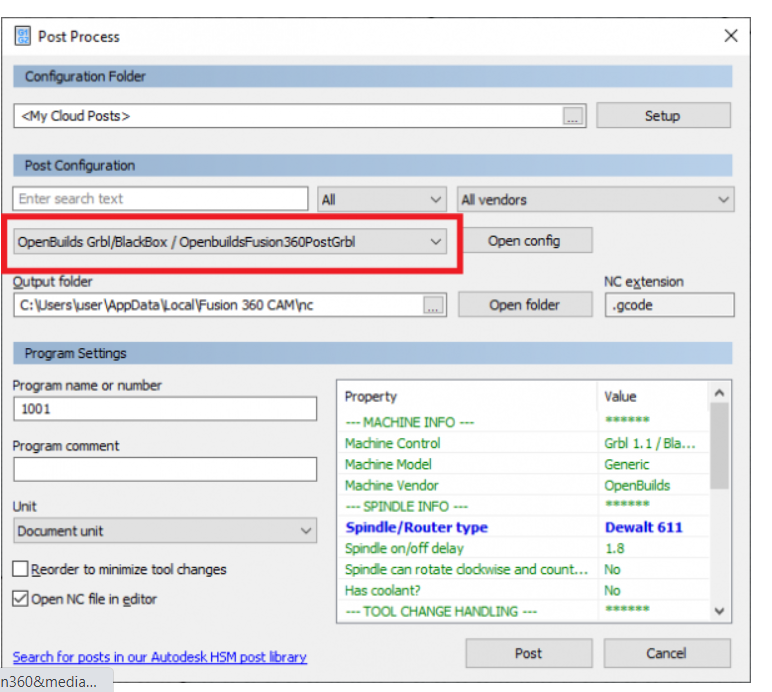

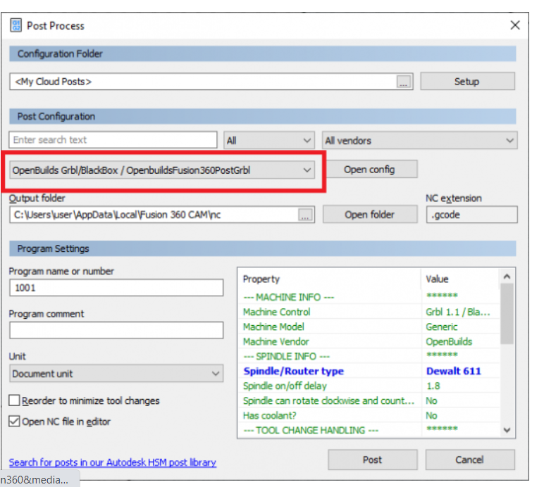

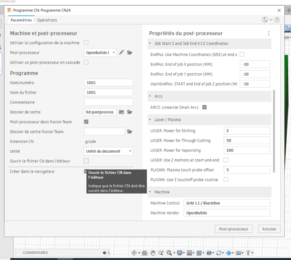

    I went to '' docs:software:fusion360 [OpenBuilds Documentation] '' and try to do the procedur, every thing is ok until i get to the #3 step. I can't find this dialogue box:
    When i click the post traiment in F360 i get:
    What am i doing wrong?
    Marco
