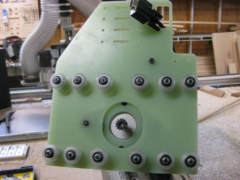

    Ok I completely disassembled the Ox and started rebuilding, got the Openrail mounted to one of the 2080 Y extrusions, and installed the rack with the clamps I already cut out, btw I still need to add about 4 more clamps to hpld that rack securely. REV3 plates are cut, mounted and tested. Ran the plate back and forth up to 1000IPM, backed it down to 600 in the video.
    The gear mesh noise in the video is coming from between the clamps, the rack is flexing and causing that noise, 4 more clamps on the way. Ran smooth and fast, cutting out the other side tonight. Still need to finish off the tensioning system, there will be a spring on top of the bolt providing constant even tension for the drive.

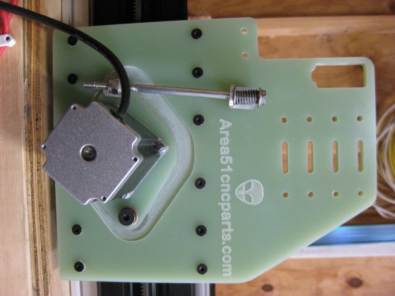

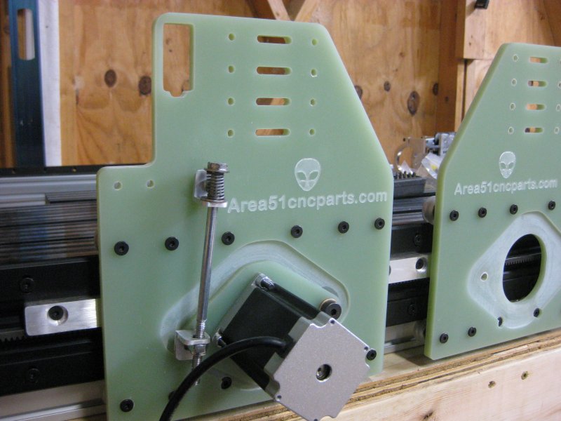

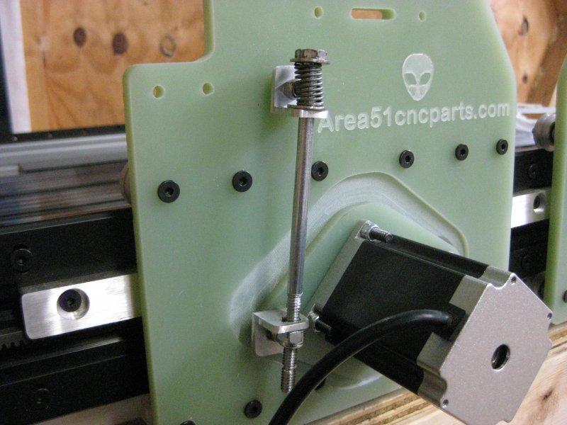

    They say a picture is worth a thousand words....
    I'm not sure of a better way to do it than this. The spring keeps constant tension on the spur gear and rack teeth engagement while at the same time taking up for any irregularities in the rack.

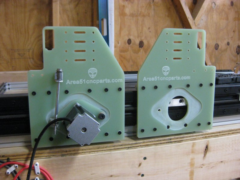

    Ok, time to kick this in high gear and get it done... Both Y plates are assembled, and all the clamps are installed on the right side, waiting on a couple bits to finish the clamps for the gantry and the left side. Prototype tensioner is tested and works great. Seven rack clamps took care of the flex in the rack. Twelve wheels per side should do the trick . :) I hope to be wrapping this up this coming week, just waiting on a few supplies. Here are a few photos,
