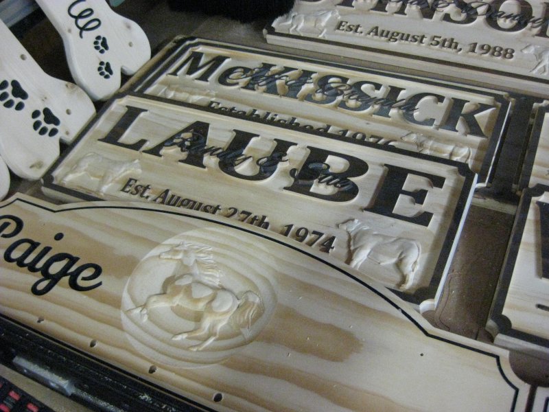

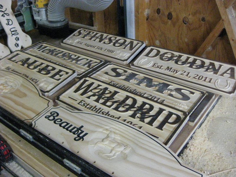

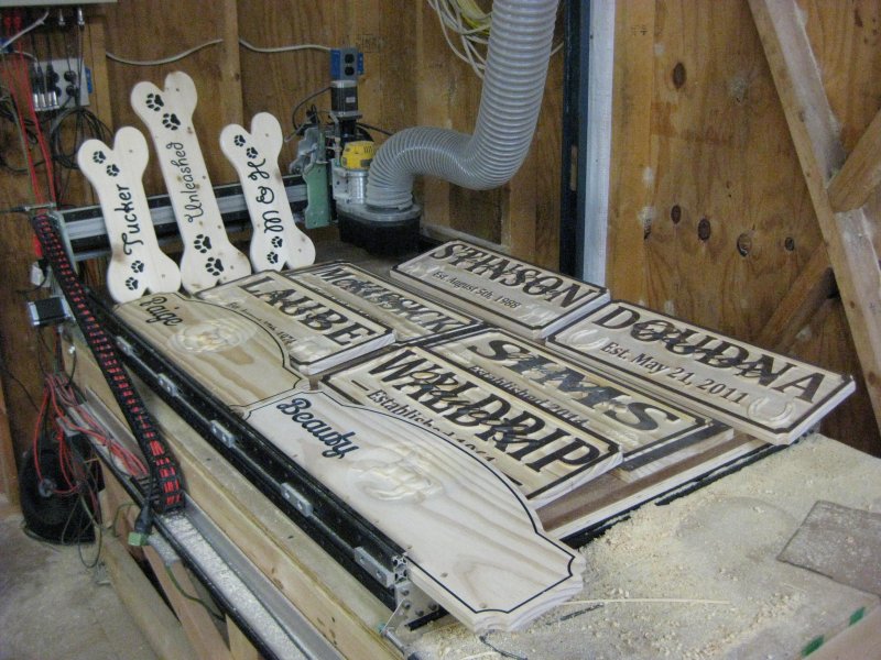

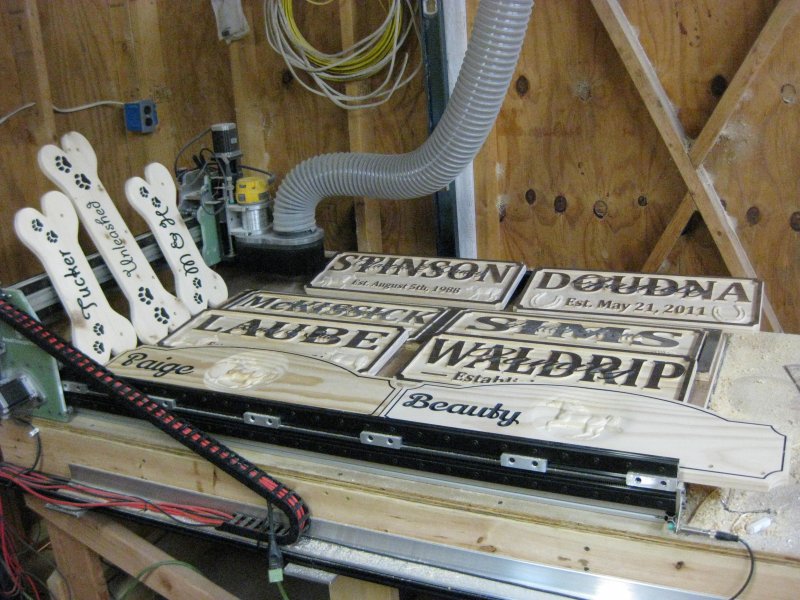

    UPDATE 01/25/2015
    As far as i'm concerned this build has proven itself, i've cut probably 20 different signs ranging from straight easy v-carve stuff, signs with a good mix of pocketing and 3D, to full on 3 hour per sign 3D cuts !! No issues what so ever.. We even cut some .25 6061 aluminum just for kicks !!! :) I am in the process of assembling a BOM for this machine now, the plates will be available from me the first week of February. I will be offering them in 6061 aluminum for right now, i'm setting up to anodize now so plate sets in different colors will be available. Here are a few photos of a portion of the signs this machine has cut over the past few days.
    [​IMG][​IMG][​IMG][​IMG]
    I am extremely pleased with this machines performance and it has met and exceeded my expectations. I believe it will fit in great as a primary or secondary machine in a small business production capacity. Over the next few weeks I will be ordering the parts to assemble a vacuum hold down system using 3/4 Phenolic to make "vacuum pucks/jigs" . I think this will be much more cost effective given the type of work i'm currently doing. I really would like to use the bleeder board method, and maybe I will on my large machine if I go to start cutting a lot of sheet goods, but I don't think it's best when some of my signs take up to 5-6 hours nested. That would certainly be hard on vacuum motors and my electric bill. Thanks and stay tuned for revisions on this build !!

    If anyone needs proof the evidence is shown above.
    Awesome signs, design, engineering and build!
    Really great job...

  21. Neil Rosenberg
    Neil Rosenberg Journeyman
    Dec 29, 2013
    182
    180
    VERY nice machine, I've learned a lot from your design process!
    I'm curious, what are the bits that you use. They look like Amana tapered ball nose, but I'm not sure. Also, where do you get them from?
    Love your signs too!
  22. Hytech2k
    Hytech2k Veteran
    May 6, 2014
    429
    332
    Thanks everyone !! I buy my tapered ballnose bits from either precisebits.com or toolstoday.com. They're expensive but worth it.. My 1/16th bits are ZrN coated Amana bits from toolstoday. I also use CMT v bits I get from Amazon, good quality. And for profile cuts I pretty much always use a 1/4 2+2 compression bit, leaves perfectly clean edges unlike a upcut or downcut, less cleanup... I've compiled a list of companies I buy from, if anyone is interested i'll post it here...
    GrayUK, Knut Bøje and Rick 2.0 like this.
