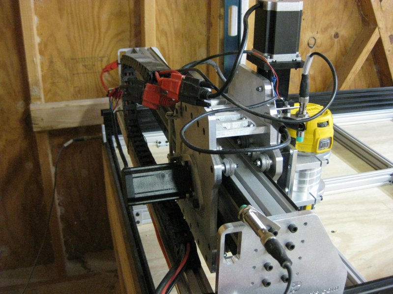

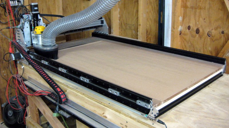

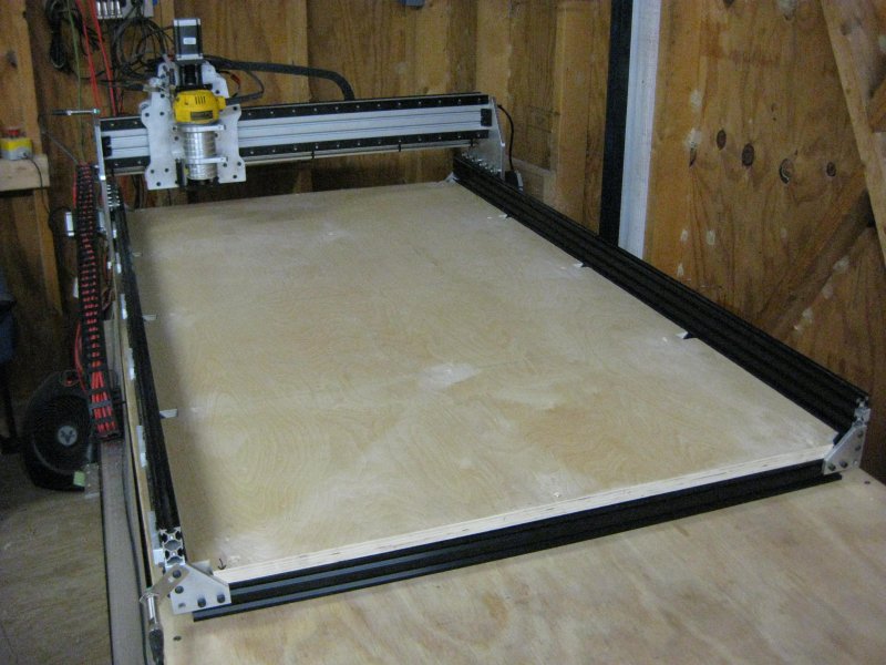

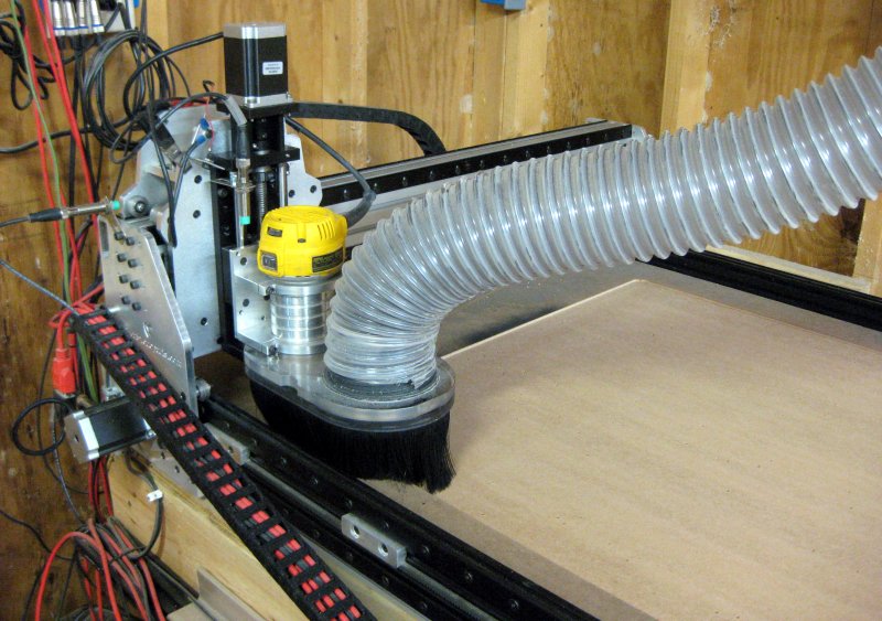

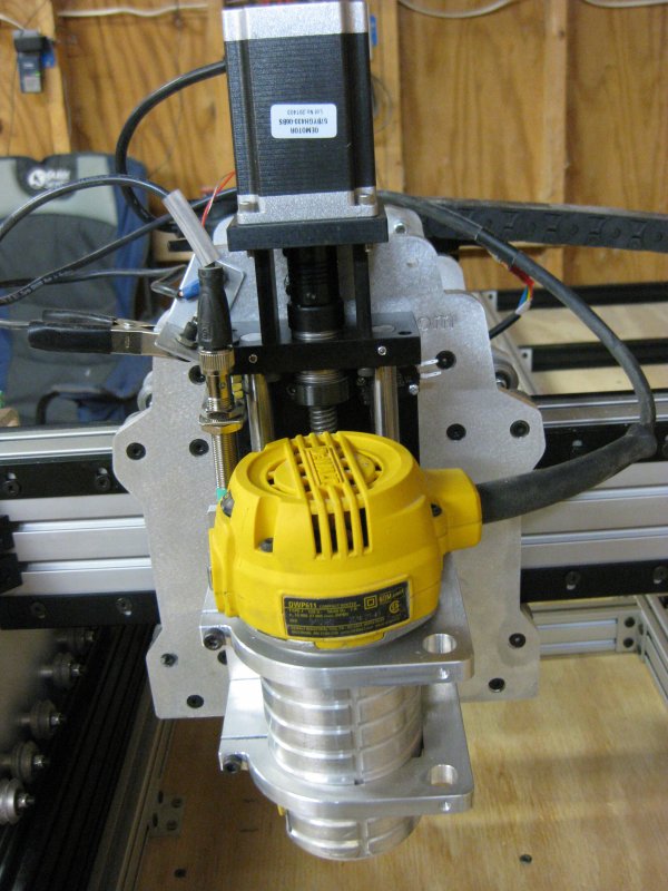

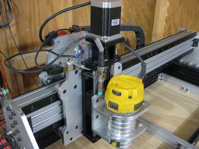

    UPDATE 02/03/2015
    The machine is working great !! No issues to really speak of, we are getting ready to change the gantry over to the 5010 extrusion, i'm pretty excited to see if that removes the little bit of chatter that's present when we use a generous DOC. I have to cut 2 more plates then we'll swap everything over, we are also going to try reducing the number of wheels on the gantry plates to 4 on top and 4 on the bottom of each plate, to make it easier on the wallet when purchasing the wheels. Also the DeWalt 611 router i'm really happy with it's performance, I run at about the same speeds, feeds and DOC as my other machine with the 3 1/4 hp router and I don't have any issues with it bogging or failing to keep a pretty steady speed.
    The only negative thing I have to say at this point about it is the brushes wear out pretty quickly, go to ereplacementparts and have some spare brushes and bearings on hand. This is a good example of why you need to be with your machine when it's cutting. I had a 1/8 downcut endmill working on a pocket when I heard the router stutter a few times like the power was going out. I used feed hold in Mach 3, raised the router, DISCONNECTED the power cord and removed the top. Both brushes were about gone, I modded them to get a bit more life out of them while I have to wait for the new ones to arrive.
    Here's the lesson, if that would have been a 1/4 endmill or one of my expensive tapered ball nose mills, they probably wouldn't break, the machine and software doesn't know the router quit and would just keep on trucking, who knows what damage would have been done to the machine if I wasn't present to step in and stop it before it quit...
    Hopefully I should have the new store Area51cncparts open in a couple weeks, i'm trying to get ahead of my sign orders and get some plates cut to have in stock. We will be also carrying some custom parts for those that wish to upgrade/mod their stock Oxes such as new router mounts, end braces, custom axis plates and inner plate packages !! So stay tuned !!

    I have been using a Porter Cable 7518 on my other machine for the last couple years and it's been great, but I can run it for at least 2-3 months before changing out the brushes. The 611 just went through them rather quickly, i'll probably replace that router sooner then later. A 9 pound spindle would be fine, the 5010 extrusion will handle it easily and the z slide and Nema 23 with no problems. I was thinking the 1.5kw because it would roughly be 2 hp but a .8 air cooled might be nice, 1HP is probably more than enough for the work it will be performing. I like this one from Ugra, a bit pricey though. And at 7lbs that not too bad...
    Edit just looked up a 2.2kw ... 12lbs for the watercooled, 7 for the .8 watercooled and 7 for the .8 air cooled.

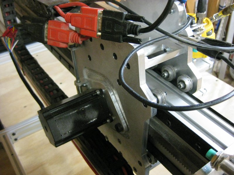

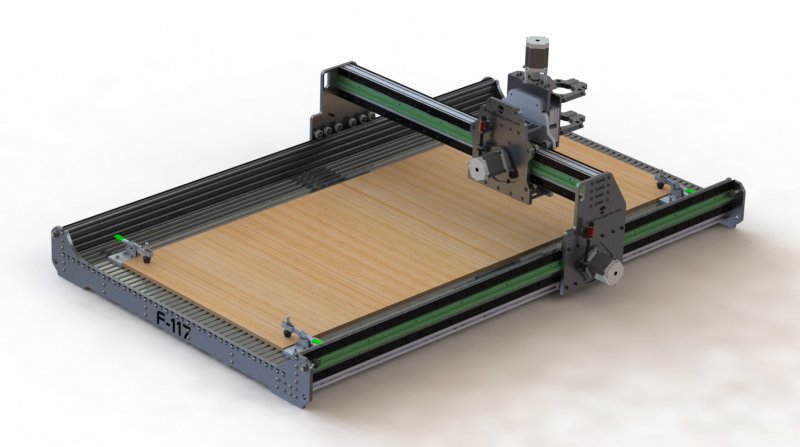

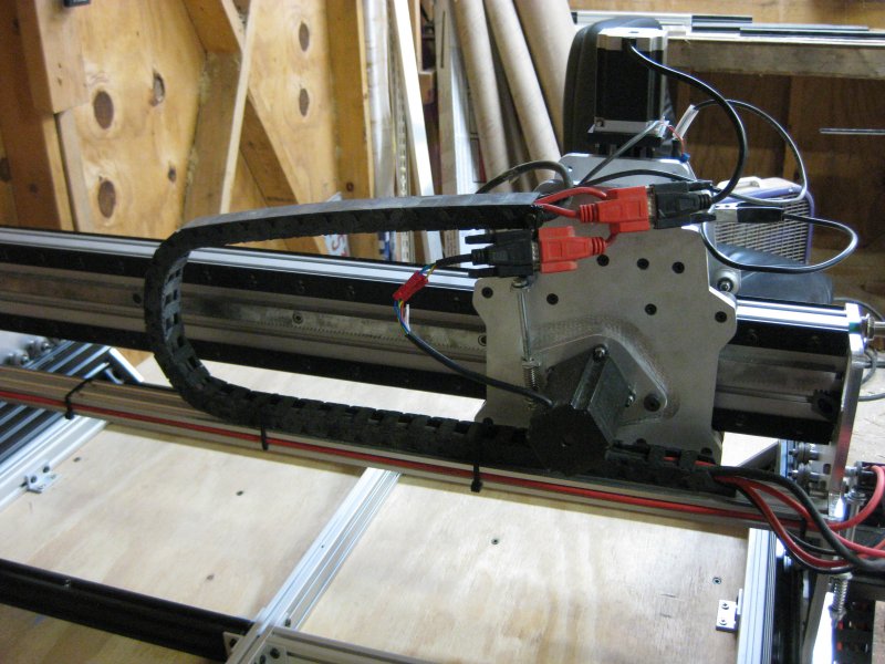

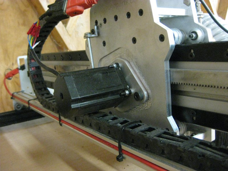

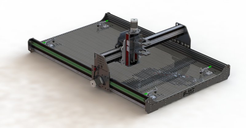

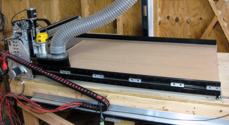

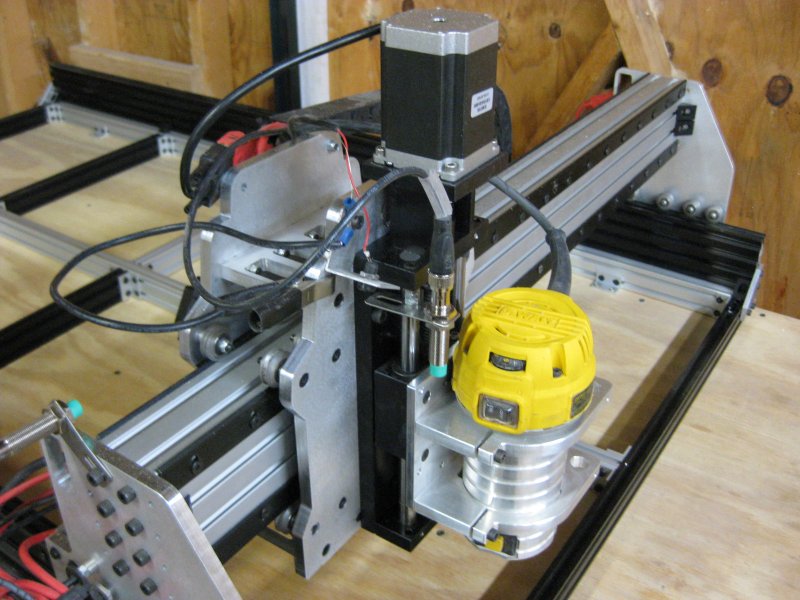

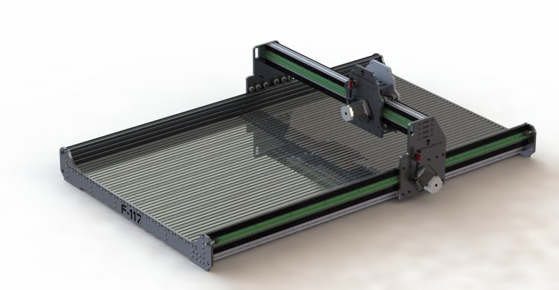

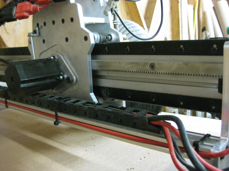

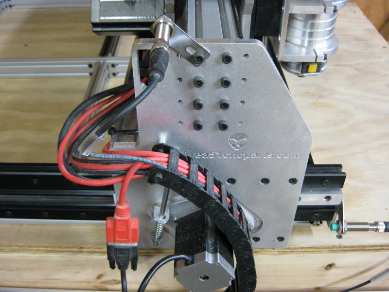

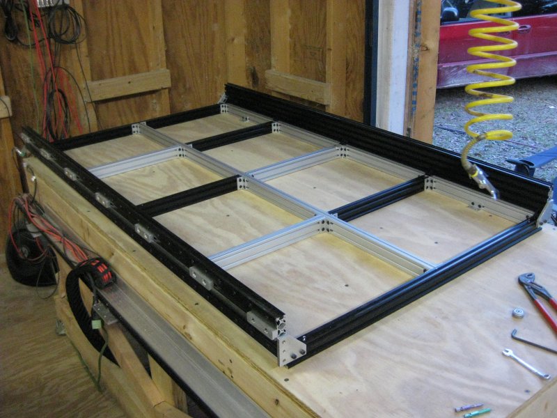

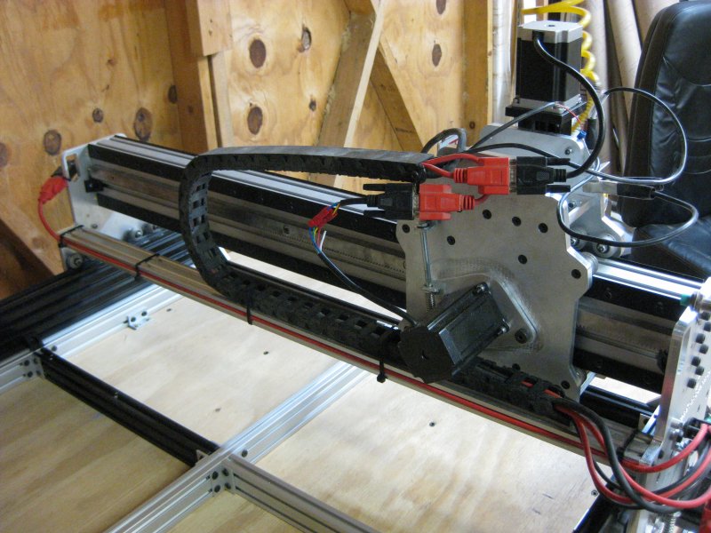

    UPDATE 02/18/2015
    The machine has been cutting 6 days a week for the past few weeks with no issues other than having to replace the brushes in the router. We have probably cut 40+ signs over this period.
    We finally had a moment to tear it down to redo the gantry with a 5010 (50 x 100mm) extrusion, while we were at it we took it down to the base and checked everything out, looking for any possible problem areas. While we had it tore apart we took that opportunity to create a complete BOM for the machine. I'll be posting that as soon as I get it entered into Excel.
    CHANGES
    We cut all new plates from .375 6061
    Changed out the rack on the gantry to 20 degree pressure 20 pitch 1/2 x 3/4 rack
    Changed out the X axis motor to a low inductance 320oz Nema 23 with a .375 shaft with a 15 tooth spur gear
    Back gantry plate now has 8 wheels rather then 12
    We are cutting plates this weekend and offering plate kits for sale for both the 4080 and 5010 versions. Stay tuned for the Grand Opening of our store this coming week. We will be adding new items on a weekly basis for not only the F-117 but also the stock Ox machines along with upgrade parts !!
    Here are a few photos of the completed Area 51 CNC Parts F-117:

  25. sgspenceley
    sgspenceley Veteran
    May 27, 2014
    249
    295
    The Strong Ox is looking really great Gerald. A great step forward for builders looking for a machine which is more robust and designed for production.
    The new sized beam looks so much stronger and better. Y Axis gantry also looks great with the stiffening plates!
    Good luck with the new business...
    #145 sgspenceley, Feb 18, 2015
