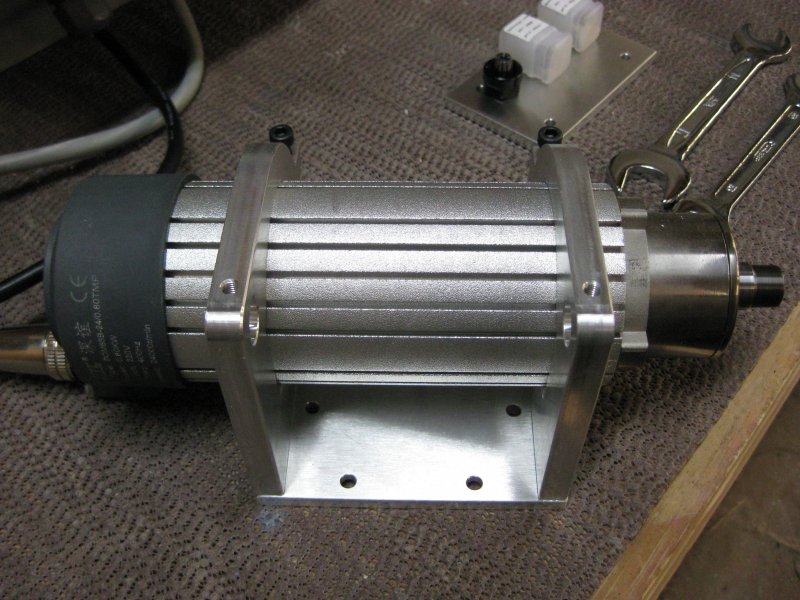

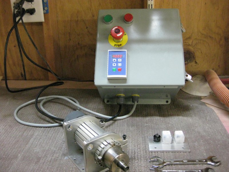

    UPDATE 3/14/2015
    So we've been using the machine hard for about a week now with the new motor on the X installed and it works perfectly. I would like to change out the racks on the Y rails to 20 pressure 20 pitch but I would have to disassemble the entire machine to add them. There isn't enough clearance between the Y axis plate and the extrusion to squeeze the 1/2 think rack in there, I would have to add a 1/8 spacer to all the wheels on the Y plates and either replace the gantry beam with one 1/4" longer or redo the base to squeeze the Y rails in .25 ". So i'm going to wait a bit, the 14.5 pressure 24 pitch rack is doing a fine job anyways plus we are in the process of adding belt reduction drives so both the Y plates and the X drive plate will be redesigned if folks wish to go this route.
    Also IMService CNC stopped selling their Z slides on Ebay, my front gantry plate was pre drilled to accept their slide. The are quite a few others on there that have decent looking Z slides for a reasonable price. So if anyone purchases a plate kit from me, I would advise to figure out your Z slide first and send me something with the mounting hole locations and i'll custom cut that front plate for you. Otherwise if you would just like a blank plate with no mounting holes and drill them yourself that's ok too, just let me know either way when ordering.
    I believe the next project i'm putting in the works is a CNC Plasma cutter, easy to build and I would be able to cut up to 1/2" Aluminum with it or make machine plates out of mild steel.

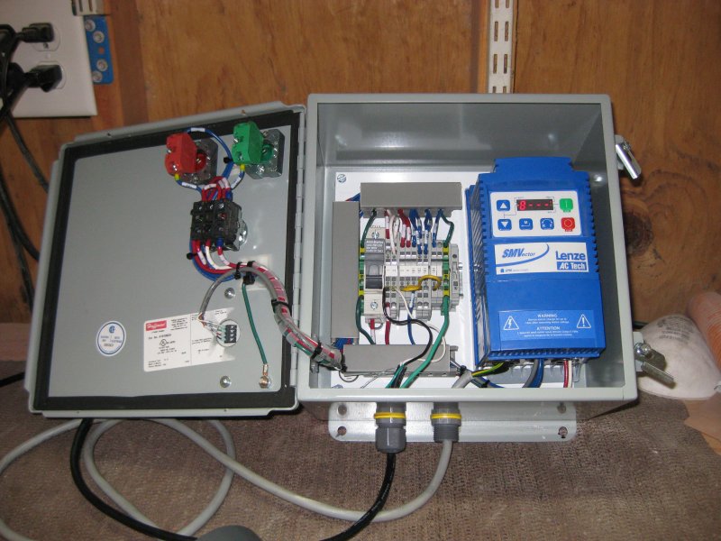

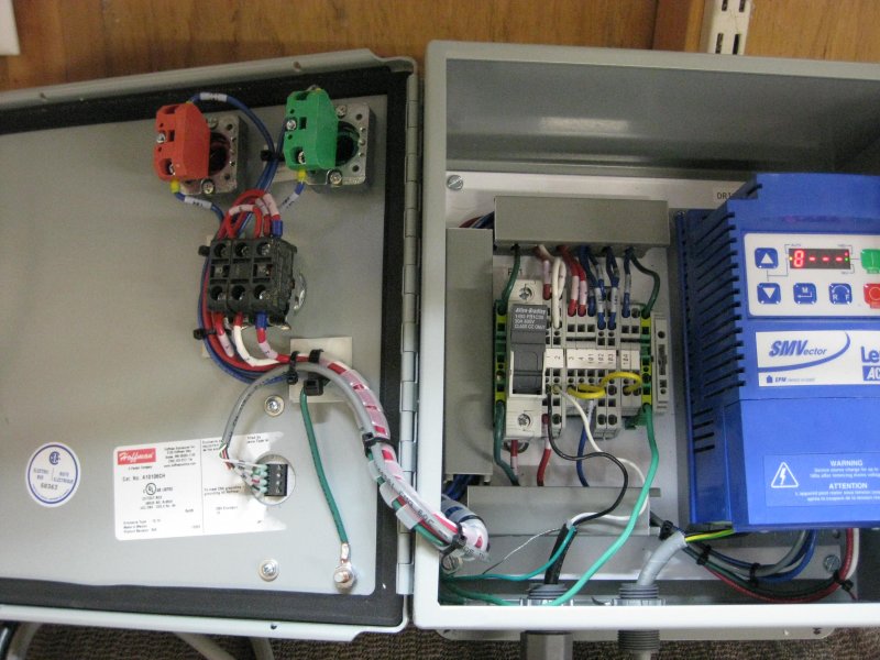

    Also scored a very nice .8kW GMT air cooled spindle with a Laidlaw mount and Lenze SMVector VFD wired up in a nice Nema enclosure.
    [​IMG][​IMG][​IMG][​IMG][​IMG]
    Sweet !! Now to see if I am able to wire this into my existing Plug and Play electronics is the question.... I would really like to be able to control the RPMs from Mach3 but might only be capable of turning it off and on without upgrading the BOB... None the less, love it and will be installing and testing it tomorrow.
    Here's a video of our latest product, nice 3D hat rack... We cut the 3D at full depth running 140ipm with a 1/8 tapered ball nose bit....
    #179 Hytech2k, Mar 14, 2015
    Mark Carew, GrayUK and sgspenceley like this.
  30. sgspenceley
    sgspenceley Veteran
    May 27, 2014
    249
    295
    Nice spindle Gerald! I look forward to hearing how well this works!
    Great looking hat rack and really nice to see the machine hard at work.
