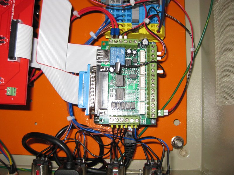

    Does your BOB have a 0-10 analog out or 4-20ma for spindle control? I believe the Lenze will take that. Ive wired and programmed that model a couple of times at work, but its been a few months now. I originally tested my spindle on one of them.
    Most of the time there is a "controlled by" or start source and a speed reference setting to tell it to listen to the 0-10 in from the bob. Also, set the frequency min and max. The min frequency must coinside with the min rpm your motor is rated for. Going slower will start to cook it. The max is freq is usually on the motor. That will be the 100% state of the motor. Monitor your amp draw too. I think that vfd is rated 4A and Im guessing your spindle is 5. I dont know if youll draw that much. Then again there's OCP built in, so nevermind me.
    I figure you already know most of this. Just figured I'd put it down again for others.
    Post the current, rpm, and freq specs of that motor. Tomorrow Ill reference the vfd and post something that should get you started. unless someone beats me to it.

    My BOB does have 0-10V PWM output and a NO relay to start and stop the spindle. If you check the above photos in this thread, the spindle was wired and programmed for the remote and the momentary on/off switches on the front of the control box. Problem is there are a over a hundred programming options and I have no idea how to change it. I just want the BOB to turn the VFD off and on via the relay. I run all my bits at one speed pretty much so if needed I can change the rpms through the remote. I already have the relay set turning on and off with a m3/m5 command, just need to fix the VFD programming. Thanks in advance for your help !!

    Are you using an external ssr or one built into the vfd?
    And did you find the manual.

    I'm using the one built into the BOB, the black and red wires top center goto the relay on the BOB the 2 open connections to the right are 0-10v PWM outputs.
    The reason I chose not to use the PWM output is we're adding a 2w laser onto this machine pretty soon to press it into double duty as a laser engraver so i'm leaving that output open for now.
