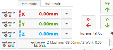

    I had the same rapid movement in which it drilled down into the work piece again. I ran probably 20 jobs and then in the middle of a run, the machine dropped its Z value into the work piece. Should I be homing the machine after each run or doing something in between jobs?

    So your Machine zero is moving, That happens when you run the home sequence, or when GRBL resets. GRBL resets when the power comes on, and when the software connects.
    So if you close and restart OBControl, GRBL resets, and you need to re-home to tell GRBL where home is.
    While we don't have all the features of a pro controller as illustrated in the video below, there are things we CAN do to crosscheck before a job starts,
    After homing and then setting zero for this part on this material, hover your mouse over the display box for the Z number.
    The Machine Coordinate will pop up. Make a note, mental or otherwise, of that number.
    Now, between jobs, you can check that number and make sure it has not changed significantly.
    What is significantly? If you are running the same job across many bits of raw material held in a jig, then it will not change unless you reset Z0 for some reason, maybe if the material is varying in thickness.
    But the change should be within the range of material variations, maybe 1/16" or 1mm or so.
    If it jumps by 10mm+, then rehome and rezero before running the job!
    I know this video uses things we don't have in our software, but the important thing is the thought process "what can I do to ensure this works correctly"
