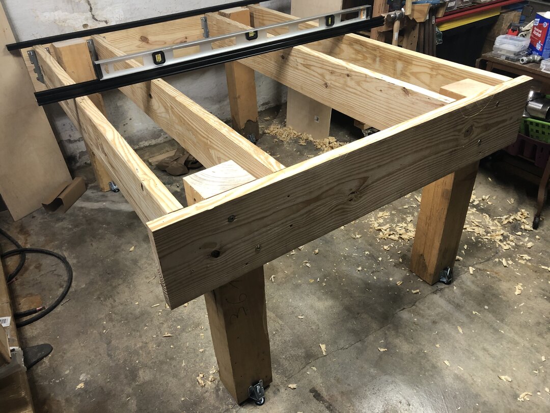

    It's for a heavier and faster machine than a LEAD, but I also don't believe in "too heavy" for benches:
    (From: M4: 1510SS Heavy Mk.I )

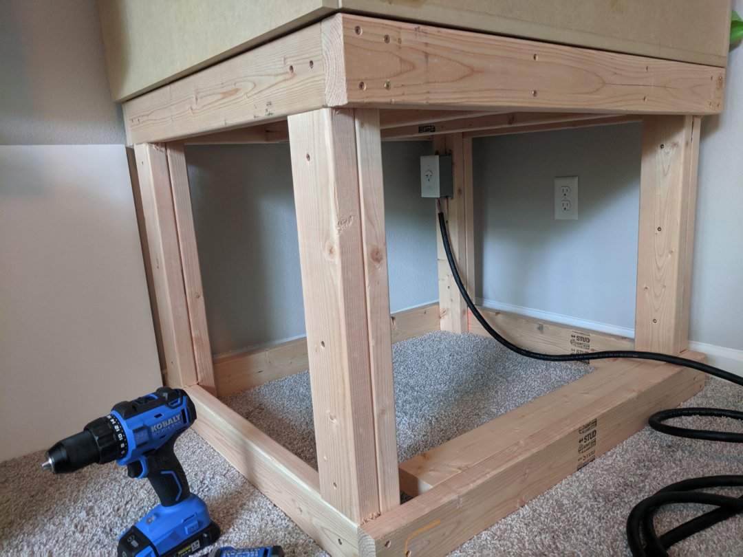

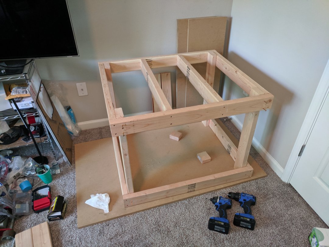

    If you need something a little lighter duty than Rob's. Ultimately, it depends on what you want to spend, how much work you want to put in, and what tools you have.
    (From: KRE Mill V3) < That's just me messing with Rob XD.

    Ha! This is a nice design- I've added more lower framing to mine in the meantime too, don't want it racking- though I'd want to add a lot more weight. 2x4s are pretty light and can be fairly resonant, which doesn't play nice with steppers. Rigidity is always good, but with moving parts you also want mass and damping. Tying the machine to the table, you want a poor power transfer by significantly different inertial masses, but also don't want reflections back into the machine, hence the damping. Fir studs "ding" a lot more when you hit them, vs. Southern Yellow Pine's nice dull "thud".
    And I quoted the exact post it came from, because there were more pictures to look at if OP was interested, so nyehhh. :D
