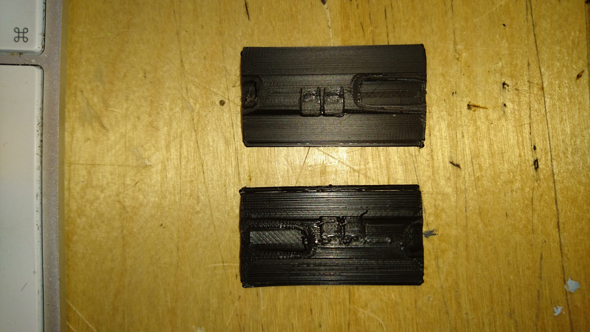

    What ive noticed is a HUGE difference of print quality between printing an item horizontal or vertical (x or y speaking, NOT z). Check this out, both prints at 200micron but one seems HIGH resolution, while they're the same file just positioned different (please note both items are really tiny, pics are with macro on):
    Also note the first pic, seems print head leaves a mark on them before finishing the print.... Definetly shitful gcode generator in these printers!
