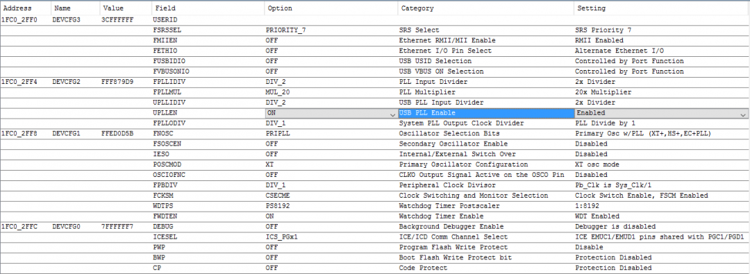

    So, now, since we can modify Hex file and put correct checksum in there, I think we can try to use background debugger.
    Here is the current config:
    Background debug is disabled, but it is easy to change and write back to printer.
    I don't have my picikt3 yet, once I have it, I will try it myself.

    Oh if you even can flash the firmware, here are the last two lines of the .hex:
    :102FF000FFFFFF3CD979F8FF5B0DEDFFF6FFFF7F88
    :00000001FF
    The big line is the config registers, I enabled the debugger.
    Put those instead the last two ones in the .hex and flash to the PIC. You should have debugging capability with PicKit

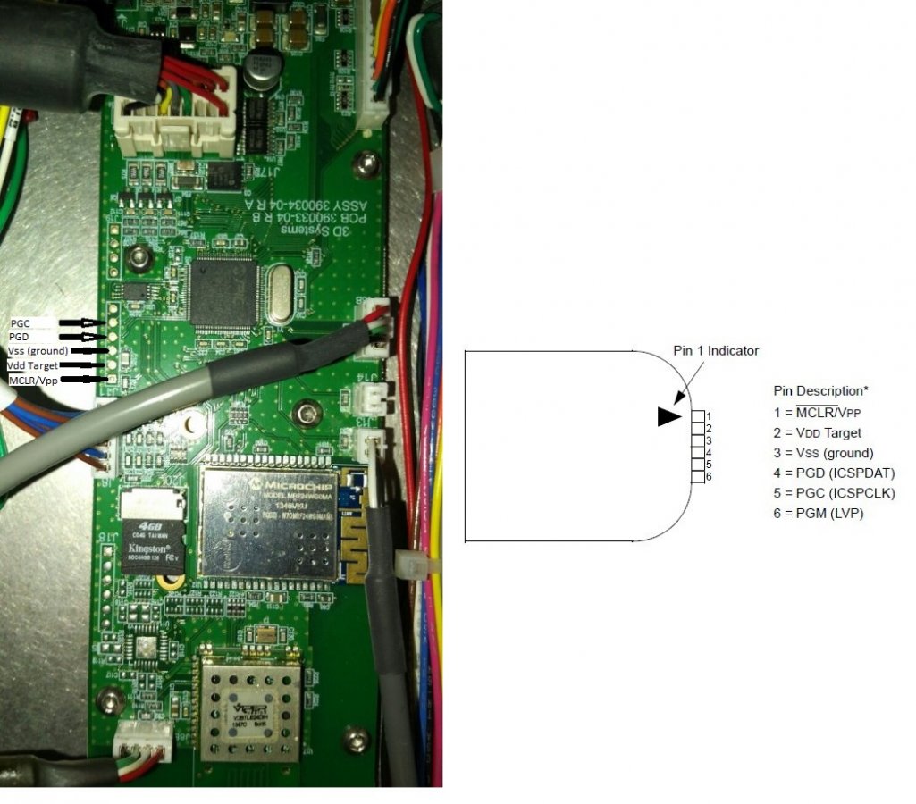

    Bu the way, can you share your experience connecting to the mainboard? What tools/software/configuration I need to have? I remember Geezer70 said that there was a problem with MEMCLR being pinned to low. What to do with it? I don't even know if I need to connect all 6 wires, complete newbie in the PIC32 in general, so help would be appreciated.

    Ok. I will post some pics of the connection, but will be tomorrow. I dont have any problems with pin out. Just connected the Chipkit cable to a header which i soldered in place.
    The config code for debugging is working. I can set breakpoints etc.

    Attached is the connection diagram for the Pickit 3.5. I did get the 3.5 Version which should be more stable in regards of power the chips. Thx Geezer70 for the Pinout. He told me how to connect the pickit.

    Thanks so much for the info! My PicKit3 is here, so I guess I am soldering the header tomorrow! :) Just a few quick questions, sorry if it is stupid.
    Should I power the system or PicKit3 will power the chip? Should I connect Pin 6, (PGM/LVP), or it should not be connected?

    I did connect pin 6.
    You can Power the Board from the pickit. You have to set it in the options. You can also Power the Board normaly and write the firmware without the Power Option of the pickit.
    I did both without issues on my cubepro. (Same Board).
