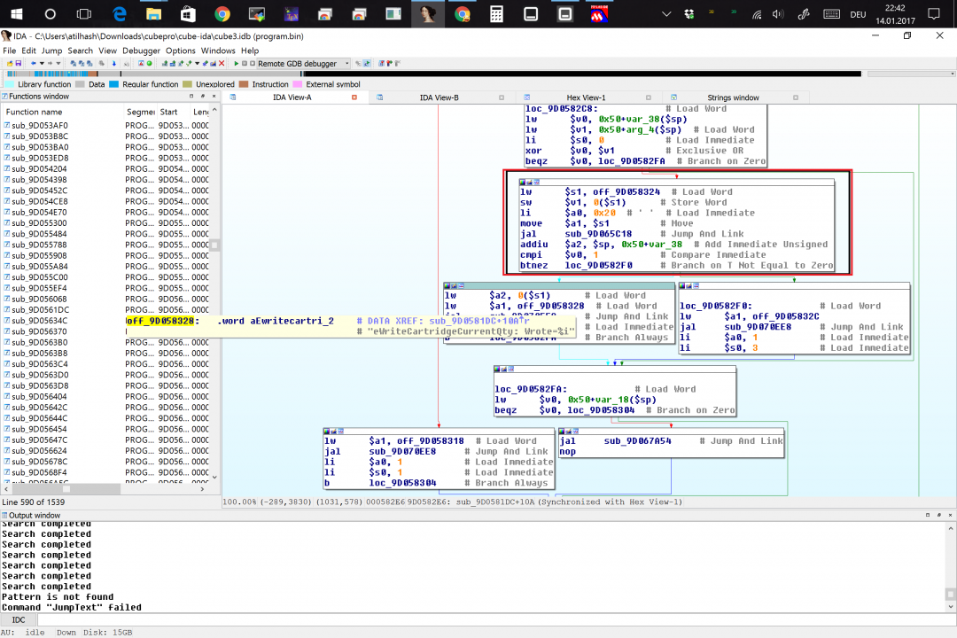

    Ok some update for you all.
    This is the write routine when you start a print. I did succeed in stopping the wri[ing process. But cartridge removed error is popping up after 30 seconds.
    #466 eychei, Jan 15, 2017

    There is likely a confirm step that it has written successfully.

    Here is a goody for all of you.

    What is the idea behind your mod?

    @Tom Dirriwachter
    Sorry. What do you mean?
    I did modify the firmware so it does not write the Cartridges. So it will stay at the percentage it is on.
    You can feed your own filament now without worrying about the chip itself.

    Yes i did find a routine in which it was reading the cartridge and then going to the write process. The read routine did have some jumps and calls so i patched what i could find.
    But now i am down to 2 patches.
