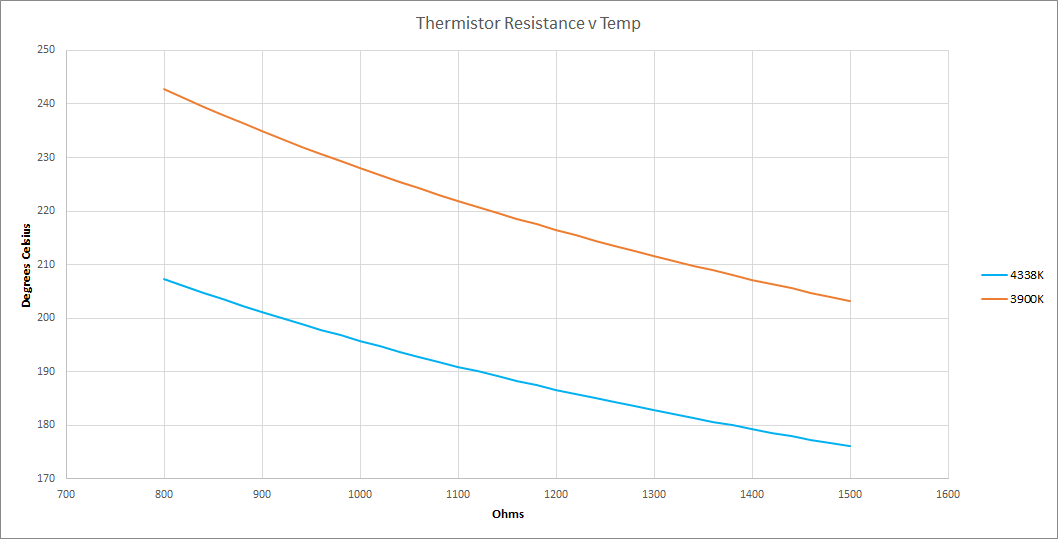

  15. Razor1000
    Razor1000 New
    Sep 25, 2016
    43
    Hmm, I should graph the temp slope for these and see if that's an increase or decrease in temp. If that's a 100 Ohm difference around 200C, that would be about a 10C increase... which is what I think is the temp increase needed to stop all the nozzle clogs!
  16. Razor1000
    Razor1000 New
    Sep 25, 2016
    43
    I think you're going to be disappointed with 3900k replacements. I found the function for finding a specific temp/resistance of a thermistor using the Beta and 1 other set of R/T values. The resistance for the 4338K Semitec @ 200C is around 900 Ohm. At the same temp, the 3900K is almost twice that resistance.
    (I found the formula on Daycounter:
    Steinhart-Hart Thermistor Calculator
    it's the 4th one down)
  17. Kiza
    Kiza New
    Dec 1, 2016
    75
    Interesting find! Anyway, the ones I bought are 3900 at 25/50 C, and GT-2/NT-4 are 4338 at 25/85 C. Little bit confusing, so I am still waiting for them to arrive from China. Will try to compare the readings once I have them.

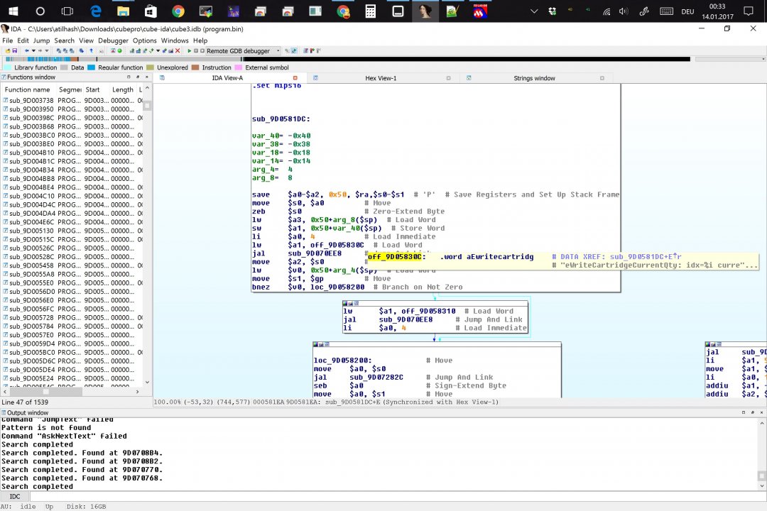

  28. maicon
    maicon New
    Feb 28, 2017
    Hi, before I want to congratulate you, you've done a great job with the firmware for cubepro, I need your help about the image695.hex file, how do you do for debug?, do you think that Can I modify the versión firmware for install all characteristic of cubepro 2 into cubepro 1.
    I just open de firmware in IDA.
    thanks and best regards.
