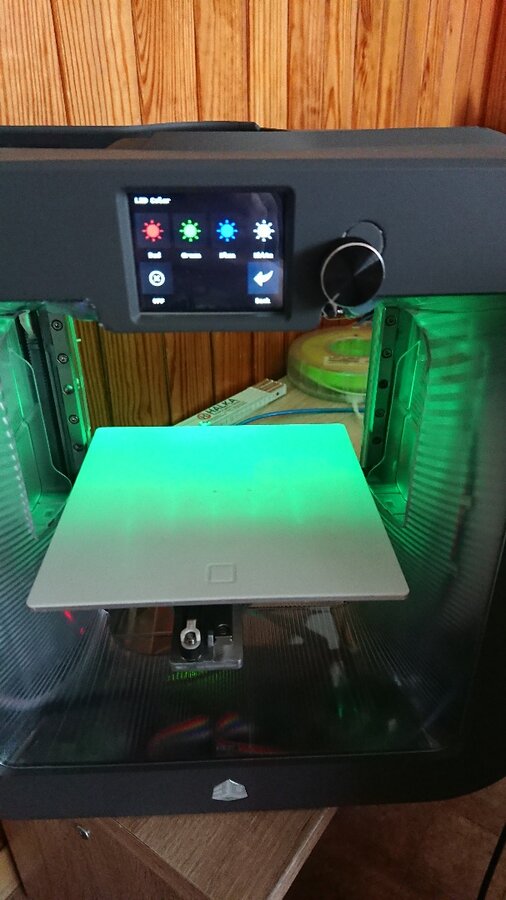

  7. loco
    loco New
    Dec 6, 2016
    My cube 3
  8. loco
    loco New
    Dec 6, 2016
    More photos
  9. loco
    loco New
    Dec 6, 2016
    Other

  12. loco
    loco New
    Dec 6, 2016
    I will put some pictures. Step by step but I don't want to do any hole I will install a new blowen whit a volcano
  13. loco
    loco New
    Dec 6, 2016
    Also I put arduino mega whit ramps 1.4
  14. loco
    loco New
    Dec 6, 2016
    More pictuares

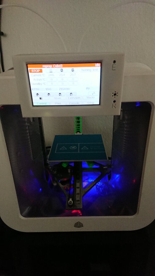

  22. R4ZOR81
    R4ZOR81 New
    Feb 29, 2020

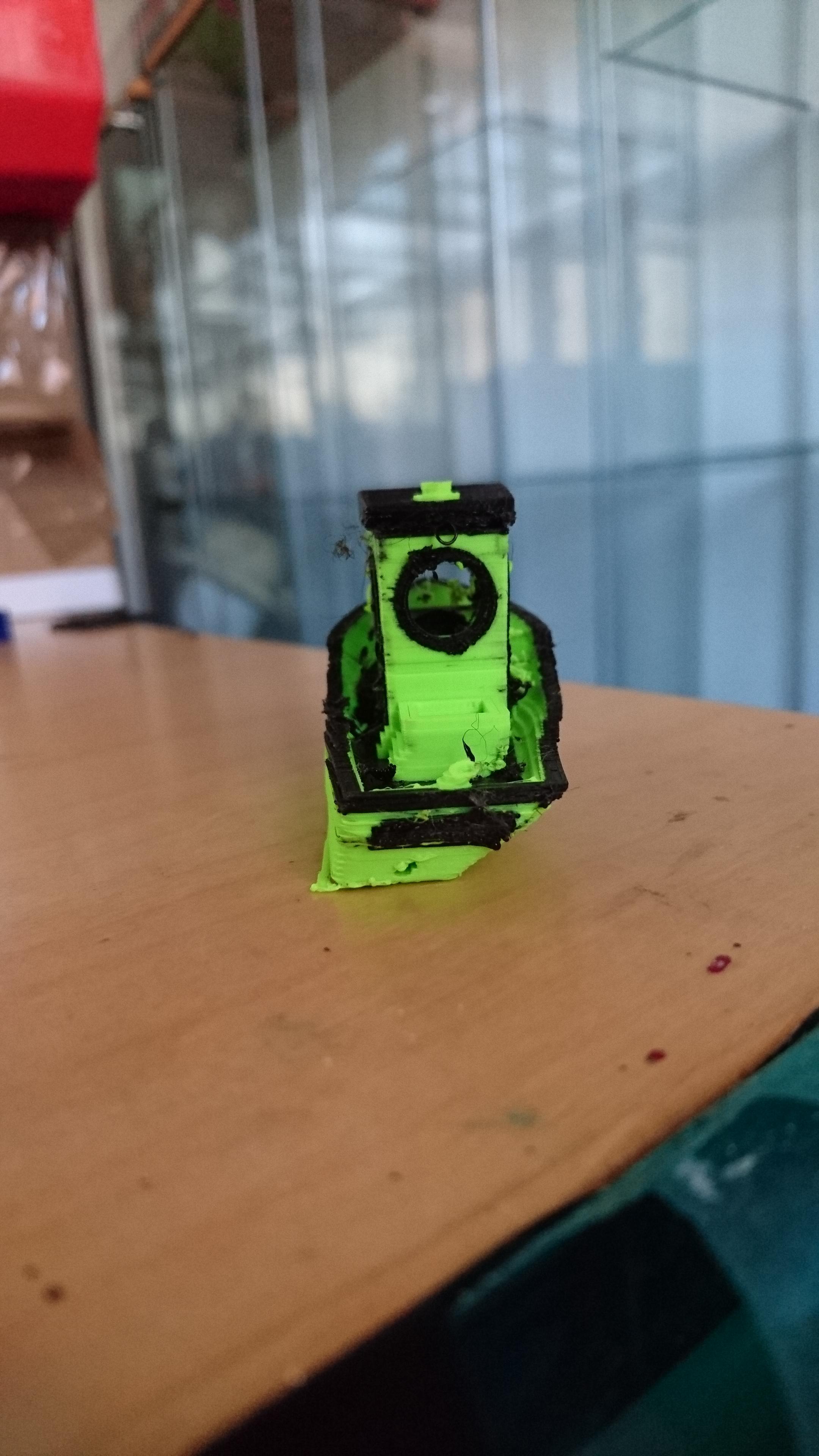

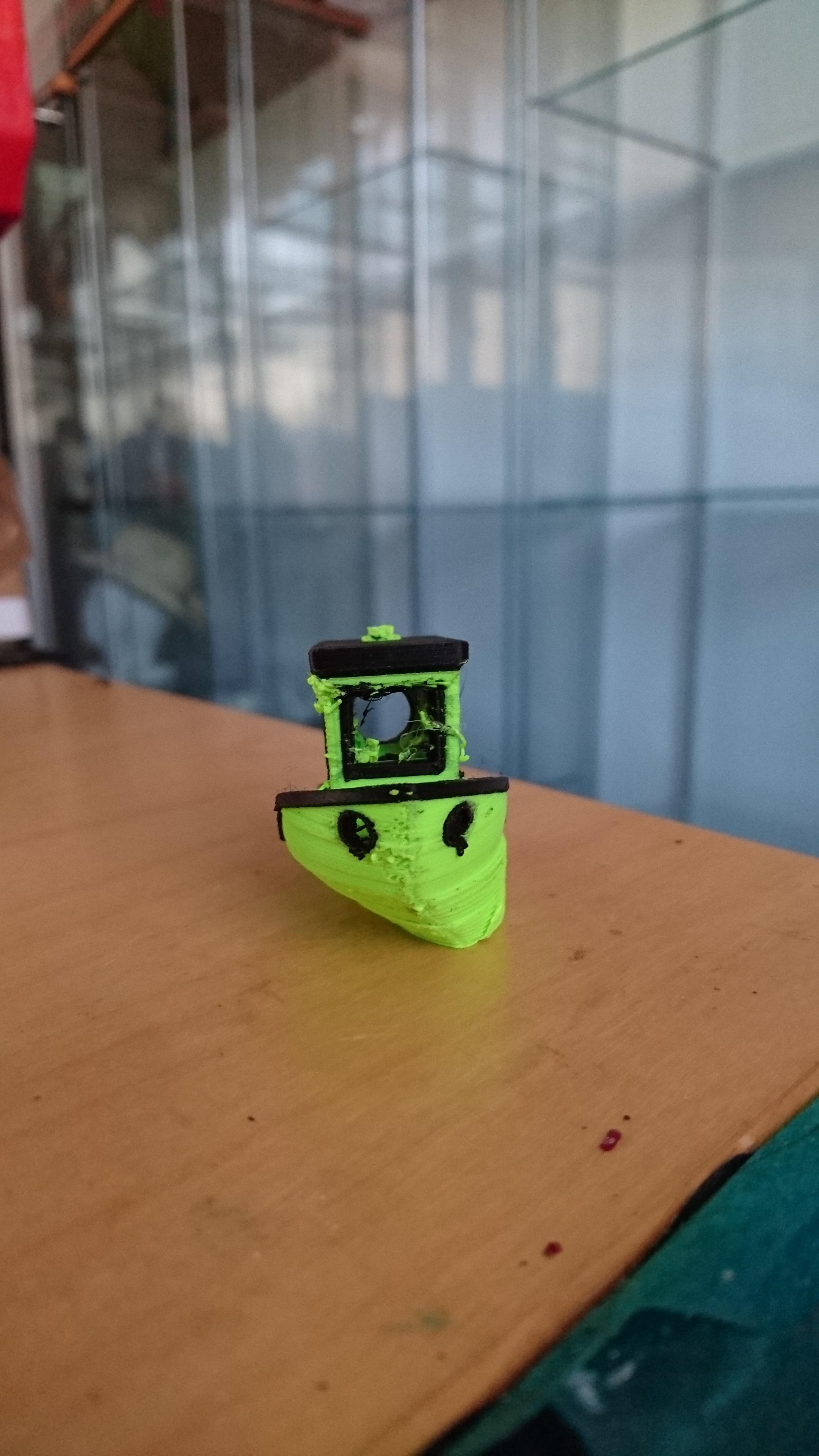

  27. Alian
    Alian New
    Sep 19, 2022
    I'd say bad bed adhesion. Instead of using glue, use masking tape instead. I use the older type masking tape... not blue or green. When I don't use it the parts lift off the bed and it looks similar to these pics.
