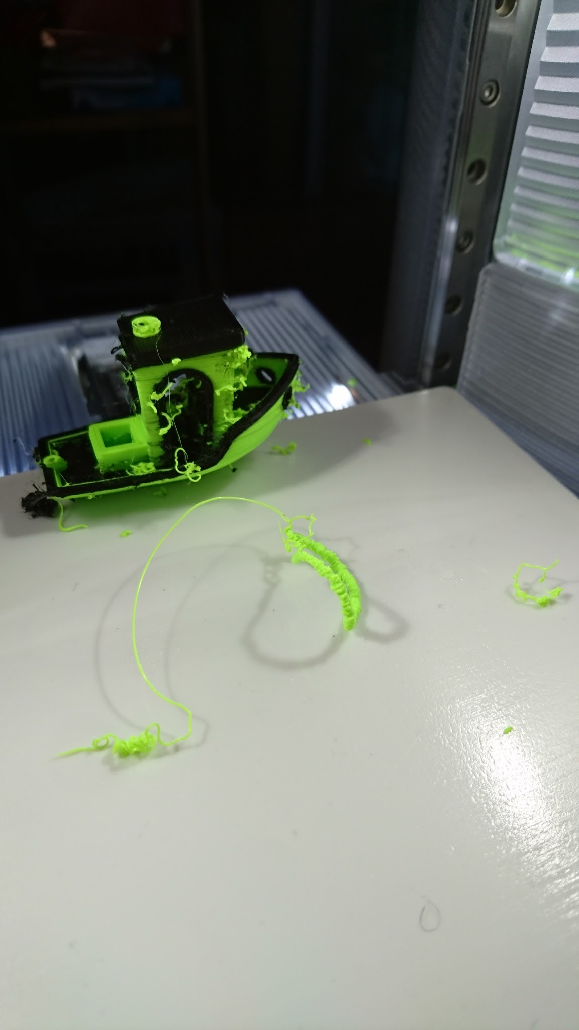

    Now the printingontheedge thing got me worried.... i do recall the very first test print was on the edge too, then i sliced benchy and in the meantime upgraded firmware....but benchy got printed on the edge too :?
  17. jerdavis
    jerdavis New
    Oct 25, 2016
    I had one part randomly get printed on the edge. Everything else has been centered. Not sure what happened there. Running latest firmware and cube print app on Mac OS right now.

    Im on latest firmware and software as well...
    And I do understand why they discontinued them... First print out of the box is quite....shameful.

    Its even worse when you remove it from the bed lol
