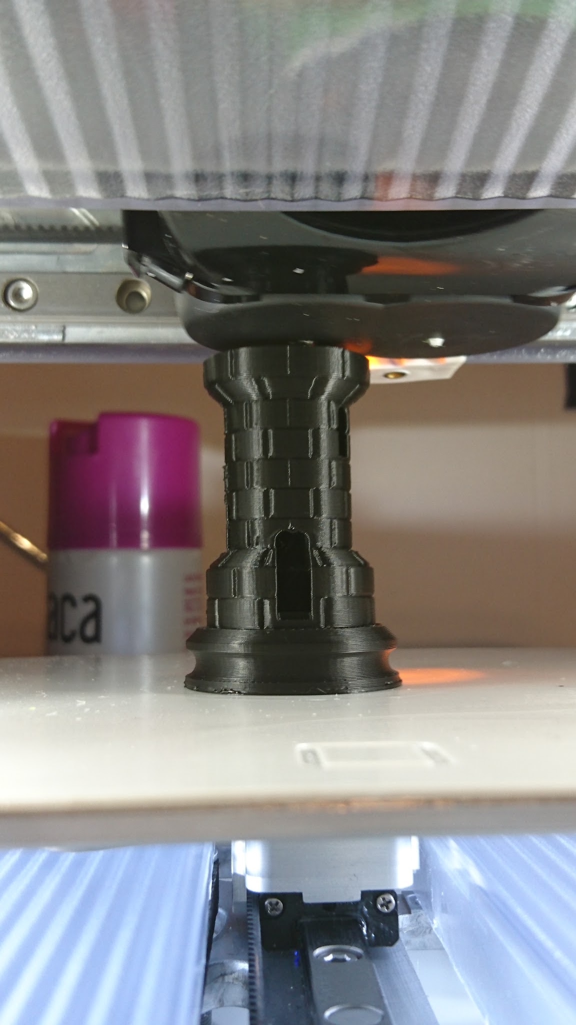

    No joy, your rook file prints at the edge as well :(

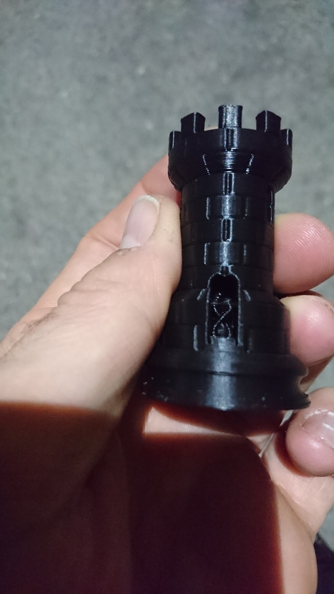

    Hmmmmm I just re-reflashed once again the printer to 1.14B and started a new print. It seems now its printing centered....But what I actually think that happens is that the bed this time was all moved backward before starting the print, hence the printer "centers" it. This apparently wont happen if the bed was all at the front position. Can anyone check theirs?
  22. bolsoncerrado
    bolsoncerrado Well-Known
    Nov 8, 2016
    229
    OK now Im speechless!
    From the producers of....
    THE MOST... (pic 1)
    GRUESOME... (pic 2)
    BENCHY PRINT! (pic 3)
    now coming to a theater near you....
    THE ROOK!
    Looks like the night and day, two different printers.... but it's the SAME one!
    The only two things I did:
    1) Tried to re-reflash the 1.14B firmware with the SAME 1.14B firmware of the SAME file of the SAME USB I used initially on the printer after recieving it. It proceeded as usual.
    2) Tried the rook file uploaded by you created on Windows instead of a Mac.
    YOu know the rest of the story now!
    Just wow.
    I really thought my printer came with severe hardware deffects out of the box....but.....wow!

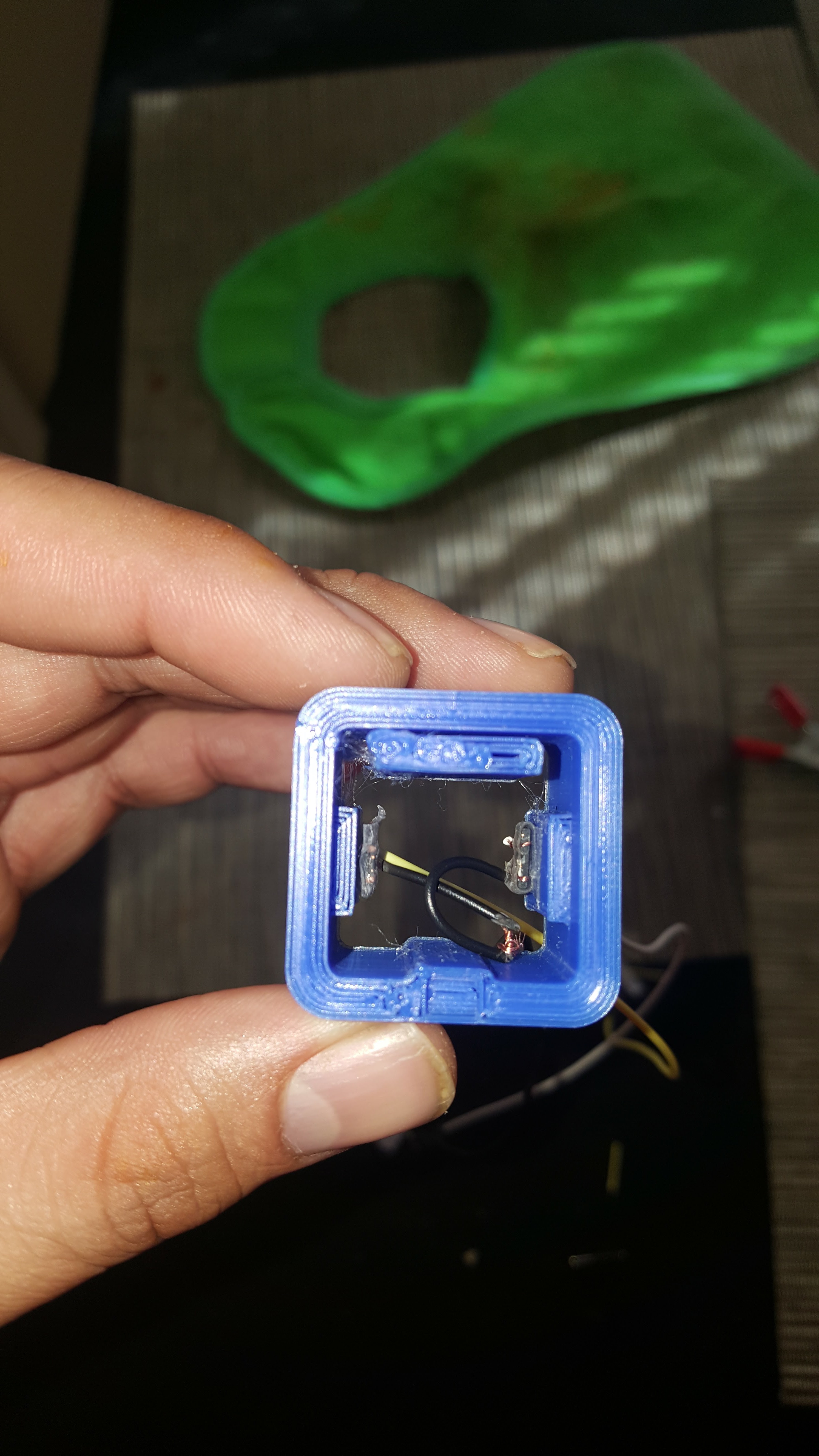

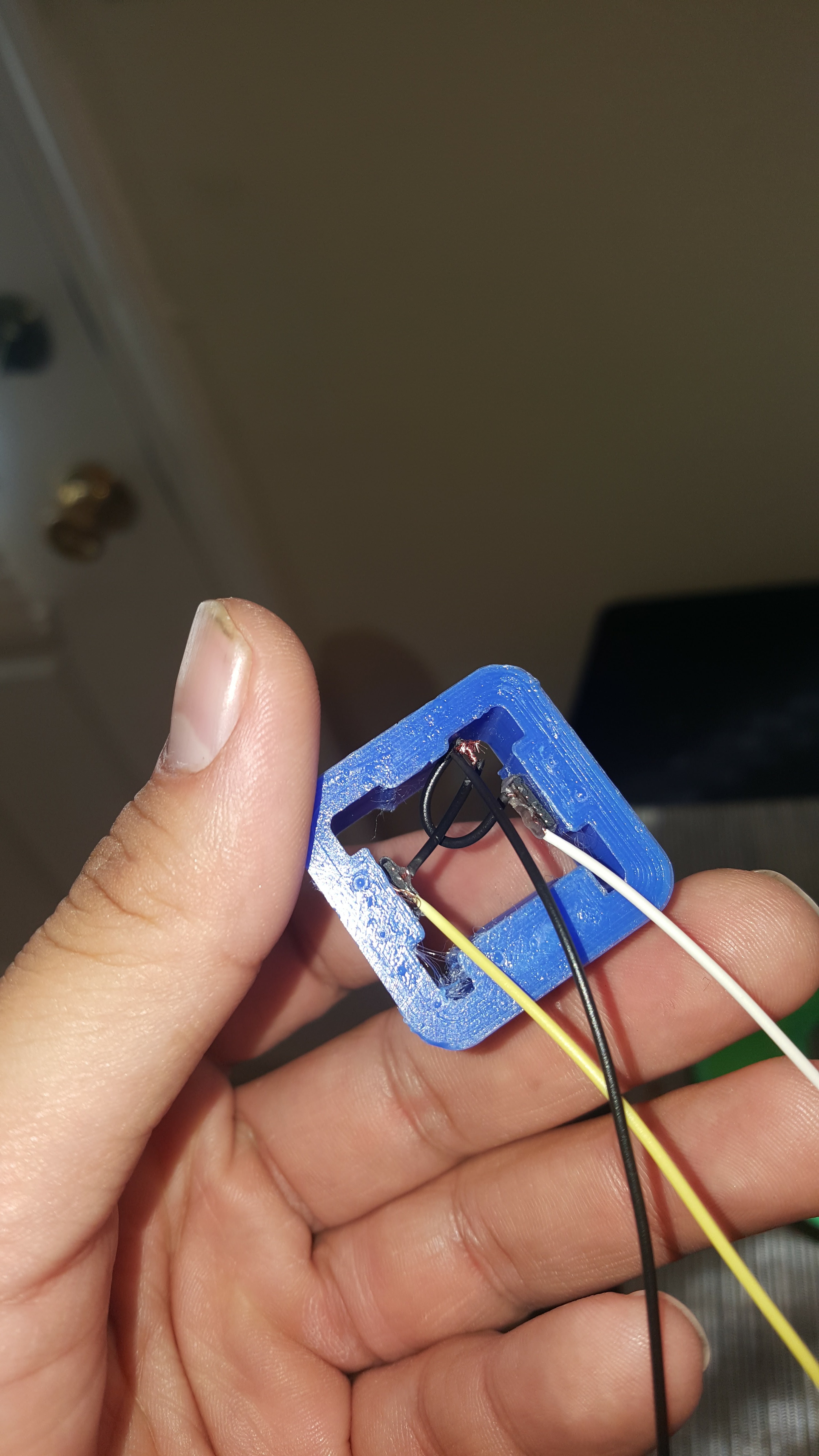

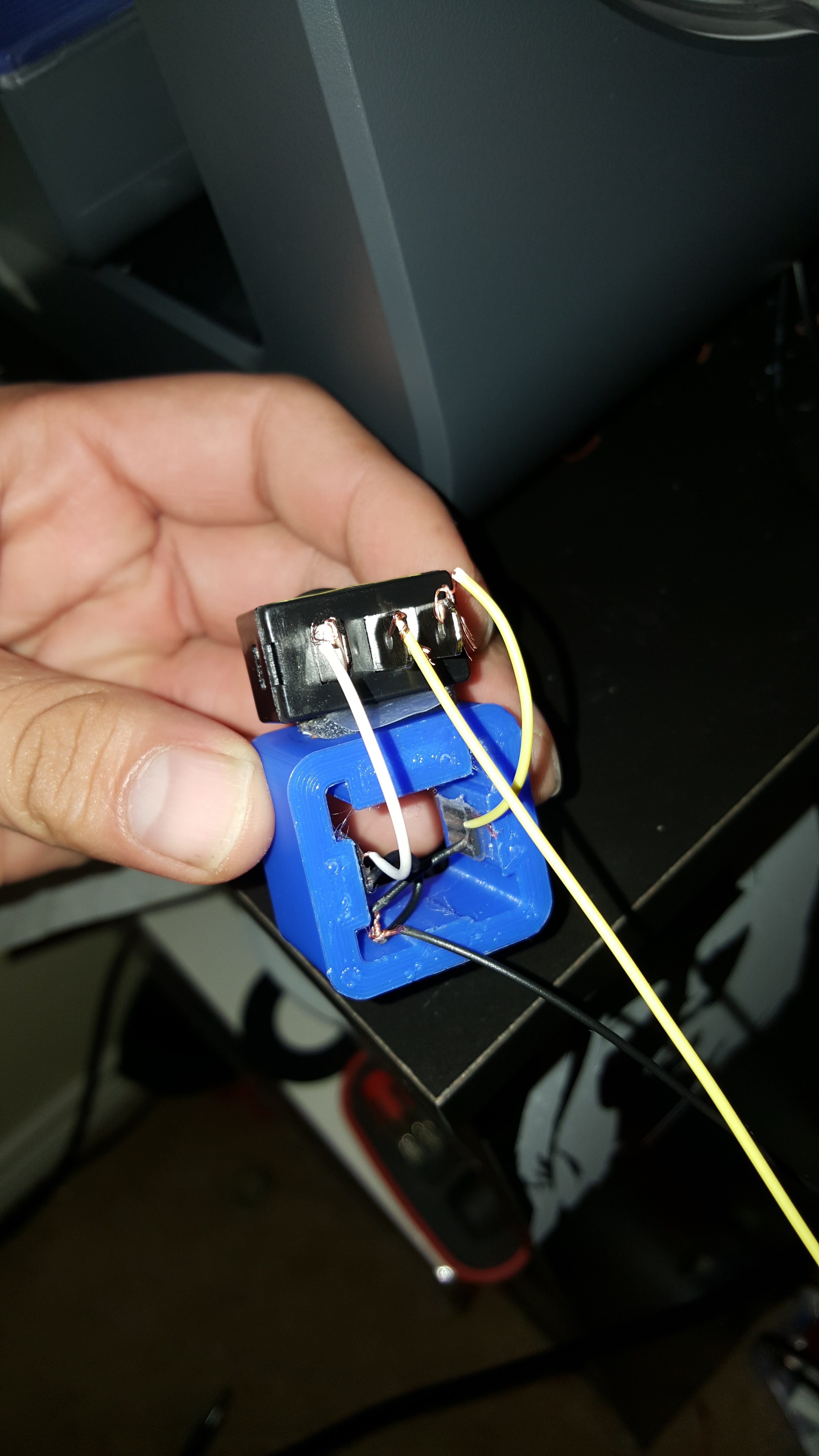

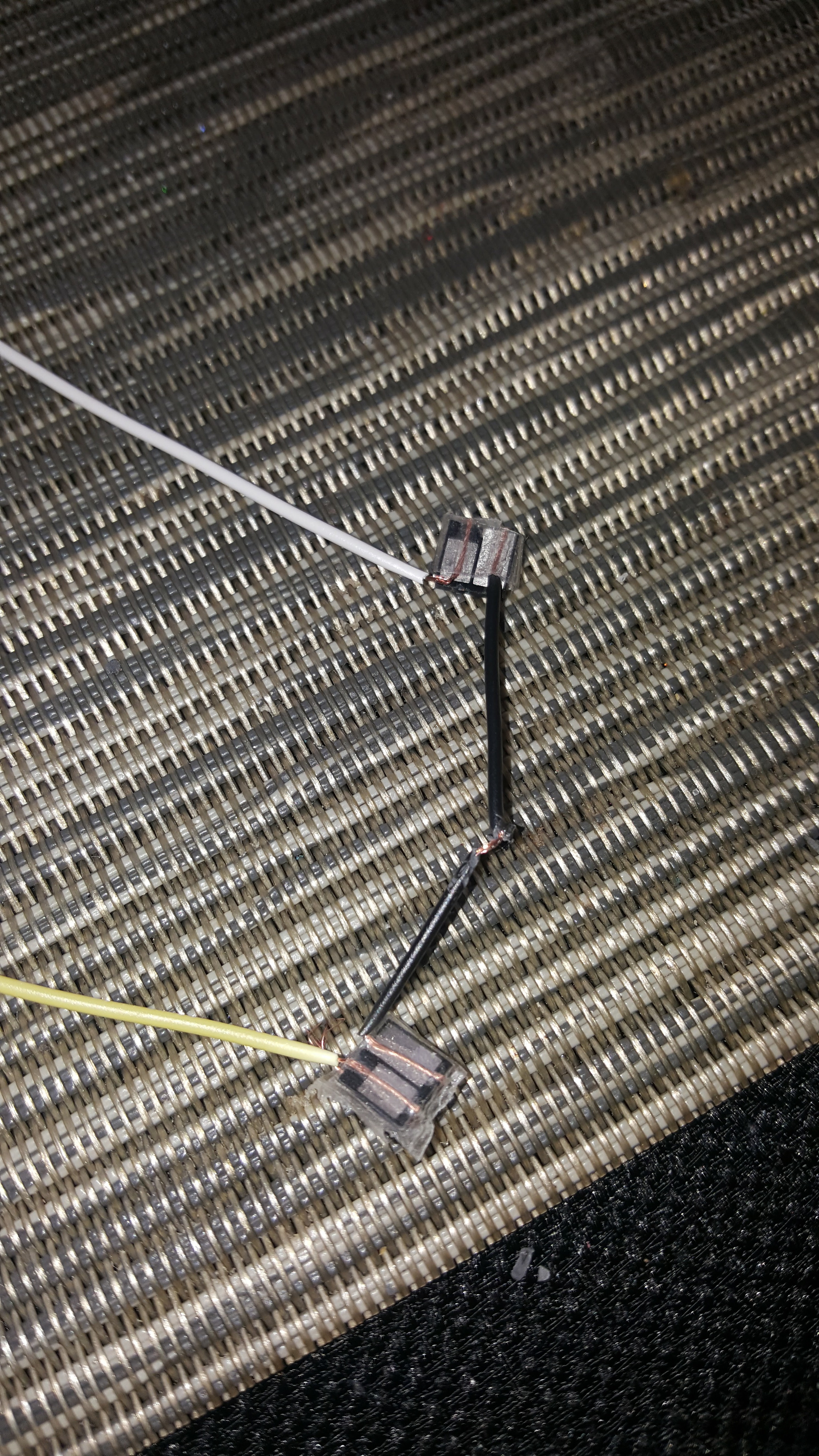

    ALso there's a swap chip method based on a switch which relies on 2 used chips wired to the switch like this:
    Basically you need a 3% chip and a 0% chip and swap them using the switch when printer warns you about low filament.

    Nice. And you just ran the wires back to the contacts on the outside under the cartridge?
    Any trick to removing the chips? I haven't tried yet, worried about breaking them though. Do they pop off pretty easily?
    As for the crack, I just tipped the cube back a bit and looked behind the print head. I could see a line radiating out from one of the cap screws, so it looks like it got over torqued.
    bolsoncerrado likes this.

    I'll check my head tomorrow... pics and method are not mine but I guess it works, there are a couple youtube vips proving it.

    Where'd you find those pics? I've seen the YouTube video, but hadn't seen those pics before. Curious what other research I've missed. The Wikia is a good idea, btw.
  28. bolsoncerrado
    Nov 8, 2016
    229
    I got them emailed by one of those youtubers

    The chips are just glued in place, they pop off with a little elbow grease.
