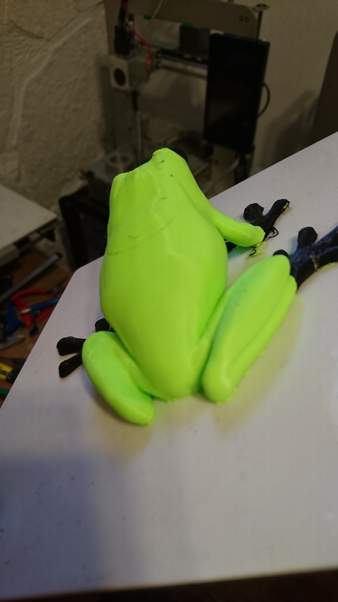

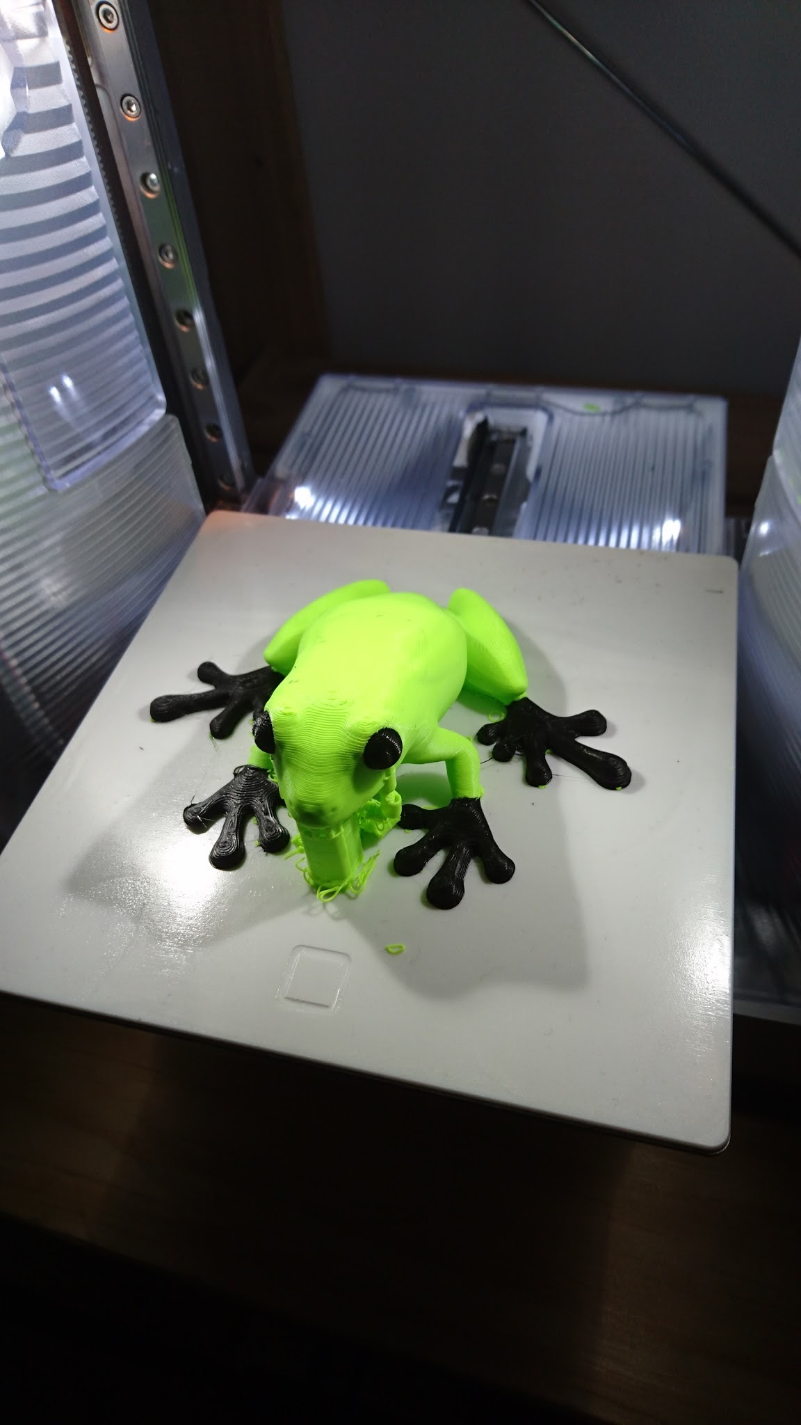

    btw last night print in dual color:
    Taking into account that pics with cameras tend to maximize defect, this was a near perfect print!
    For one, the back and tummy of the frog is so smooth you cant even feel the layers at 200 micron! After having messed with quite a variety of 3D printers at print3dforum.com I can say its one of the smoothest finishes "out of the box" i've ever gotten!
    Unfortunately there was some "color contamination" in it, which I guess it has to do with the algorythm that creates the gcode to purge enough material to keep them clear....
    On the down side, supports are really hard to remove, and there's a section of supports generated right in the frog eyes that are as solid as the frog itself, denaturalizing its "eye looking" up to a point the frog seems to be crying lol
    I'm now more anxious to get hands on the chip technique and try more colors.
    BTW, can you get dual color printing on a raped Cube?
