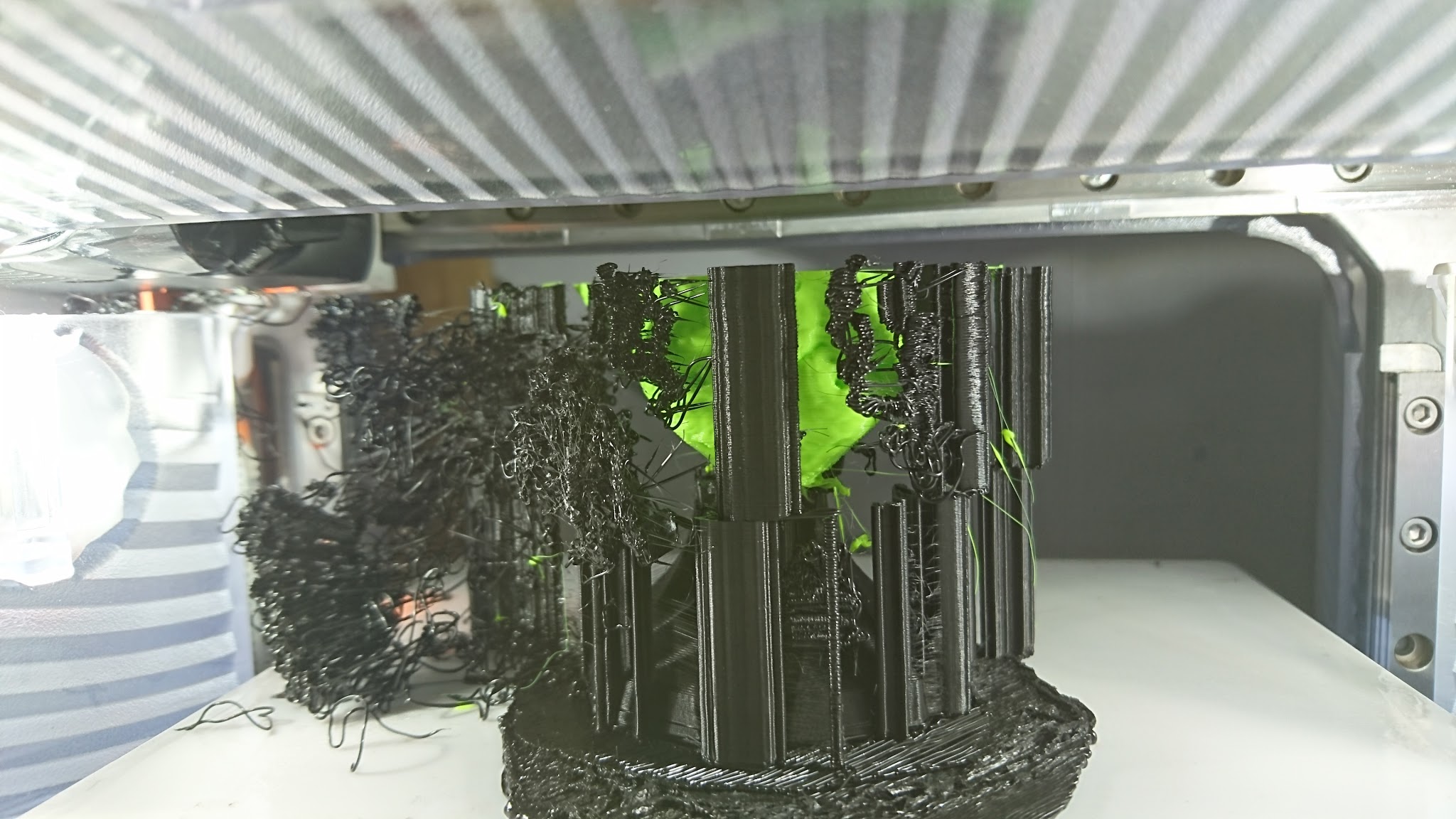

    now the following is a case worth to be studied loL!
    i havent stopped the print yet because so far its getting good lol but if you notice it, BLACK filament which prints a pedestal and the supports missed some steps while the green HAS NOT! LOL
