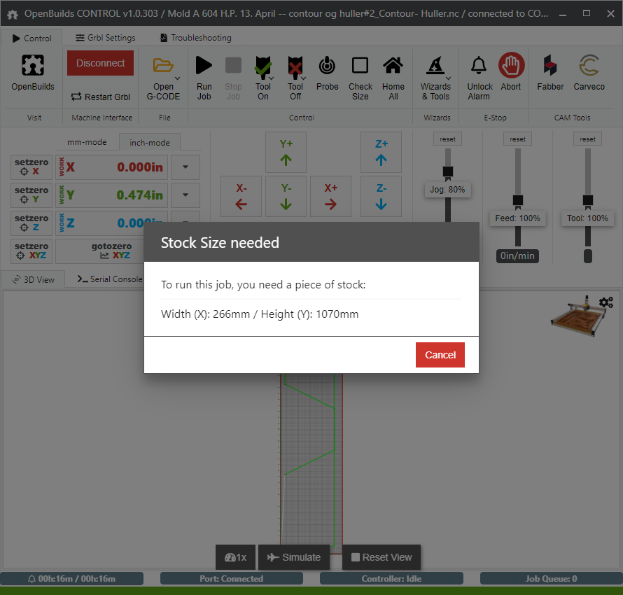

  12. Jimc137
    Jimc137 New
    Nov 24, 2022
    I am new to Macros so I tried this one but when it ran, the units were in inches (which was fine) but there were 15 decimals! Is there a way to round it off to 2 decimal places or even a fraction?
  13. Peter Van Der Walt
    15,601
    4,448
    Yes, you can append toFixed(2) to values where you need it: JavaScript toFixed() Method

  15. Jimc137
    Jimc137 New
    Nov 24, 2022
    I appreciate your quick reply, but I am still a little lost. From the little I recall about JAVAscript, you said that with the toFixed() method, I need to set the output variable to a fixed # of decimals but I am not sure what the variable is or where to add the function in the macro.
  16. Misterg
    Misterg Veteran
    Aug 27, 2022
    416
    330
    I think you would add it as follows, but note that I haven't tested this.
    Code:
    if (typeof object !== 'undefined') {
       var string = ""
       if (object.userData.inch) {
           string += "Width (X): " + (object.userData.bbbox2.max.x - object.userData.bbbox2.min.x).toFixed(2)+ "inch" + " / " + "Height (Y): " + (object.userData.bbbox2.max.y - object.userData.bbbox2.min.y).toFixed(2) + "inch";
       } else {
           string += "Width (X): " + (object.userData.bbbox2.max.x - object.userData.bbbox2.min.x).toFixed(0) + "mm" + " / " + "Height (Y): " + (object.userData.bbbox2.max.y - object.userData.bbbox2.min.y).toFixed(0) + "mm";
       console.log(string)
       Metro.dialog.create({
           title: "Stock Size needed",
           clsDialog: "dark",
           content: `
              To run this job, you need a piece of stock:<hr>
              ` + string + `
           actions: [{
               caption: "Cancel",
               cls: "js-dialog-close alert",

    Hi, thanks for the feedback - it should preserve the Z height (it does for me) - if you have Z0 set at the waste board with the old tool, the Z0 will still be at the wasteboard with the new tool, even though it might have a different length - likewise if Z0 is set on top of the stock (or anywhere else), then the tip of the new tool will be at the same place.
    I have been using it this way for a while now, and it has worked OK. I wonder if there may be some subtle differences in the way that we're using it?
  27. Martin wade
    Dec 18, 2018
    Maybe. Having said all that I think I just realized that I was doing this without an actual piece of stock. Give me a few minutes and I’ll get back to you.
  28. Martin wade
    Dec 18, 2018
    Ok my apologies. It does work. I’m not not sure what I was thinking. Hit the top of stock perfectly. Not enough coffee I guess. Keep up the good work. I am gonna try with the homed status set to yes.
    Misterg likes this.
  29. Misterg
    Misterg Veteran
    Aug 27, 2022
    416
    330
    Glad to hear that! :)
    As I said, I’ve used it quite a bit recently, and have even started to trust it!
  30. Martin wade
    Dec 18, 2018
    well I'm almost there. As i said before my machine was out of service for a couple of weeks. so just getting back to it. Thanks for your patience. I'm gonna share this macro with my group of cnc-ers at BobsCNC. you get all the credit.
    Misterg likes this.
