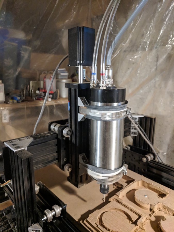

    I agree the MDF is not the best material in this use case, I think you guys are way over thinking it.
    Given that 4 open-wheels are all that supports the whole Z axis those will fail long before 4 M5 bolts fail in shear or the mdf splits when it's compressed by those same M5 bolts.
    These machines are "squishy" polycarb wheels supported by M5 bolts in cantilever fashion running on aluminum extrusions!
    Give him a chance to tram, which "close enough" will do just fine in this case, and get to making chips!
    I cut my first set of 1/2" aluminum hoops with an HDPE and hose clamp mount that people told me would not work, and then I cut a second set with the first set as I wanted them to be stronger at the clamp bolt area.
    You can see the first set on the spoil-board. I've since cut a bunch of aluminum with these making a whole new Z and X axis plates.

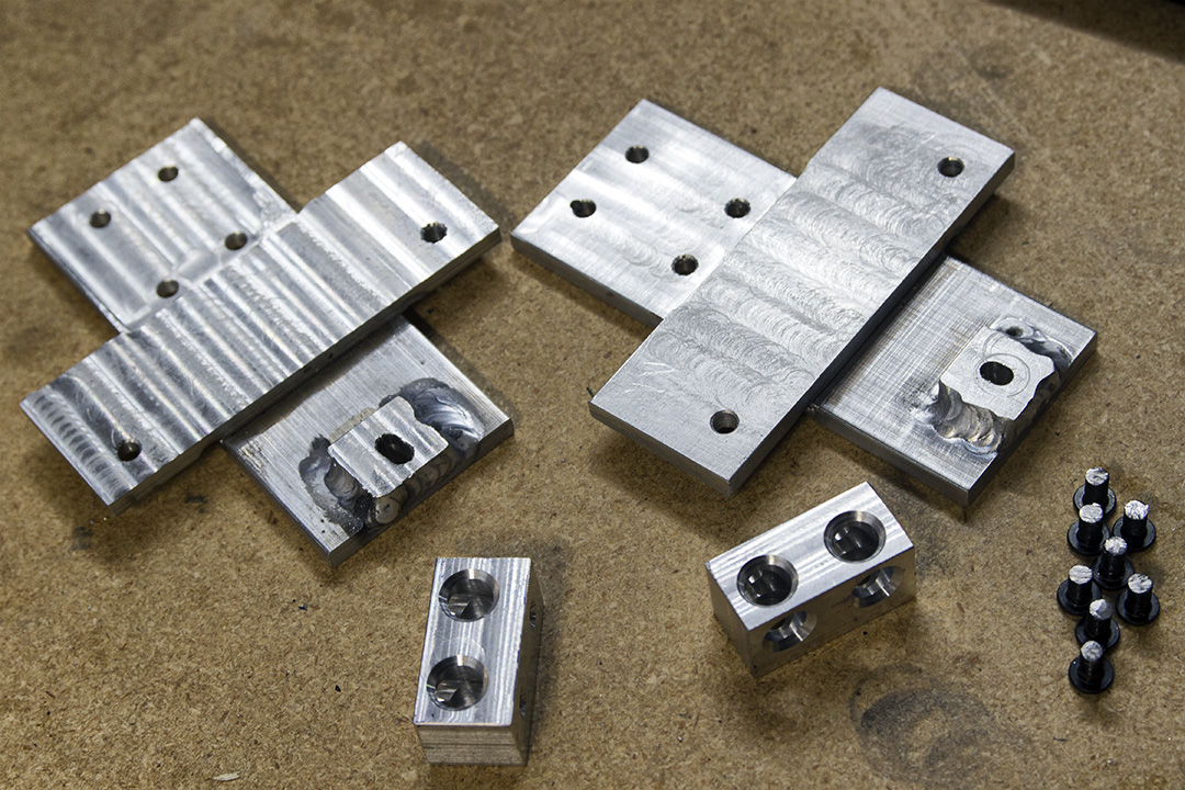

    Ok, I'm finally trying to get back to this- it's just so easy to get distracted when you're having so much fun cleaning up after failed hard drives. So... time for some catchup.
    First:

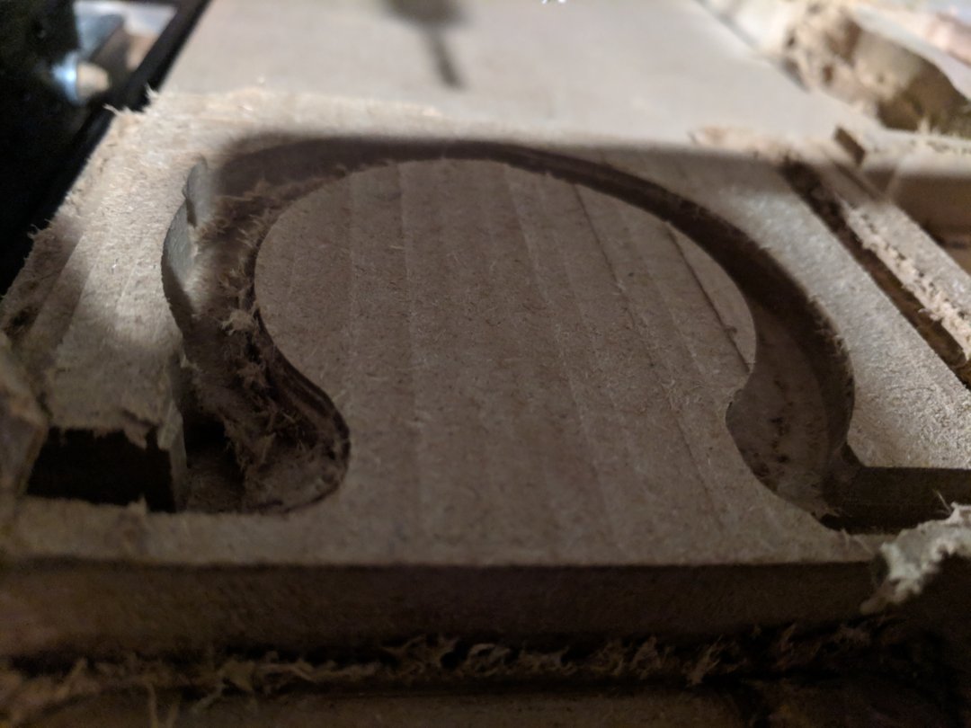

    MDF. Yes, it's squishy, unsuitable, and altogether tacky - thus the fact that it was never meant to be more than a temporary mount to cut something more suitable out of something more suitable. Continuing to discuss it's appropriateness is (and has been) just a distraction at this point.

    I don't think variables are really an issue at this stage - or at least not a significant one. Rubber's squishy, but there's a lot less there than it looks like - it's a single thickness of maybe .05" thick before being compressed, so it's not a significant contributor. MDF may squish & flex under load, but for the load produced by a dial indicator - or even the dusting cut on (other) MDF that started me on the adjustability kick in the first place - it might as well be a rigid body. The issue isn't even that the spindle is currently crooked on the MDF mount - it is, certainly, but less than it initially was, and little enough that I'm not concerned about it for cutting the next version.
    The problem I'm hung up on right now is that the spindle is going to be crooked on the next version for exactly the same reason it's crooked on this one: because while I can measure said crookedness, I don't have fine enough control over the position to actually correct it. It doesn't matter whether I make the final (or not-quite-final, or next) version out of aluminum, or delrin, or hardwood, or plywood, or more MDF when I can't control precisely where the drop-in T-nuts are going to pull the mount as they tighten, or adjust the mount and/or spindle afterwards to compensate. I suspect using standard T-nuts would cause less movement, but considering the hassle of disassembling the axis to get them in, it'll probably take more than "I think I might improve things incrementally" before I find the motivation to try.
    Yeah, probably without those - instead of making the mount easier to adjust post-assembly than the current design, the holes behind the spindle would make it impossible (also, there are four slots in the rail, not three... but who's counting?)
    Also, I may be misinterpreting the picture, but I'm not so sure about those square bosses. I'm assuming they're meant to ride in the slots for alignment (since if the drop-in T-nuts are going to tighten properly, the bosses would have to be somewhere less than .04" tall & lending little bossy strength to the holes). To make any difference in alignment, though, they seem like they'd have to be precisely mated to the V-slots - at which point adjusting for your-B axial twist becomes impossible, and your-A axial shimming could only happen between the mount & spindle (whether that last matters, I don't know).
    The whole assembly could be machined to be inherently aligned by cutting the back side & filing the bosses to a perfect fit, bolting the mount to a chunk of C-beam, aligning that perfectly to the X or Y axis, and then cutting the channel... but by that point the "easy to machine" has probably gone out the window (and I'm also not sure whether the Lead has enough Z travel to do it without removing the spoilboard).
    Without the bosses, though, yes, it should be easy enough to machine. It neatly sidesteps the question of whether the two or three separate mounts are correctly aligned with each other, too. But without the bosses (and specifically without the bosses fitted to the rails) it doesn't seem to do any more than the two-mount design to make sure the top of the mount is aligned with the bottom, or to allow any more adjustment of whatever misalignment there is (whether from that, or anything else).
    As Gary points out, though, it's entirely possible - or even likely - that I'm over(under? sideways?)thinking this, so I stand ready to be corrected.
    I didn't explain it well - the idea (and the reason it was such a pain in the things-the-forum-will-turn-into-*'s) was to make an eccentric that would stick out on the outside of the corner, instead of between the corner and C-beam where it would cause overhang, increased leverage, a drastically reduced bearing surface, indigestion, and bad breath.
    Something more like this:
    ( yes, that's actually a #10-32 not an M5. good eye! it was the closest screw McMaster had a model for )
    It still keeps the wide bearing surface of the corners, and doesn't move the mount or spindle any farther from the C-beam than before - it just relocates the hex portion of the eccentric out of the corner where it can actually be gripped/turned. It's just a pain to make, a pain to enlarge the slots in the corners to accept an eccentric instead of just a screw, and I can't get rid of the nagging suspicion that the long screw would still introduce new weaknesses - but so far it's the only thing I've come up with that would allow finer adjustments than "tighten down the drop-in and hope it shoves everything to the right position this time".
    If I wasn't so sure I'd end up kicking myself as soon as it came time to put everything back together with the new mount, the temptation is mounting to just go with the industry standard Machinery's Handbook-recommended method of high precision adjustments: "just keep whacking it with a hammer until it goes where it's supposed to".

    The concern (at least on my part) had more to do with the long bolts bending than shearing off or otherwise catastrophically failing, but your point is well taken. I generally trust the extrusions (although the amount I saw the "C" close up on the end of a dropped rail that came in my first shipment should probably make me think twice), but wasn't even thinking about the wheels.
    That being said, I still don't want my nice pretty build polluted with filthy MDF any longer than absolutely necessary.
    It's "close enough" to recut the mount right now - but that's as close as I can get it. If I go ahead and cut a new mount that doesn't allow me to adjust it closer, though, it's only going to be "close enough" until the first time I need to surface something, at which point this starts all over again and/or I dedicate the next few days to sanding. Thus my current obsession with adjustability.

    So, since you're also using dual mounts (I like that split ring design, btw), how do you adjust your spindle for A/B axis misalignment?

    Tilt the gantry at the plates (if A-B is what i think it is), Or there should be enough play in the cast angles to move it where you need (using the cast angle slots) loosen the top or bottom long bolts and wedge it where it needs to be and snug them back down..
    As long as the new parts are made the same it will turn out square, even if they are not cut perfect.

    The bosses don't have to be full width in the slots; they can have wiggle room whilst still being able to be clamped to one inside edge while it gets screwed down, perfectly aligning it with the V-Slot. The whole thing could then in theory be shimmed in several degrees of freedom whilst still having a solid alignment contact. Because they're aligned with each other, you get to align with the V-Slots.
    The whole thing is stupid easy to machine in any case. The bosses are just the result of slotting in two directions, they get left over after you've cut the pipe clamp channels. Flip the thing, reset it against the stops, deck it off and run a bunch of lines- or [your-]G19 G3s if you're partial to pretty things. It's so easy to machine and almost impossible to screw up. In fact, I think it would still work even with a crooked z-axis, crooked spindle, and crooked x-axis (as long as it's coplanar with the y-axis). As long as the two sides are parallel and the V-Slot bosses are colinear and consistently spaced on one side, and parallel with the spindle channel, you're set. You barely even need a functioning machine to make it.
    Shims inside the channel would be good, lots of contact area, though the my-A-axis could be done on the back too. Your-A-axis shouldn't be out by that much, but 0.010"/0.25mm of wiggle room on the bosses should be enough to get it square. It SHOULD be square in that direction right off the bat, anyway. If your z-axis V-Slot isn't square, you have bigger problems.
    I actually like that design a lot. There's the potential for more stretching- more length, more elasticity, just a fact of life- but I don't see any obvious failure modes; shear is the same as always, and bending shouldn't be any more of an issue than on, say, a 15mm, because all the force is limited to a very small area. The adjustability from the front is great. I might have to give those a shot sometime, maybe make a softjaw for consistent off-centered-ness.
    You'd need to drill with a center-cutting end mill on the corners, because you need that flat bottomed pocket hole for the spacer to bear against the bottom and sides under load. Other than that, looks like a pretty good option to me, though it might be better just to make your own angle brackets from solid aluminum, since there's only 4 of them. I did the two for the gantry-to-upright connection, and they came out pretty nice:

    Somehow I keep picturing the long sleeve transferring out-and-downward pulling stresses to the head of the screw, making the longer screw length more prone to bending, but I suspect that's just a hallucination brought on by insufficient caffeination and/or engineering background.
    I probably would just turn the whole batch in the 3-jaw, then stick the 4-jaw on it (have I ever mentioned that 4-jaw doesn't have a backplate?), mark two of the jaws to leave in position between pieces and loosen the others just enough to stick in the next piece for drilling - figuring that in a non-production situation like this, it really doesn't much matter if they're identically off-center, since they'll be turned until an indicator is happy, not turned by x° with the expectation of a given offset.
    I'm interested, though - how do you make your soft jaws? Do you have a chuck with two-piece jaws, or make something to bolt onto/fit over the fixed jaws? I've considered the latter on occasion, but never had big enough chunks of stock to spare when it would've helped.
    Ok, this bit I'm not so clear on... You're suggesting the inside surface of the corners isn't flat enough already? That filing the screw slots wider would somehow disrupt the surface? Or that this is the solution to some other problem that's so obvious I couldn't possibly have overlooked it (and therefore obviously overlooked)?
    :jawdrop:
    That...
    ...never even occurred to me.
    (although actually there are eight of them)
    Those did come out pretty nice. I may have to give that a little thought... although in the time it takes to fiddle with the toolpaths & order the stock, I could probably have filed all the slots by hand. I also don't really want to get into milling any more aluminum than absolutely necessary while I'm using the MDF mounts, so it would probably mean cutting & remounting the spindle on the new ones, just to cut the new corners and take it all apart again.
    One of these days, I'm gonna learn to weld.
    Oooo... I could use 3/8" endmills in the ER16. That's rather exciting. And yeah, using two bars per mount with two screws each would eat up a lot more Al, but would probably make adjustment easier. Although even if I exactly duplicate the current MDF mounts in Al without slimming them down, it looks like the spindle would still be too close to the rail to work without cutting a channel into the corner bars too. Hardly a showstopper, though.
    Also, I should probably mention that I have finally gotten around to making some test runs in Aluminum over the past couple days, trying to iron out toolpath types, feeds & speeds, and how to most efficiently weld the greatest amount of aluminum to the flutes of the mill. The results have been mixed - it seems like I need much higher spindle speeds and/or much lower feeds than the surface speed/chipload recommendations for Al would suggest or the machine gets unhappy (although when I push it too hard it looks like the whole gantry bucks on the (your) Y rails, more than any flex in the C-beam or the mounts), and the slower feeds mean I had to program in frequent retracts and constantly chase the tool around with alcohol to keep it from welding (which, oddly, seems far more effective than using constant compressed air to clear the chips).
    The issues are also compounded by using a 4-flute bit (because they were more expendable for experimentation than the two 2-flutes I have left) and, almost certainly, from cutting hardware store mystery metal extrusion (some 1/8" thick L-profile I had kicking around) rather than 6061.
    This is last night's - the surface finish shows a lot of chatter (possibly due to too little tool engagement?), but it's awfully decorative.
    In the end, it turned out reasonably well - those actually aren't huge gouges on the corners - just the patterning where the Fusion's adaptive toolpath changed from the nice pretty spiral to fill in the corners with some rather ugly smears.
    Of course, I also had my alignment skewed by at least 1/8", making the whole pattern fall off the edge of the stock and turning the slot on the lower left into a notch, making it utterly useless.
    But still pretty.
