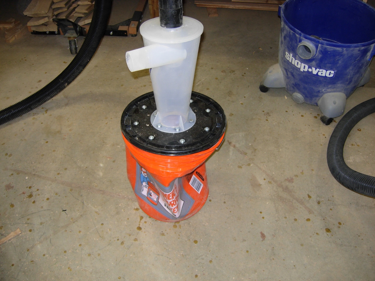

    Has anyone found the need to earth their dust extraction? I was wondering if an aluminium version of the cyclone gadget would create a means of discharging static.

    I’ve not had an issue with my machine / drivers and static (running arduino and separate Dq542ma drivers on the Sphinx) With the dust extractor.
    I used to get issues when running the xpro v3 controller caused by the same extractor so can only put it down to the controller.
    Worst case scenario you can always earth the hose as that is where the static build up will be as it’s plastic

    I have not had an issue either and I have not intentionally earthed mine. But, now you have me thinking I unintentionally have earthed the hose. It hangs from a metal strap that suspends the chassis of my garage door opener from my garage ceiling. The metal strap is screwed to the metal chassis which I know is grounded. Prior to this, when it was just hooked to the vacuum and not suspended from that strap, I remember the hose being very "static-ie." Now it is not.

    Evening All. Last weekend I have installed a more robust dust collection in my garage. I have a dust deputy which was attached to a plastic barrel, the issue I had is my shop vac is quite powerful and when the hose was jammed the barrel collapsed.
    I have just purchased last week a small meal oil drum fro "Big Doug" (UK suppliers of all things storage). This ended up being the perfect solution. I have installed 60mm tubing across the roof and have a couple of valve gates.
    Notes for the technically interested people: You ideally need to keep the tubing as large as possible and only reduce at the last possible moment, keep the bends shallow, no 90 degree bends. HOWEVER!!!! unless you have a massive workshop/man cave you don't need to worry too much, I installed mine following all this guidance and found I had so much suction I needn't have worried.
    Earthing - I'm not sure, there are many kits that don't include it.
