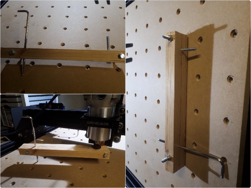

    OK Guys now that I have (eventually) got my machine moving and surfacing the Spoilerboard. There may be some little lines or ridges in the new surface, now they are hardly noticeable and when you rub the surface they are very very minimal, to say the least, but they are there visually. So I'm thinking that the spindle in the "Z" axis mount is ever so slightly off. (I mean slightly). That said, I have made this crude wooden contraption (from plans on the web) to help me try and maybe correct that...
    I'm loathed to do this as its not altogether too bad..should I leave alone for now or try for a little more perfection. Also, the perpendicular alignment device that I have made would, in my opinion, be better suited to being fabricated from something more rigid such as aluminum rather than wood...Any thoughts or advice on this people?
    Regards
    C

  25. Alex Chambers
    2,834
    1,391
    Hi @Colin Mccourt, it really depends on what you want to do with your machine. If, for example, the tramlines you are getting are 0.1mm high, then the router is off vertical by a fraction under 1 degree. I rather doubt that your wooden device will help you get any better than that. I also doubt, for most woodwork projects if you would be aware of that level of error.
    If your tramlines are 0.1mm or less with your 25.4mm tool then think how small they will be with a 3mm bit. 1 degree, or less, error on the side of a part is also likely to be insignificant.
    I would leave well alone until you find it's a problem - ie when you are trying to do some precision engineering.
    Colin Mccourt likes this.
  26. GeoffH
    GeoffH Journeyman
    Mar 11, 2017
    178
    107
    Agree with Alex regarding lines, more than good enough for wood working with typically 6.35mm and less size cutters. I'm always concerned when tool changing, tightening / undoing the collet to feel lateral movement of the z axis; but in practice, not a problem.
    Many of my programs for machining 3d surfaces can run for 6 hours and more, and I would be loathe to trust wifi, an ethernet connection to an old laptop is my method and the laptop connected to my house network with HomePlug PowerLine Adaptors. I am very old school, so I make sure that all data is local and I use the graphic verification of the toolpath in UGS before starting, lifes too short :)

  27. Alex Chambers
    2,834
    1,391
    There are some jobs I would like to be able to work more accurately on and I would try to set the router up more accurately using a dial gauge. Fix the gauge to the spoiler board so that the plunger rests against the shaft of a bit in the collet (or better a length of ground rod) jog the Z axis up and down - the dial gauge will show the deviation from vertical. But then there is the problem of accurately adjusting the router mount and fixing it to the Z axis extrusion. When/if I try this I am going to see if I can modify the Z axis extrusion to allow a screw adjustment on each side.

  30. Colin Mccourt
    Colin Mccourt Journeyman
    Jan 23, 2019
    354
    185
    Thanks, guys :thumbsup:
    I know what you mean..they are insignificant really and another couple of passes later due to this crap MDF I have got a level playing field. Well more of a pocket than a surfacing lol..That was me referencing the cutter down tight on the paper by a smidgeon and causing more plunge than necessary 1.5 rather than 1mm...silly newbie mistake caused more by this stupid keypad on the laptop than anything else...Gawd I hate keypads with a vengeance. The job is now complete to a fashion and I can go about trying to machine something. That, however, will have to wait until, probably Thursday as I'm working in London from tomorrow. :mad:...It's going and that's the main thing...Don't hold your breath. and call me lucky if you want to but I was able to fire up the laptop and connect to the Duet straightaway this morning???? all I can think of is I set up another channel and went through all the installation process from scratch yesterday, right back to the start...I must have missed something or its just a fluke or it will bomb out at any minute, well whatever it's working and hopefully, it will stay like that.:rolleyes:
