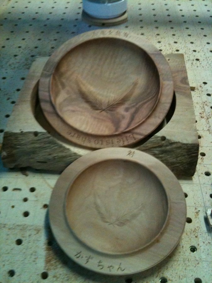

    Today my Buffalo honored its name! 14 hours non stop 3D work, didn't mis a step! I'm impressed, also about the Makita router that keeps running all the time not giving trouble and even the cheap vacuum cleaner runs without showing fatigue.
    But…..I have to find ways to make these runs shorter in time. Anybody advice about decreasing cutting/engraving time? I'm using Aspire, Planet CNC controller.
    The finishing part of today was estimated by Aspire at 6.5 hours with a time scale of 2.5. Real work took about 12 hours (the finishing run, with 1/8" ball nose, 10% step over, feed speed of 4000mm/min). The roughing goes fast enough.

    G540 and Mach3 solved the problem. Back again at a short but steep learning curve (Mach3 and its typical things) but prospects look promising with this combo.

    The Buffalo at work.....

  10. dean knipping
    Mar 24, 2015
    84
    16
    very nice....what was the cut time on that?
  11. Paruk
    Paruk Journeyman
    Jul 13, 2014
    397
    149
    Final result.....
