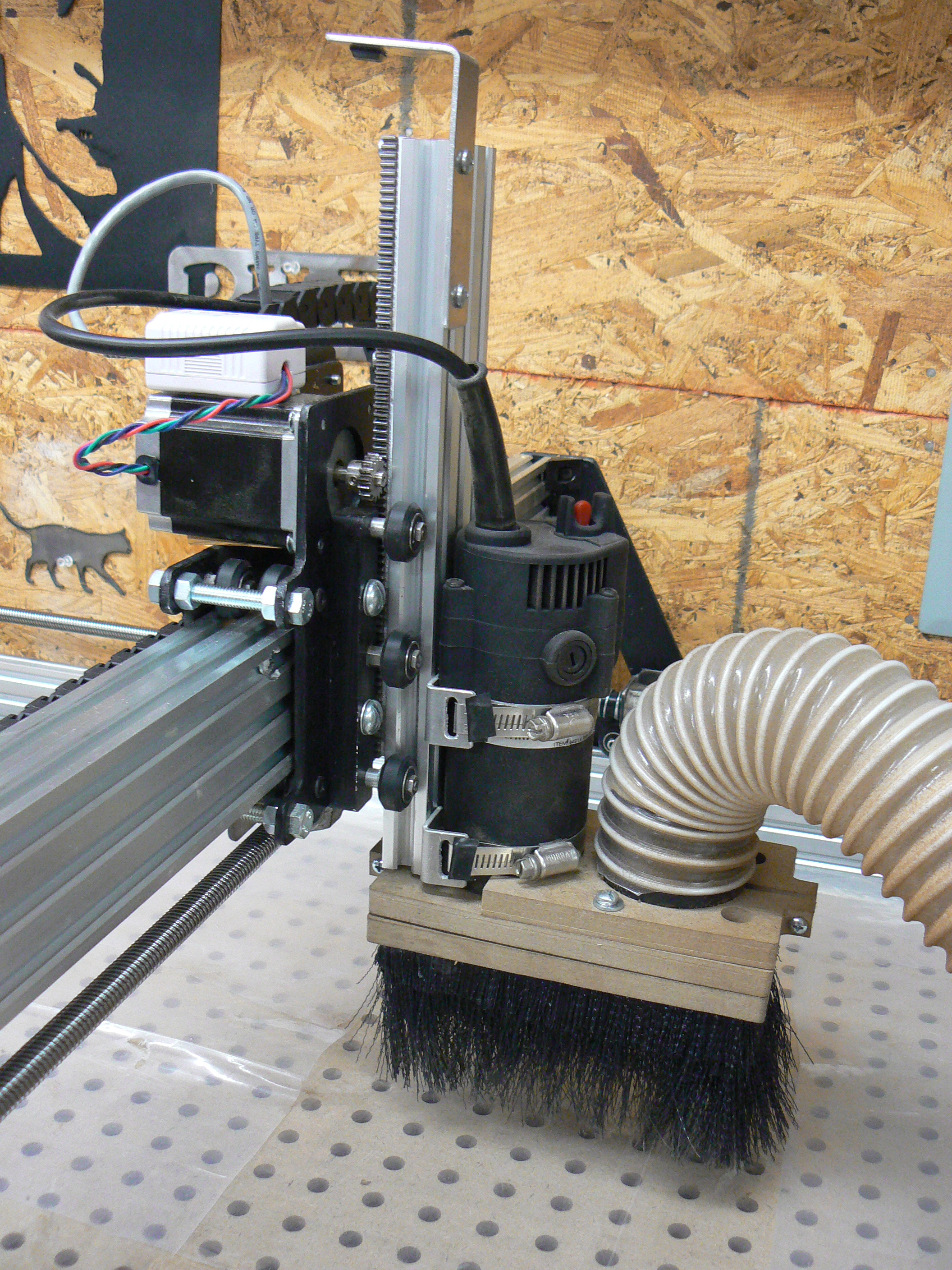

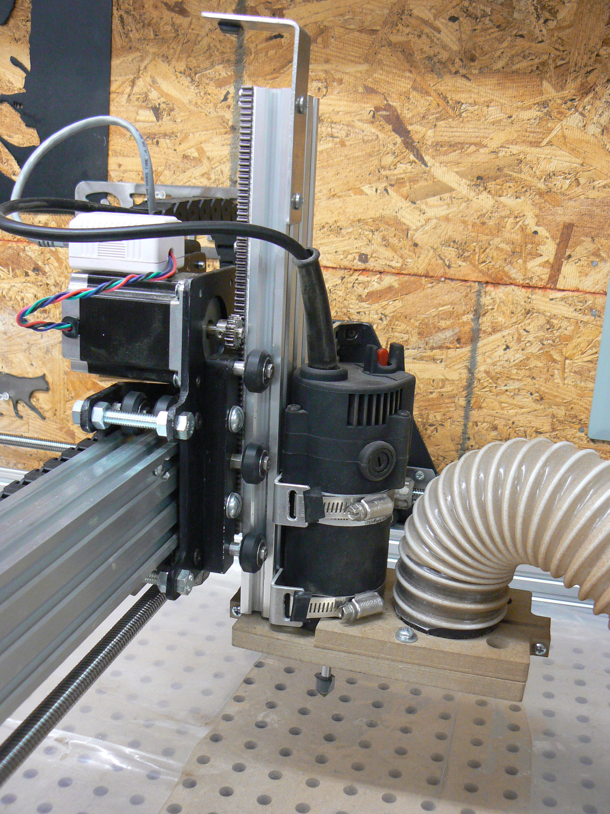

    Here's some photos of the leadscrew refit. It also updates various other aspects, such as the dust boot, vacuum table, cable runs and etc. The Z-axis is still rack and pinion, works fine. The last two photos show it with and without the dust boot. BTW the vacuum table works great as long as I block any un-used holes with plastic sheeting. All of the brackets are .1" thick steel, quite stiff enough for the job.

    Hi Justin and thanks. I used 8-wire ethernet cable (24awg), with four pairs of two wires each doubled for increased current capacity. Never had a problem running about 3a max step motors, but of course the average current per motor is much less.
    #122 Neil Rosenberg, Dec 14, 2014
  3. Neil Rosenberg
    Neil Rosenberg Journeyman
    Dec 29, 2013
    182
    180
    Not sure which parts are "wiggly", but I used standard modular RJ45 connectors which are gold plated and have spring loaded contacts. I've found them to be pretty vibration and tug tolerant, same as that used with Ethernet and phone jacks.
    My biggest concern was current capacity, but even after extended cutting my wires are still cold to the touch, unlike the motors.
    I did not invent this, it's what the (now defunct) maker used on my plasma cnc table. Works well there too, even with all of the sparks flying! (BTW he's defunct for other reasons.)

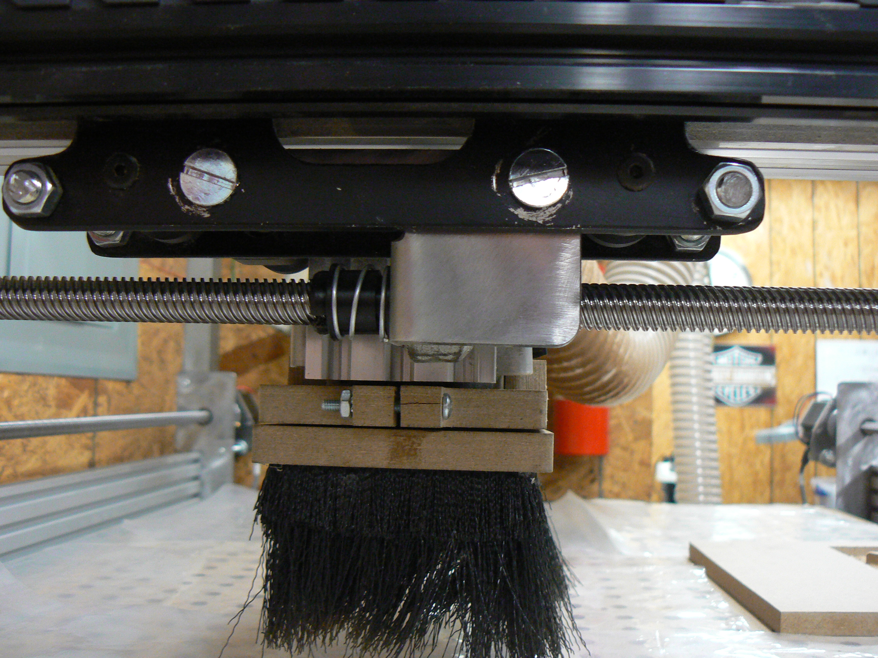

    Starting the next aspect of this project, converting the z-axis to leadscrew as well. Will post photos soon as the project progresses. I'm also adding a carriage stiffener that does double-duty: reduces whatever racking the two-plate carriage exhibits, plus provides vertical support for the z-axis motor.
    You'll see it all in the photos, but here's a couple screen shots of the Solidworks model:

    Z-Axis now leadscrew, please see YouTube video at:

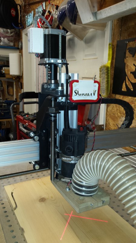

    Thanks Tweakie! Here's a photo of the "new" z-axis, now with a laser crosshair:
    Notice my very high tech Altoids can for the LED batteries and on/off switch :duh:
    OK I'm cheap.

    Nice idea !! I like the crosshairs, bet it helps alot setting 0,0...

    Thanks. It was a pretty easy update, good for basic alignment of the workpiece. Came in handy immediately. Lines are a bit wide but good for $6 emitters, particularly since my goal was to get within 1/8 inch or so.

    No problem, and good question. There are two single-line emitters mounted at approximately 90 degrees separation around the spindle center. The most important aspect is that the leds are mounted in holes that are parallel to the motion of the z-axis so the intersection won't wander as you move up/down in the z-direction. After mounting, you rotate each led so they intersect as nearly as possible where the spindle center is located. It's easier than it sounds.

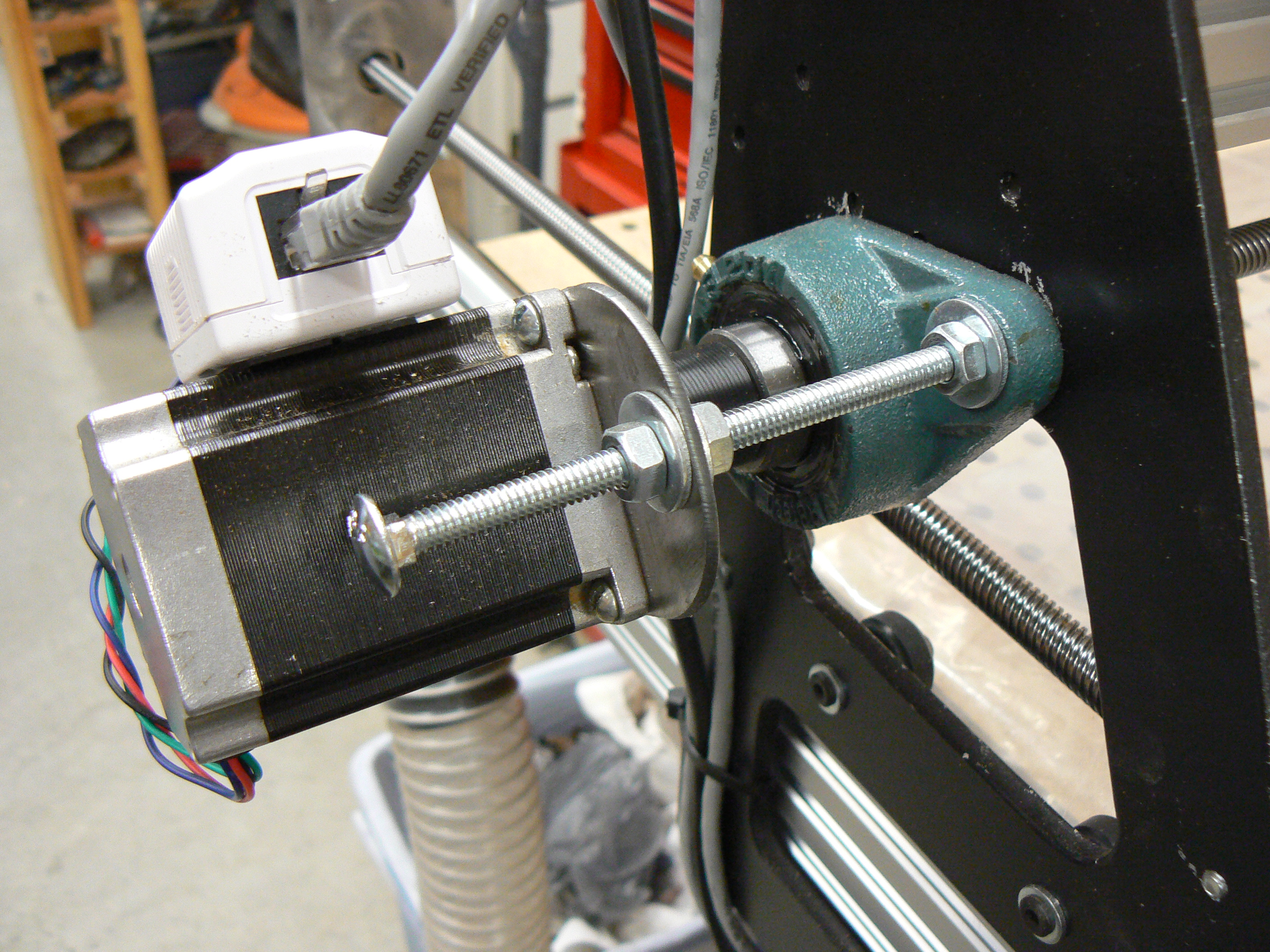

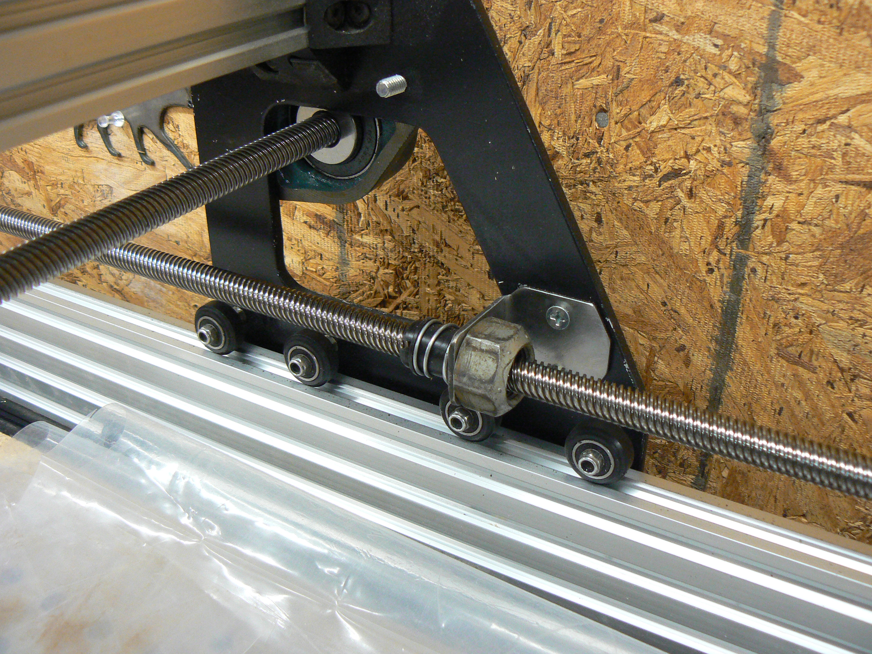

  15. sgspenceley
    sgspenceley Veteran
    May 27, 2014
    249
    294
    Hi Neil, I'm thinking about doing leadscrew mod similar, my machine will never be a long Y bed, so I think your approach is worth more investigation.
    The bearings on the end of the Y axis, as the screw turns what prevents the axial movement. I had always "assumed" end bearings would take the axial load not just the rotation. Did you just add a collar which is tightened down on the leadscrew to take the load like the openbuilds Z axis?
    I was thinking about mounting the lead screw much lower down. Any specific reason why yours is mounted high?

    I saw Sgspencely's questions about my leadscrew retrofit.
    Yes, I do have lock collars in strategic locations on the leadscrews to prohibit axial motion, using the sides of the bearings as the limits. I can post pictures if requested.
    Since I capture chips and dust with the dust boot it has not been a problem to have the leadscrews up high and exposed, and doing so made it much easier to add to my design. It also puts the drive points closer to the center of mass, thus reducing the moment arms.

    I've been using the anti-backlash nuts from Dumpstercnc with very good results.
    For motor adapters however, I strongly prefer the flexible couplers -- search on Ebay or Amazon. The ones I am using have a 1/4" bore on one side and 1/2" on the other. They have a slight rotational springiness, I suppose it could introduce *very* small errors on harsh cuts, but they go a long way in protecting the motor bearings and smoothing out any misalignment.
