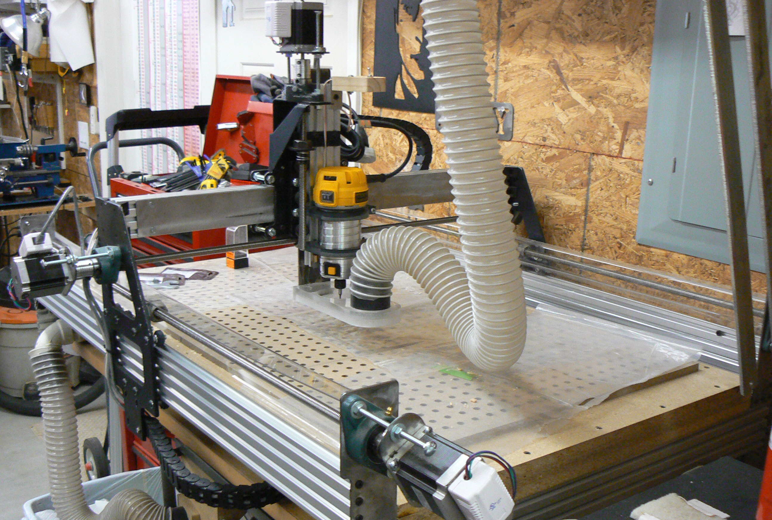

  29. Neil Rosenberg
    Neil Rosenberg Journeyman
    Dec 29, 2013
    182
    180
    Build is done for now, here's a snap:

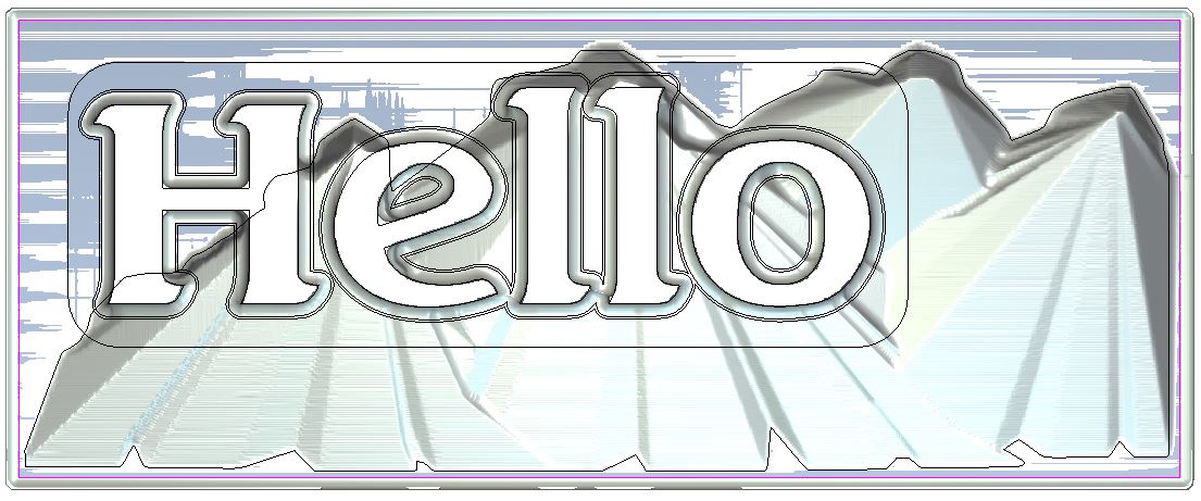

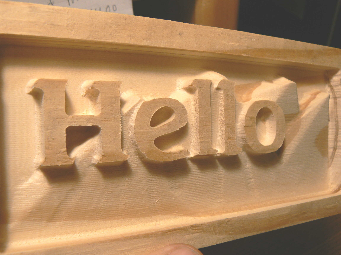

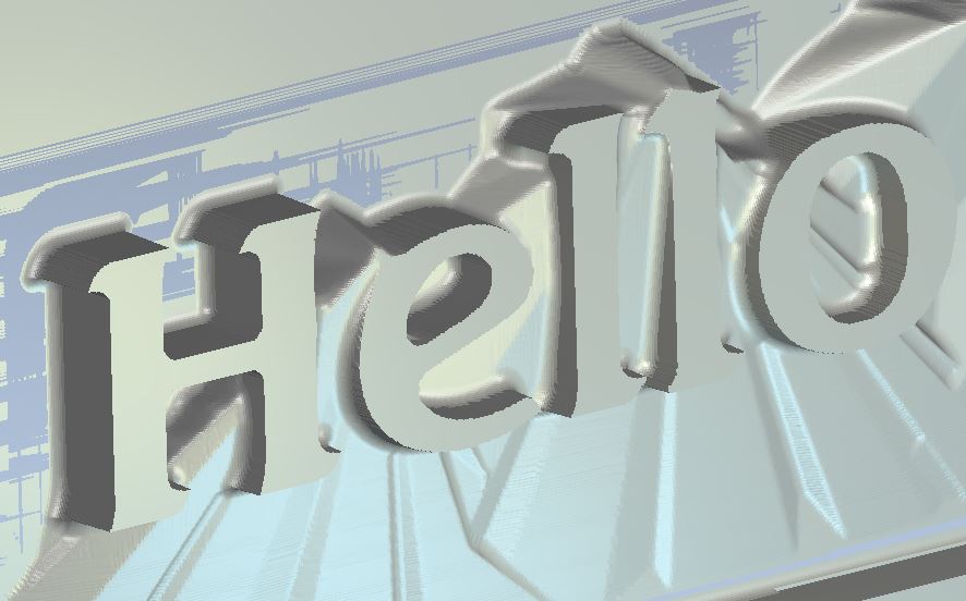

    Here's a few photos of ArtCAM Express, and the resultant test part. I'm playing around with raised lettering above a relief:
