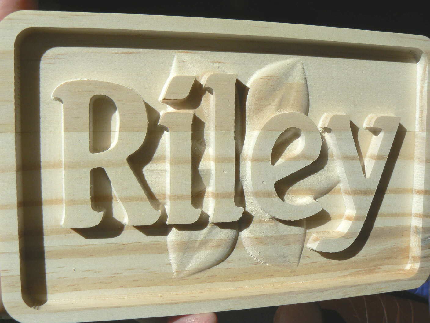

  8. Neil Rosenberg
    Neil Rosenberg Journeyman
    Dec 29, 2013
    182
    182
    Thanks Mark, havin' more fun than should be legal :p
    Here's a snap of the latest cut, finally smoothing out the bumps...
    This is the cover for my grand-daughter's "treasure box", measures about 8x5 inches.
    Neil

  10. Neil Rosenberg
    Dec 29, 2013
    182
    182
    Thanks Gerald and Justin.
    This is a relief cut, there's a 3d flower behind the text. The only way the stock ArtCAM Express product can do this kind of cut is raster. Delcam (makers of ArtCAM) does have a "Feature Machining" module that you can add to Express that is the best of both worlds (relief in both raster and offset modes) but I'm too cheap to spend the $250 for it, particularly now that I have this workaround.
    I totally agree with your comment -- if I wasn't doing a relief cut, area clear would be way better and quicker, and yes I'd probably use offset as you suggest, and that is included in Express. FYI, in Express even if you do an area clear in raster mode, it always finishes up with a full peripheral cut, so it's still quite clean.
    Justin -- This is cut with 1/8" end mill (roughing) then 1/8" ball with a .008" stepover. The whole thing took just shy of 1 hour.
    Neil
    #220 Neil Rosenberg, Feb 15, 2015
    JustinTime likes this.
  11. Hytech2k
    Hytech2k Veteran
    May 6, 2014
    429
    332
    Oh I see, Aspire handles it a bit differently where the text and relief image become one component, I would rough it out with a .25 ballnose and finish cut it with either a 1/16 or 1/8 tapered ballnose bit... Looks great anyway though !! 1 hour isn't bad at all. The Harley signs I do run .5 hour for roughing and 3 for finish, but no sanding required, just touch up some areas, stain and poly....
    Keep it up Neil, looks great !!
