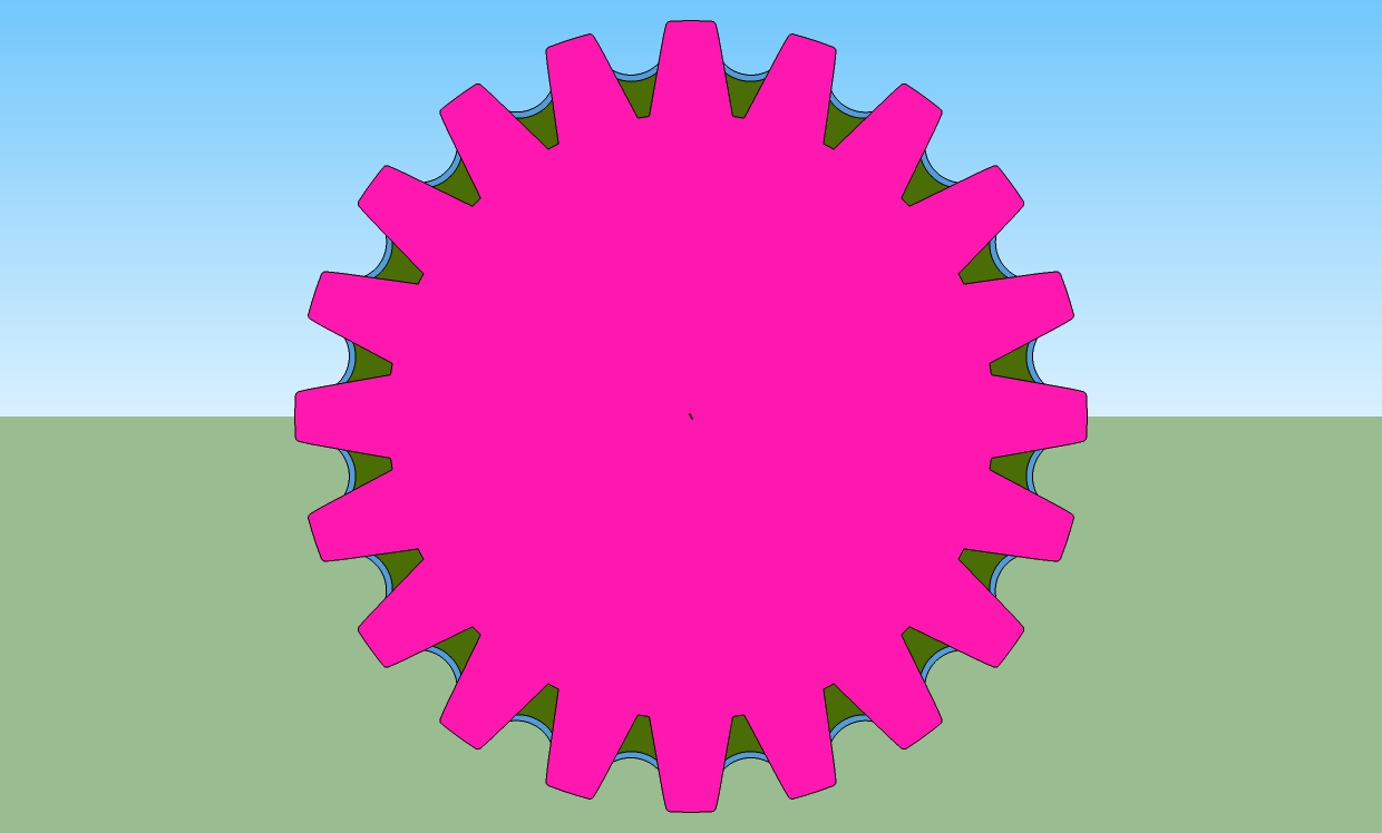

    Thank you for your reply. Currently I am designing a 3:1 ratio speed reduction gearbox and found my desired pulleys at two reputable manufacturers.
    SDP/SI carries Product | Designatronics Store | Stock Drive Products/Sterling Instrument and Product | Designatronics Store | Stock Drive Products/Sterling Instrument.
    These are desirable because they use the Fairloc Hub. However, they are listed as "3 mm (GT2)". If you look at it's profile (Pink) in the image below, it is obviously the wrong choice.
    B&B Manufacturing carries 60-3P09-6A4 - A 6A53-060NF0910 3MR-60S-09 78436078 TP3A3H9-60 | B&B Manufacturing and 20-3P09-6FA3 - A 6A53-020DF0908 3MR-20S-09 78436005 TP3A3W9-20 | B&B Manufacturing. These pulleys are listed as "GT 3mm" and are very similar in profile to the openbuilds pulley.
    Openbuilds only carries the twenty tooth pulley and even there it's called "3GT (GT2-3M)".
    3GT (GT2-3M) Timing Pulley - 20 Tooth - .250" Bore - 9mm Belt
    I have downloaded the cad files and compared the 20 tooth profiles. The first image includes all three profiles layered from smallest to largest.
    Pink: SDP/SI A6D53-020DF0908 (3 mm GT2)
    Green: B&B Manufacturing 20-3P09-6FA3 (GT 3mm)
    Blue: Openbuilds (3GT (GT2-3M)) Timing Pulley - 20 Tooth - .250" Bore - 9mm Belt
    (The Pink profile is obviously way different and most likely not a 3GT profile.)

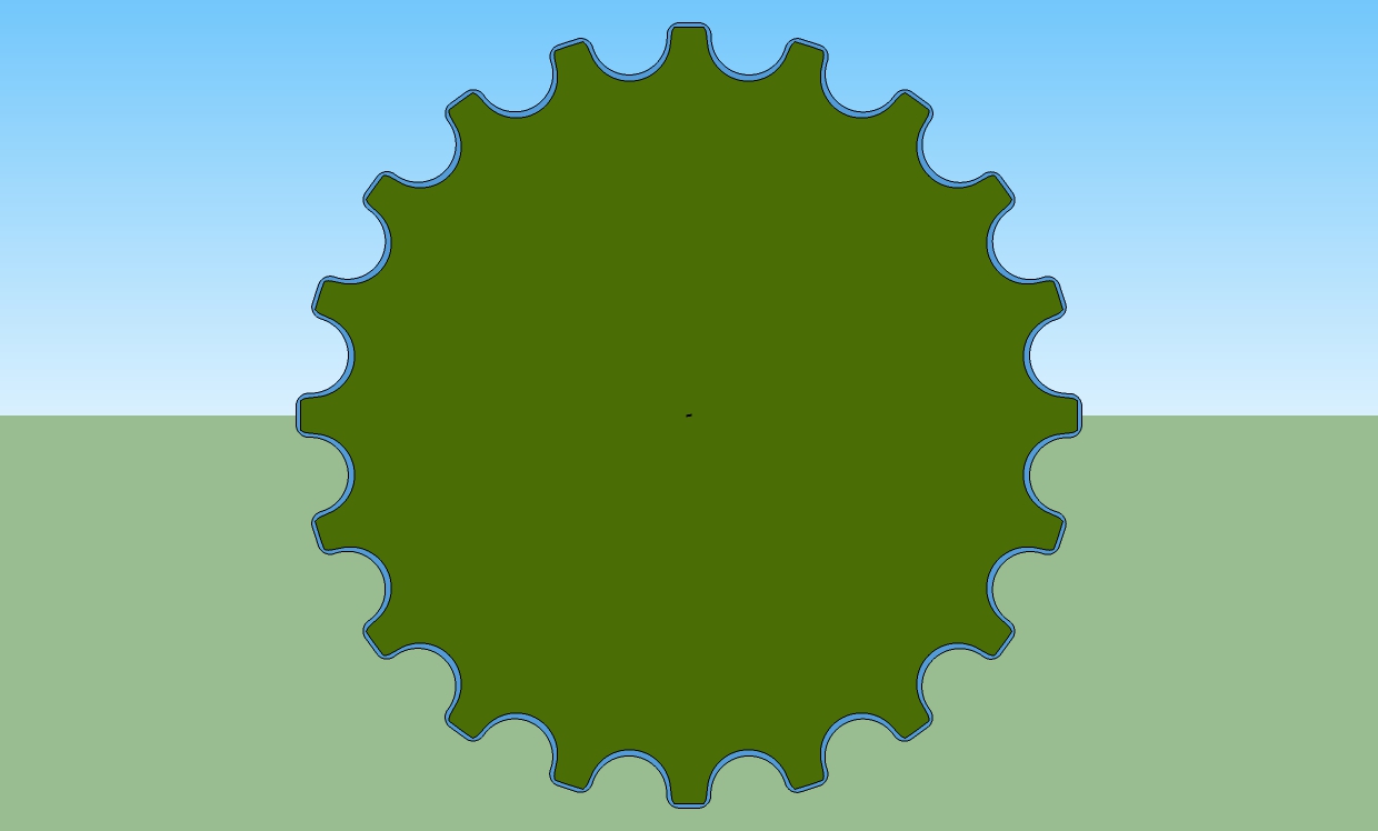

    In the second image I have removed the Pink profile to compare Openbuilds to B&B. They are very similar although it appears the pitch diameter differs slightly.
    What are your thoughts? I don't think there will be an issue by using the B&B pulley as they are so close.
    There is only 0.009791" difference in the pitch diameter and the tooth radius is exactly the same. I'd buy both pulleys from openbuilds if they were available.

    You are grossly over analyzing this. Anything from SDP/SI or B&B will be dead on perfect (even if their publicly available cad representations are not). They are both high end ISO certified facilities.
