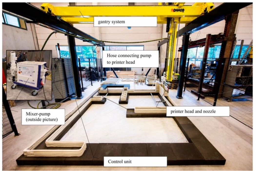

Something like this I know the cement mortar mix design, I also know 3d modeling in CAD software’s. Can you suggest me frown where I can buy parts of contact company in Europe. Which company makes these parts? I want to make this.
The steel columns and beams in your picture can be purchased from any steel fabricator there is nothing special about them. The same is true of the concrete pump/mixer - any concrete supplier would have some or know where to buy one. The control unit and motors (possibly hydraulics on the Z axis but I can't tell from your picture) as @ljvb said probably came off a small gantry crane system. I suspect the problem is the printer head and nozzle will be proprietary and you will have to design and manufacture it yourself. The picture that @joe williams posted with the central crane system is clever as you don't need the large beams for your x and y axis and the associated setup time and you could just use a another crane to install and remove it from the centre of the house when it has finished printing. When you come up with a detailed design I would love to see it. Cheers Adam
I suspect that the majority of a system like this will be custom built...you'll have to spend some time on google to figure out what can be made from off the shelf parts and what will need to be fabricated by you. Have you tried to find an existing system that you can travel to and ask the builder these questions?
Googled These are Gantry for packing solutions. I have to find more info. May be I contact these companies. Rohaco.com
Out of interest what is the concrete specification? It looks really stiff/fluffy in the photo you posted. Cheers Adam
